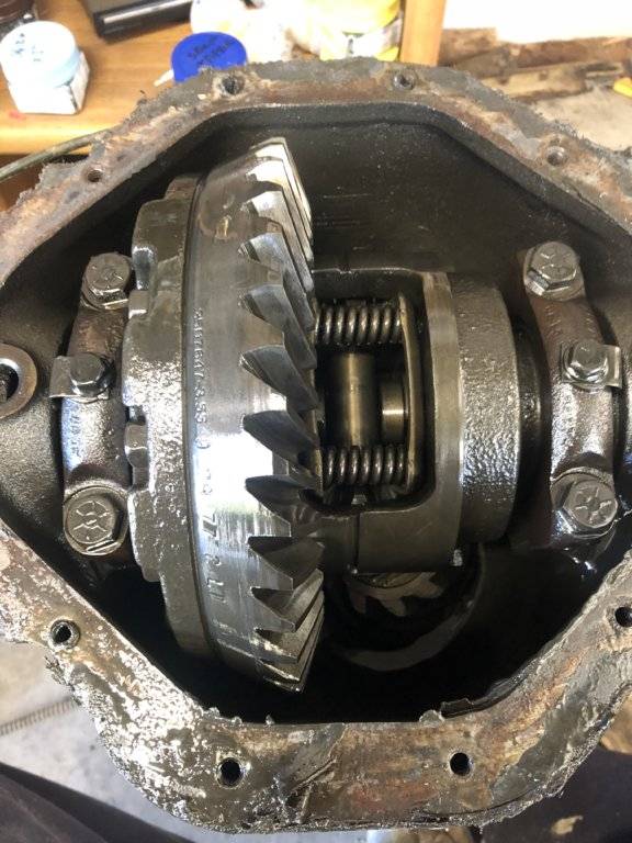

Just as I remembered, 3.55 Sure Grip.
In my opinion folks, that’s just a little to low for interstate speeds. Been there, done that. A lot. 3.21 is...tolerable.
Want even worse? Go 3.73,,been there too. 3.91 and numerically up? Unbearable at interstate speeds! But what a take off!
