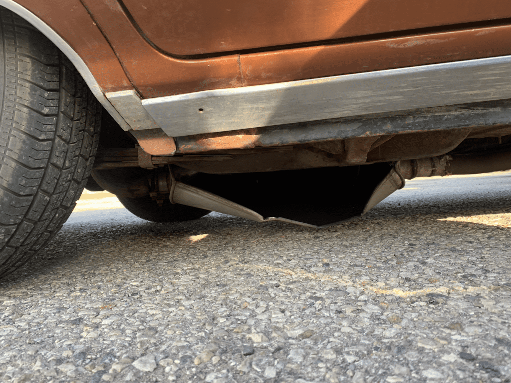

Well, the new carb and intake have been put on pause. The muffler blew up during a hot-start last week, a friend actually heard the explosion from a kilometre away. Now I've got the car booked into an exhaust shop, I'm taking this chance to upgrade to dual 3" mandrel bent stainless. It's certainly not cheap, but it should be the last time it needs exhaust work of any sort.
Right now I'm driving around with it essential straight-piped, it sounds good, but is much louder than I'd like it to be. With the horns, the car's become maybe the most ostentatious thing on the road. That combo has, however, garnered some attention at the Import-focused car meets I attend.
One thing I noticed, without the muffler, the car starts up easier, oftentimes faster than a modern car. It's odd that a muffler would create enough back pressure to affect startup, but the current system is very restrictive.
Regardless, I'm excited to see how much the new exhaust changes things. The current exhaust is what I'm least proud of on the car, so it'll be nice to get rid of it

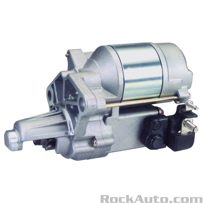

I need some help with mini-starters.
The original starter doesn't crank fast enough to start the car in colder weather, so I've decided to upgrade. I bought a new mini-starter from RockAuto, but it didn't fit and ended up breaking while I was torquing t down.
The Problems:
-The top mounting hole on the starter I got waste big for the bolt, meaning the starter had some amount of rotation
-The starter never seemed to sit flush in the hole
-The factory 'shim' fell off and I can't figure out how to put it back on, it hits the block and doesn't allow both holes to align
-The starter would extend and spin, but would not engage with the flywheel
Does anybody have experience with these things?
Attached is the starter I usedView attachment 649834
I am having the same issue with my mini starter. What was your solution? I'm going to the original rebuilt because I know it fits.
