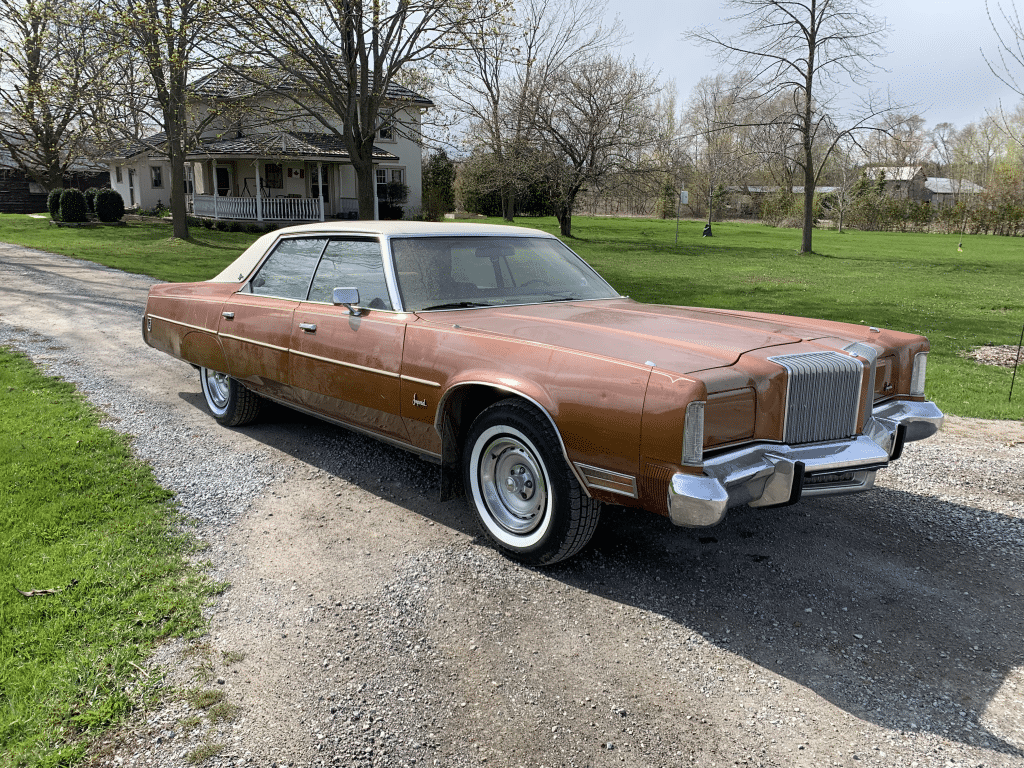

School's done for the year so now I've had time to work on the Imperial. So far it's gotten the new ball joint in, brakes finished, new wheels/tires put on, and I gave the passenger side a vent window while replacing the power window gear. Of course, more things have popped up that need to be addressed. I still have to fix another window gear and install the wiper linkage bushings, but now I've got to get the exhaust clearance, tighten the parking brake cable, give it a tune as it's running richer than John D. Rockefeller, repair the subframe, patch the bottom of the driver's side quarter panel, and look into a non-functional voltage regulator.

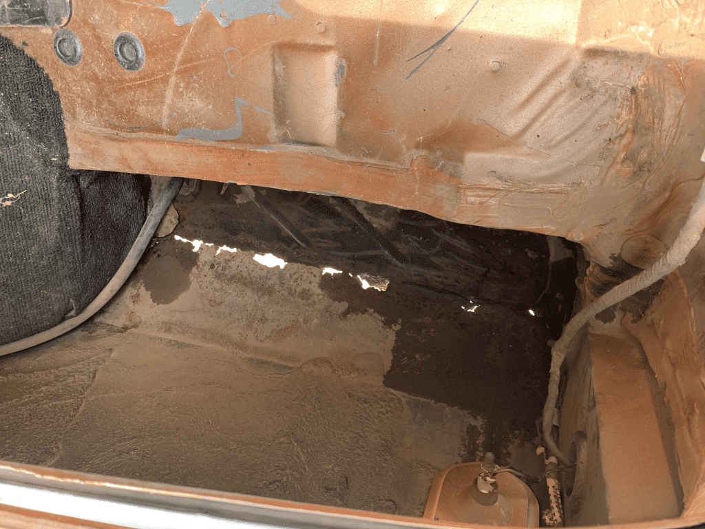

The sentence "repair the subframe" might cause all sorts of concern, fortunately, it's not too bad. The jack stands I have, although they are 3 tonne, don't have a wide enough mouth on top for the front subframe to sit in them, so I've been putting the car on top of them. I guess the bottom of the driver's side rail got a little soft and didn't like supporting 5,500lbs of car because it bent a bit and the seam weld started cracking a bit. Thankfully for me, I have some sheet metal laying around that'll work very well for this and the section I need seems really easy to cut out.

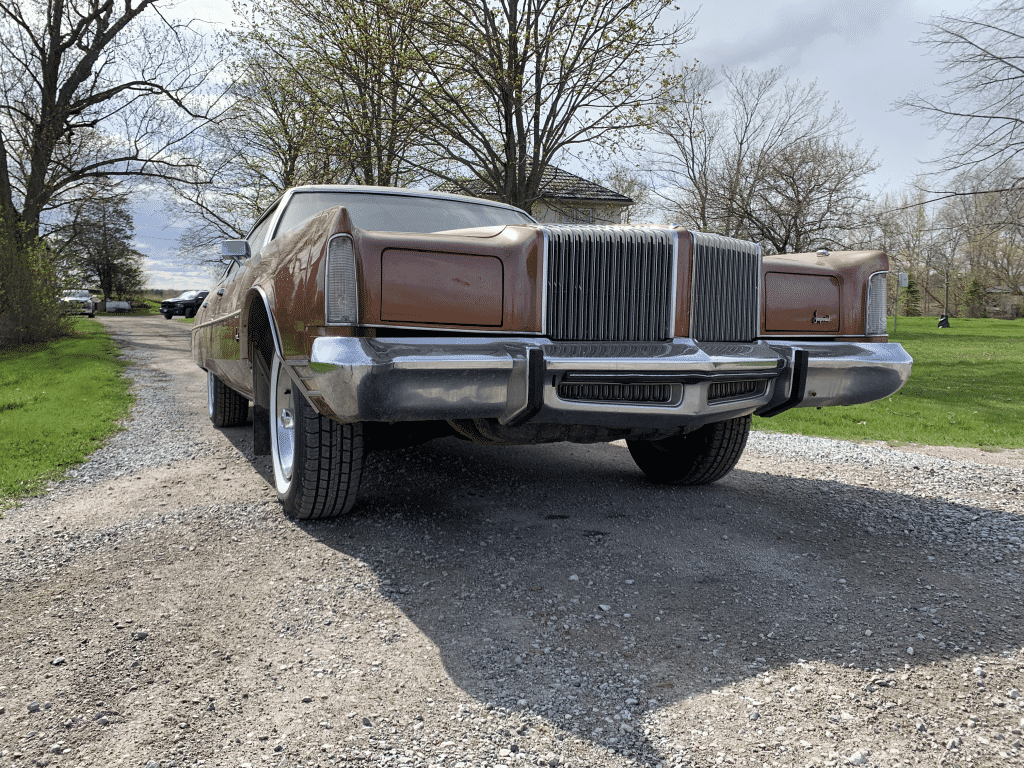

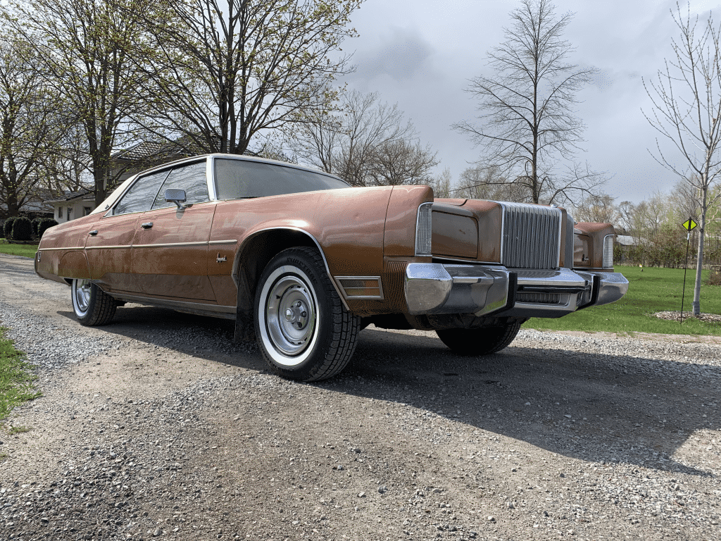

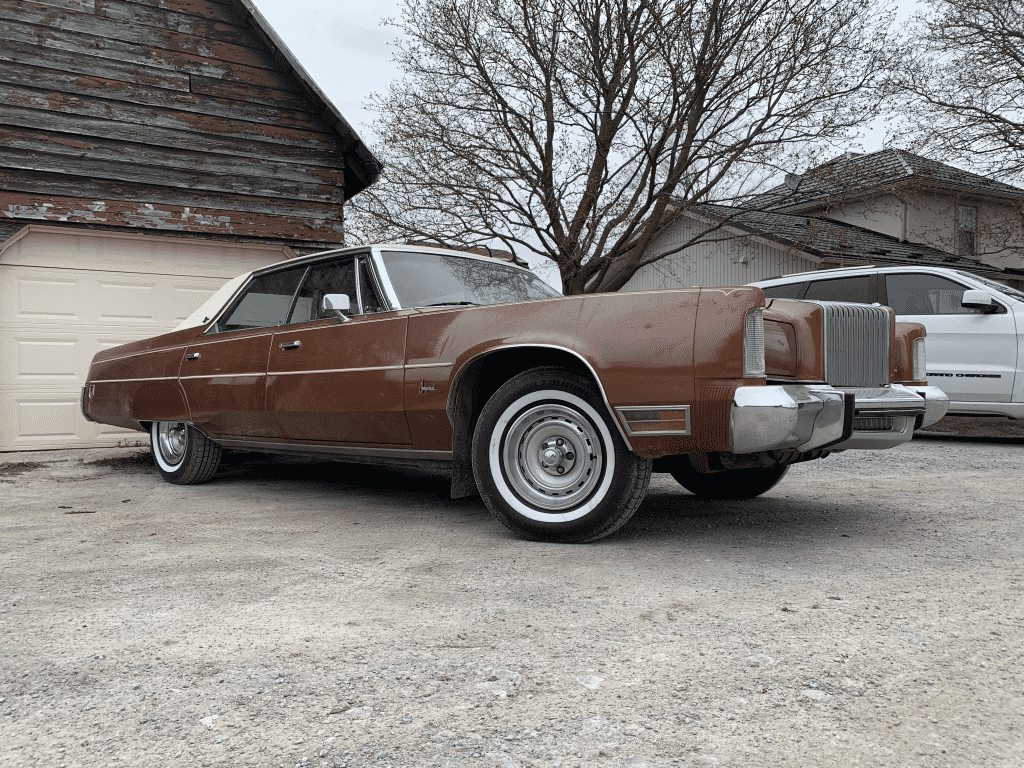

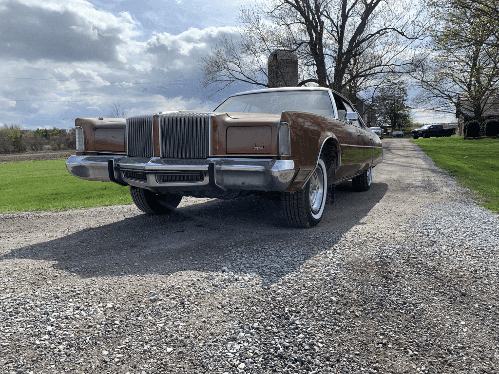

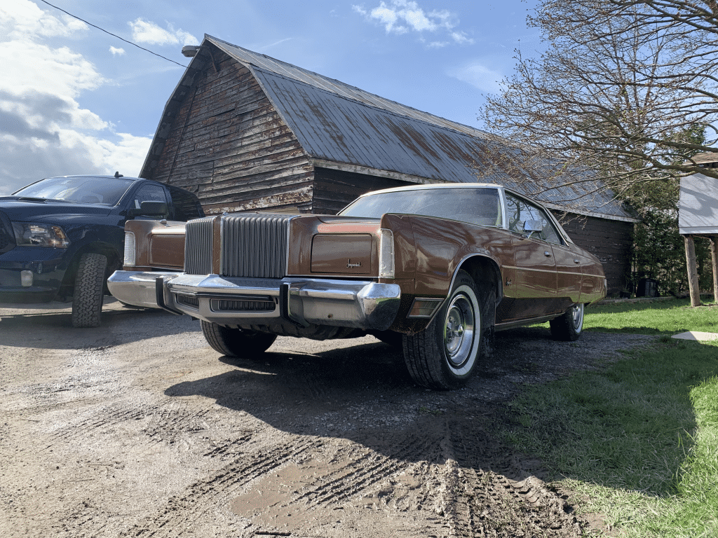

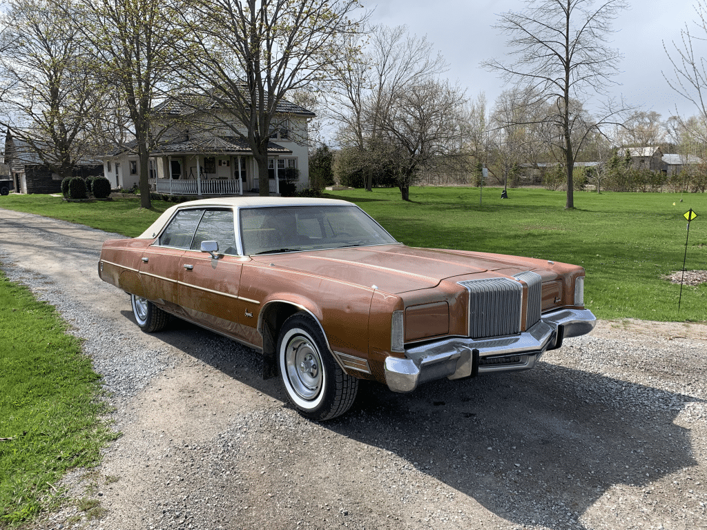

looks great with the road wheels and wider white walls ( which became available as an option in 78)
Thank you! That's what I was going for (plus these tires were slightly more affordable than my thinner white wall option). '78's actually my favourite year style-wise for the waterfall grill cars (with the exception of the non-halo vinyl top)

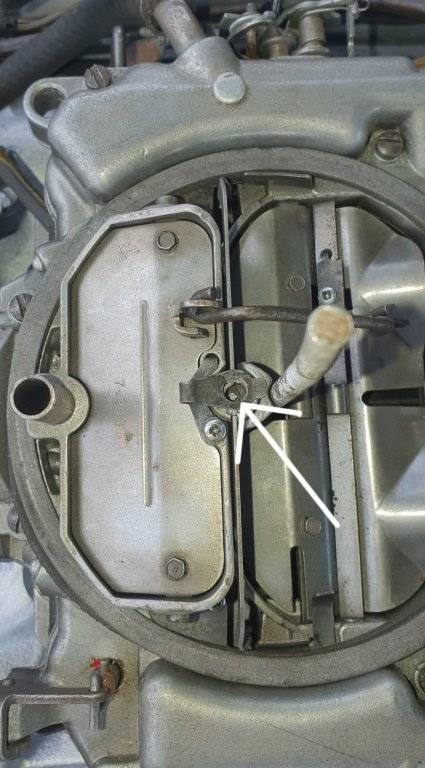

In the past couple of days, I've made even more progress. All the power windows work as well as the wipers. I've also given the engine a basic tune up and cleaned the spark plugs, it's running better now but still has the lean pops when immediately pressing the pedal more than halfway (right before the secondaries kick in), if anyone could provide some insight into fixing this that'd be great.
Does it have the stock thermoquad? I've had the same issues on my 75 Imperial. Raising the metering rods a bunch fixed that for me. Small flat blade screwdriver in the center of the TQ, clockwise for richer if I'm not mistaken. Adjust half a turn at a time.
Hope this helps.
Hope this helps.
Yes, it is a stock Thermoquad, which I have to deal with until I get the funding for an Edelbrock. Thank you, I'll give this a try
This is what you're looking for. On mine I think I gave it an additional 2 or 3 full turns and that fixed my off idle hesitation. YMMV
