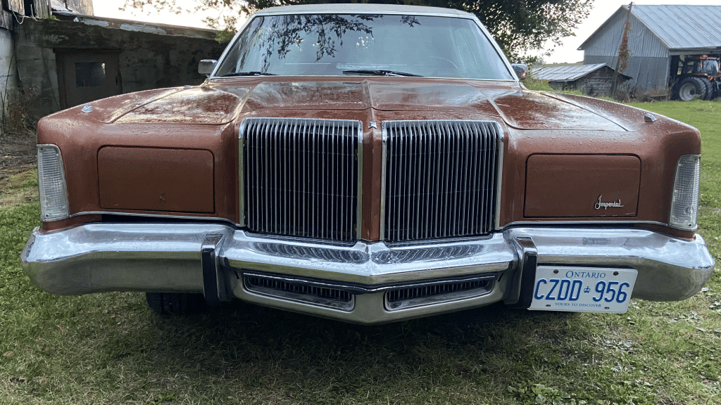

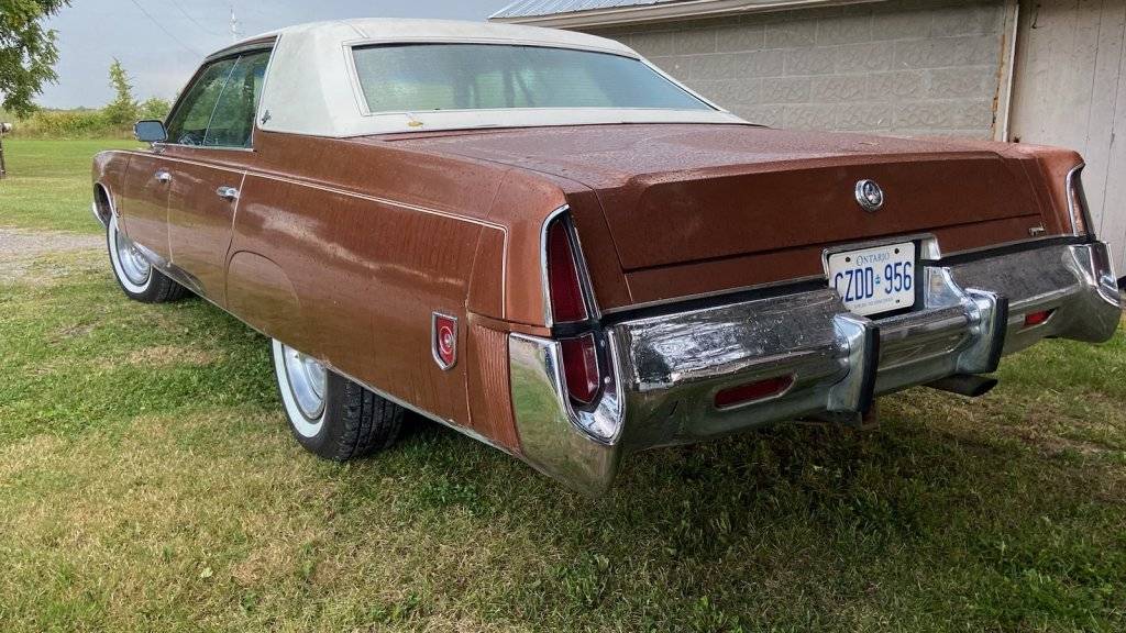

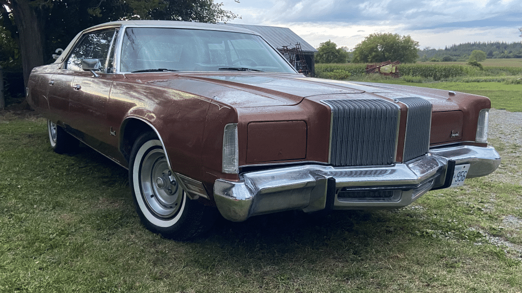

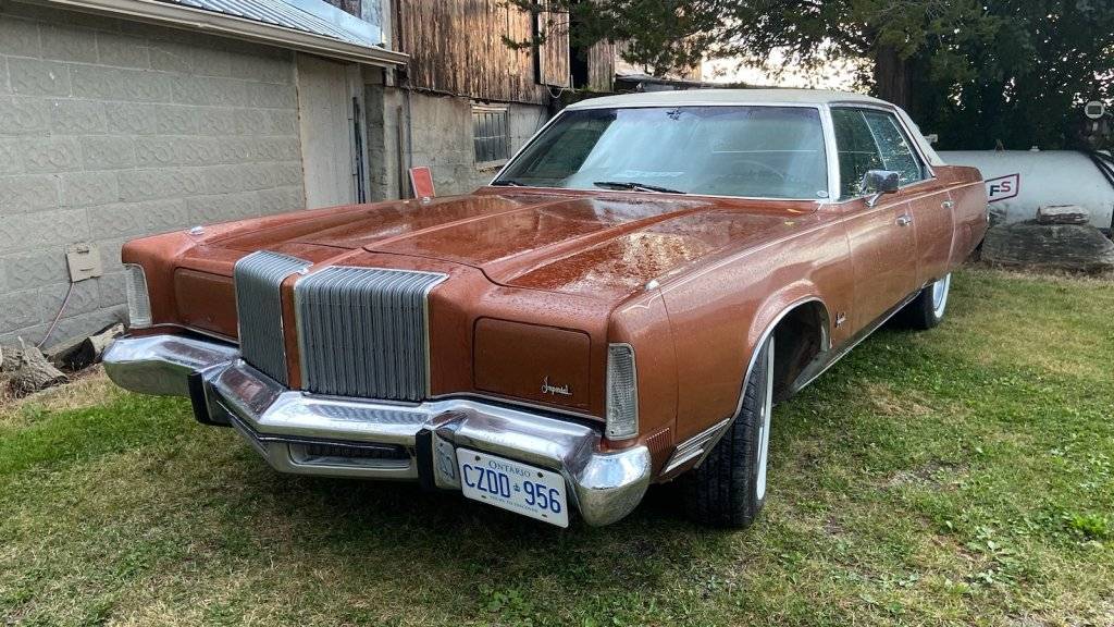

I got my parents to send me a picture of it how it currently sits. Even just from the pictures, I'm very happy with it.

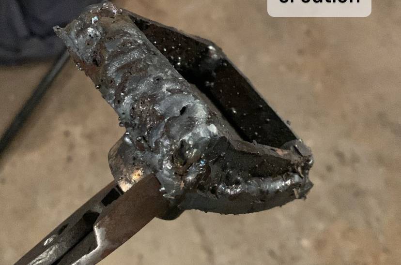

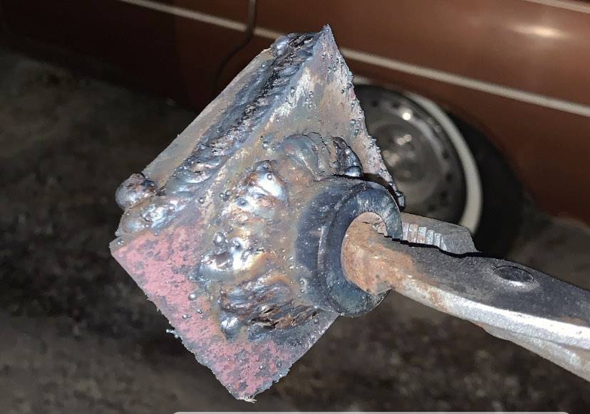

I didn't have the socket to remove it, so I made my own, and it worked like a champ.
that has to one of the best lines that i've read on FCBO. and so nonchalant. again, you would have made a great mechanic. a cutting torch and a welding machine and you're the master of the metal. it's the most basic things and you're the master of your own fate. people just don't get that. no boundaries, no limits.
Thank you, Rags!
I can't say that it's pretty, but I was sure able to stick these pieces of metal together. I decided to sacrifice my 1" socket for this so I'm thankful that it worked out. Welding's one of those skills that anyone who does anything with their hands should learn, it's really nice to just be able to make anything from pieces of scrap. A welder paired with a grinder have saved me a bunch trouble

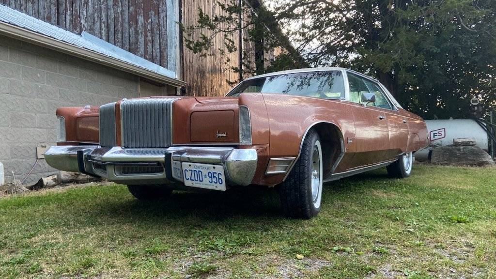

Well, it's finally that day! After a year and a half of ownership, the Imperial is now completely road legal!!! My parents just picked up the new plates today.
Great work! Not enough of these cars get saved. Ntl Moparts should be able to hook you up with a Hood ornament and an Imperial script for the rear.

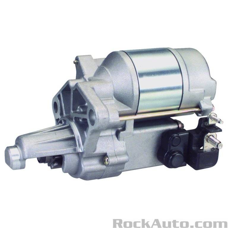

I need some help with mini-starters.
The original starter doesn't crank fast enough to start the car in colder weather, so I've decided to upgrade. I bought a new mini-starter from RockAuto, but it didn't fit and ended up breaking while I was torquing t down.
The Problems:
-The top mounting hole on the starter I got waste big for the bolt, meaning the starter had some amount of rotation
-The starter never seemed to sit flush in the hole
-The factory 'shim' fell off and I can't figure out how to put it back on, it hits the block and doesn't allow both holes to align
-The starter would extend and spin, but would not engage with the flywheel
Does anybody have experience with these things?
