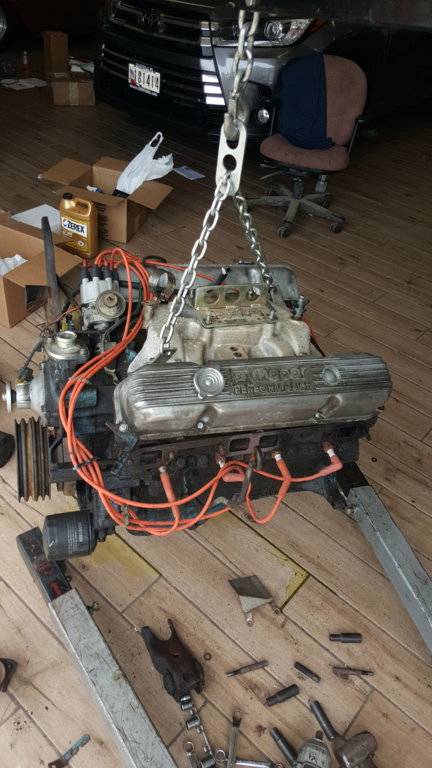

Well, I have a 400 with 64K. Runs very well. Probably needs a timing chain because it may still have the original nylon gears. And of course a couple of gaskets.
First person to show up gets the engine.
$500 with Edelbrock Performer intake and Mopar Performance valve covers.
$300 Minus the intake and valve covers.

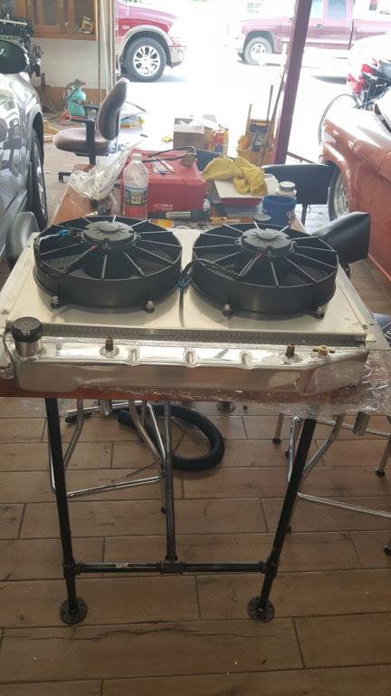

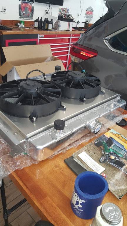

Have to mod the radiator so it will fit. It's about 4 and a half not wide enough.

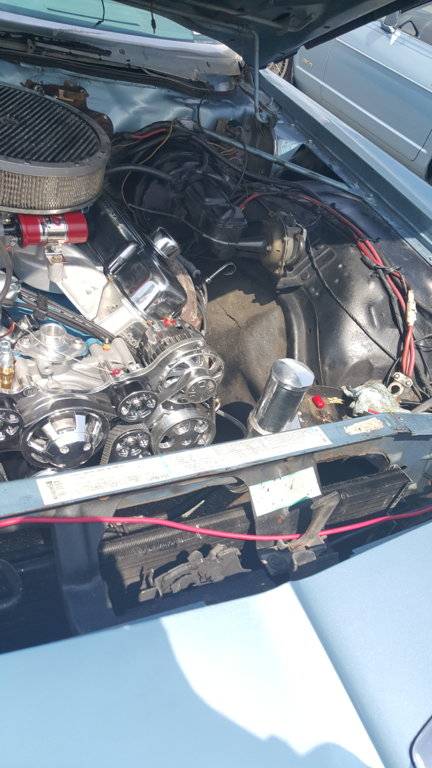

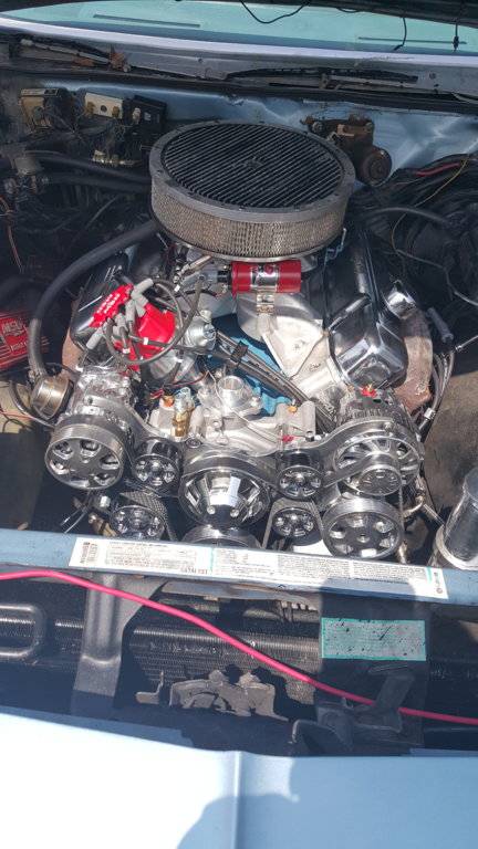

Well fellas, with the rapid pace of the engine swap (with the help of my Army buddies Mike and Eric). I have hit a few roadblocks that will require another weekend before I can fire the new engine. The +100 degree heat index took it's toll on 3 retired Warfighters in their mid 60's too.
It took me all day to find a few critical parts including electrical and AN fuel line fittings.
I still need to find some 3.5" x18" by 3/16" aluminum strips to mod the radiator install. I don't want it to look like a Fiat/Tyrone mod. There just isn't any metal shops open during the weekend.
Here is a picture with the remote power steering reservoir mounted to the side of the battery tray.
I do have a fresh air filter element for it and I'm going to get the top air cleaner lid powder coated.
