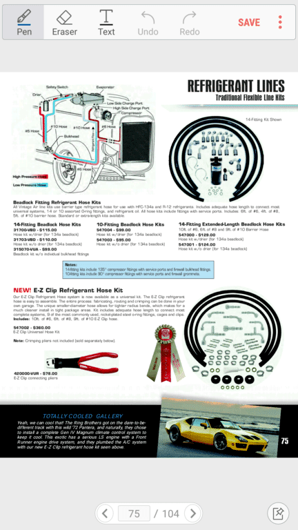

The last big dilemma (that I'm aware of at this point in the fabrication) is converting the A/C hoses. I'm going to call Vintage Air today and hope they can help me with the E-Z clip fittings that I need to convert the hoses and hook everything up to the Sanden SD-7 compressor manifold and to the other components. I also need to add a low side and high side ports for freon.
There's zero reason this can't be done by a local shop, OR... buy the crimpers and the fittings and DIY to insure it's done perfectly.

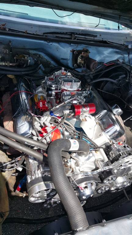

Engine looks great Bob!!

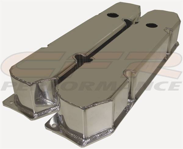

What about something like these for valve covers??
I just ordered the EZ clip universal kit from Vintage Air.

Youch! $360 USD for the universal kit not including the crimpers....but I do like how they put it all together.
Yep, this car is adding up.
A friend has the crimp pliers so that is $78 I don't have to spend.
