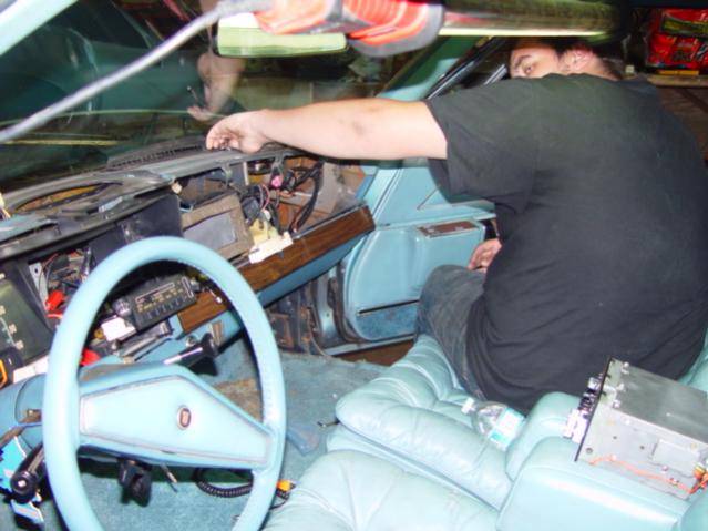

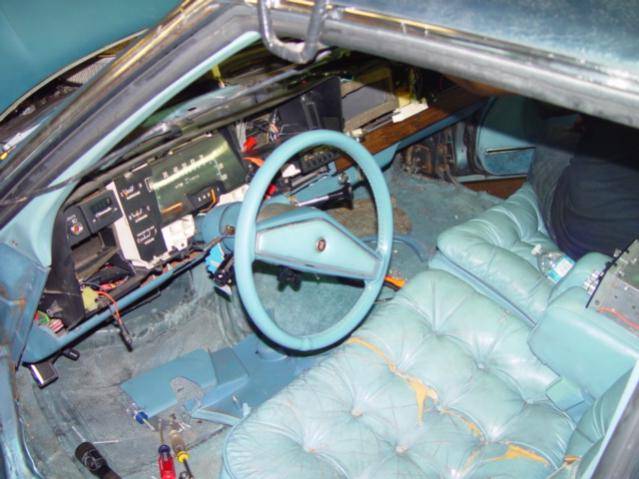

Next, we (Mike & my nephew Matt) go to dash tore apart and troubleshooted the A/C system. We found all but the red and the brown vacuum hoses disconnected. Also replaced the fan motor switch, the fan blower resistor, and the max air/heat/defrost/vent controller. Everything works now an air blows out where it is suppose to. It is just taking a little longer than usual for the air to switch from defrost to A/C and switch to any mode. All 3 vacuum actuators are acting like that. They all work but take longer than usual to switch over. The young man on the driver side is Mike and the younger man on the passenger side is my nephew Matt. Thanks fella's!!!

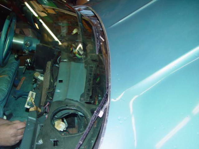

We got the rear seats and the package tray out. New seats and a quick paint job on the package tray in the morning. New stereo and antenna going in tomorrow. A few other items too. Found some items from the squirrels and/or mice under the seats. I did not find a build sheet 0under the rear seats or under the dash pad. Hopefully will find one under the driver's seat.

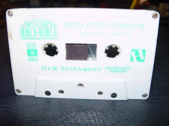

Here it is again Stan.....under further scrutiny we determined it was part of a one of one Hemi special package.
Looks like the prior owner was a Holy Roller.
Probably prayed a lot while driving looking for a miracle that a wiper link would fall to the earth.
"Dramatized" version? WTF?

Bob, I want a step-by-step detailed description of replacing the heater box. I pray you're taking notes.
