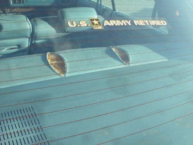

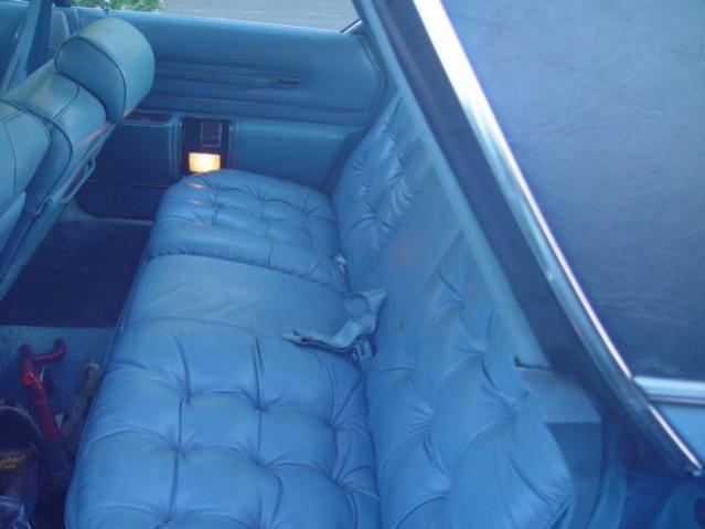

Also painted and installed the package tray and replaced the rear seats.

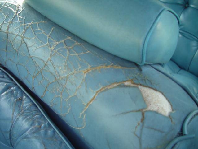

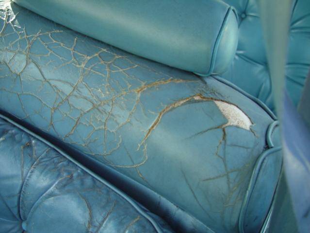

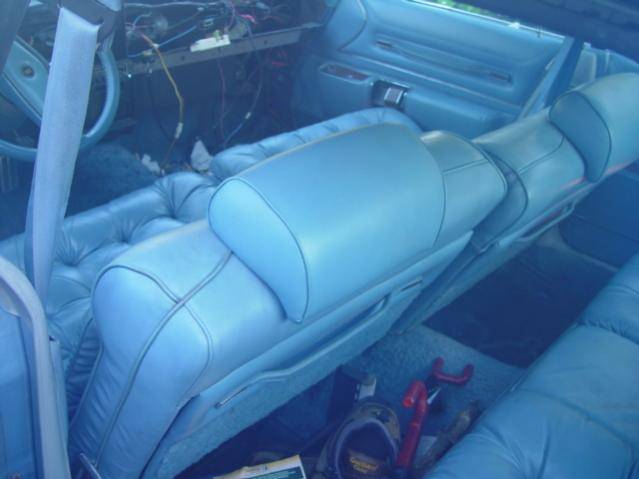

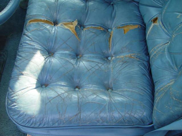

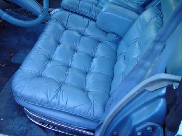

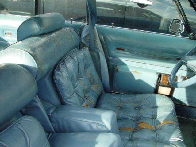

The good news is we got the new front seats installed but had to swap the motor and tracks from old seats to the new seats. Those complete seat assemblies are heavy as hell!
Old seats....
New seats, package tray, and door panels....
