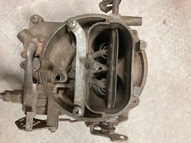

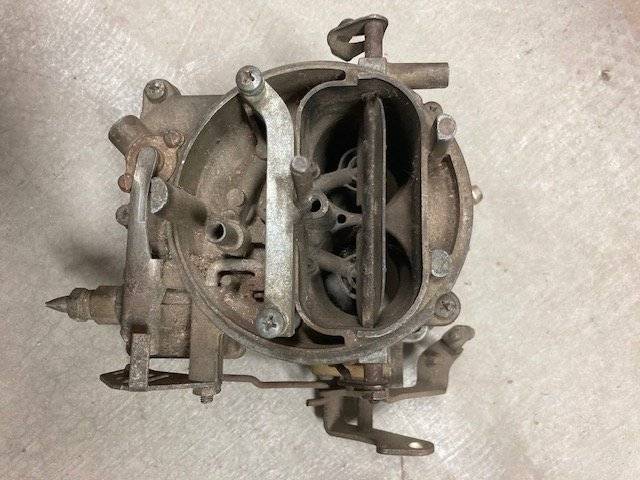

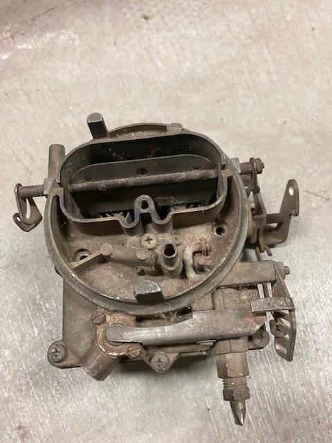

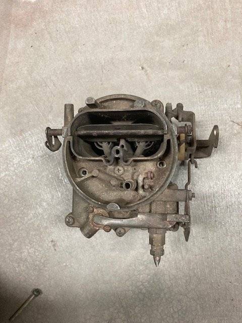

This is that carb for my '70 E20 4x4 383 4sp Braden 10,000lb PTO winch ex Dept of Game rig.
View attachment 586314View attachment 586313

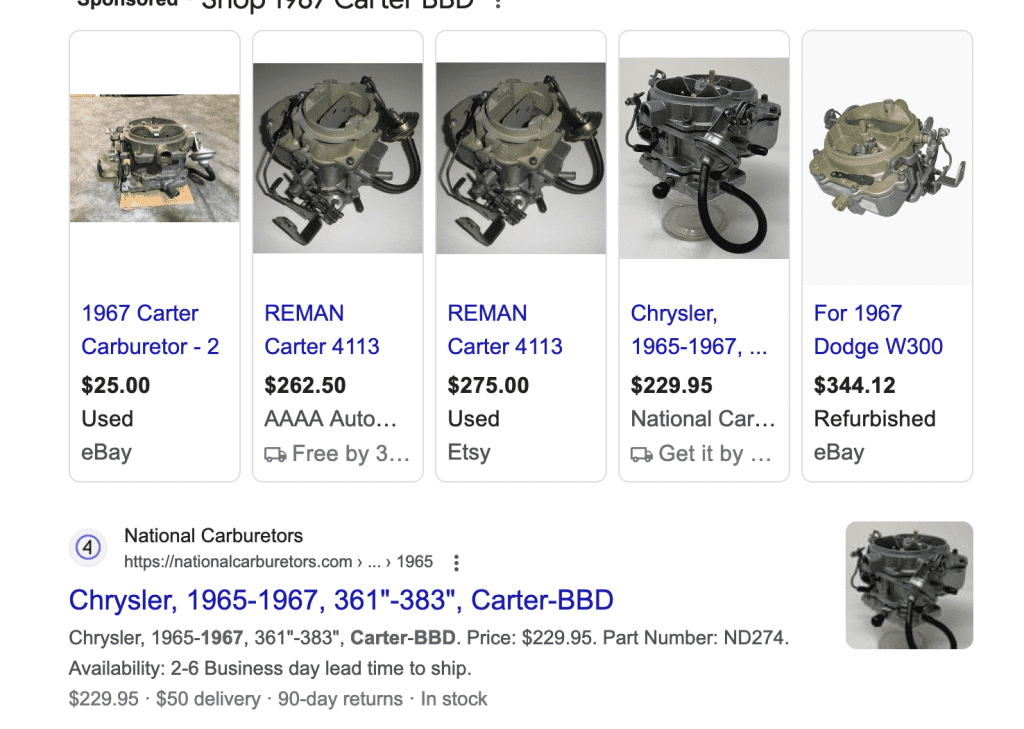

What model Carter is that and is it a straight bolt on? Availability?
Carter BBD. Used for years before the junk Holley carb. An example of how progress generally sucks.

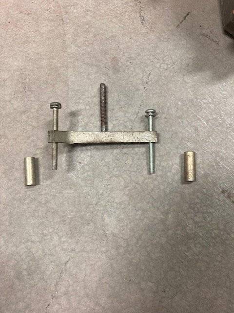

Hey Steve - do you happen to have a graphic of that bridge kit? I just wonder if I could fabricate something, if need be.

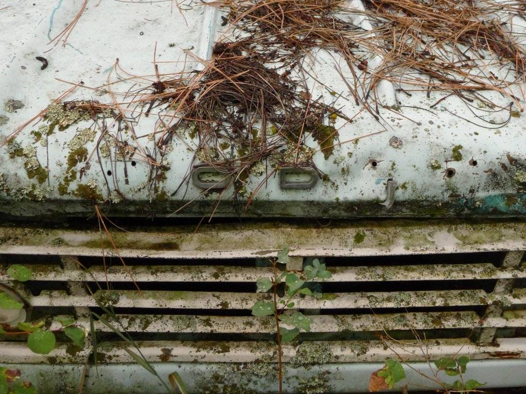

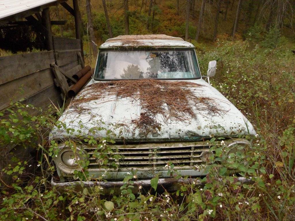

I drove one that worked for a while about 20 years ago, here it is now. Had an awful gutless/gas guzzling 360 transplant, not Chrysler's best work all the way around. Got tired of it, parked it next to the barn and started cannibalizing it. Has a good 4:10 DANA locking diff. The engine is actually a better early 360 from the good years, '71-73.

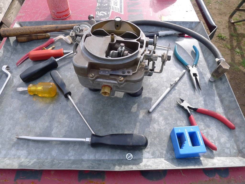

Just wanted to post about a stall out problem I’d been having on a 73 Monaco 400 v8 2bbl (rebuilt from Autoline). Car would start fine and run for about 5 minutes, but as soon as it was warmed up, it would stall out.
I swapped out the carb with a $50 eBay replacement carb today, and amazingly it fixed the problem. Got rid of flat spot under acceleration also, and it idles great now. I suspect either there is dirt in the old Autoline carb or, as one member has suggested, the air horn is warped and was not drawing adequate vacuum to pull fuel through the venturi’s. I will likely take it apart and see if anything obvious is visible. I’ll post pics, if anything interesting.
View attachment 586770View attachment 586771
That’s a cool looking - pickup? - got a better shot of it?
Yes, I will get one in the next day or two.

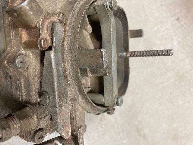

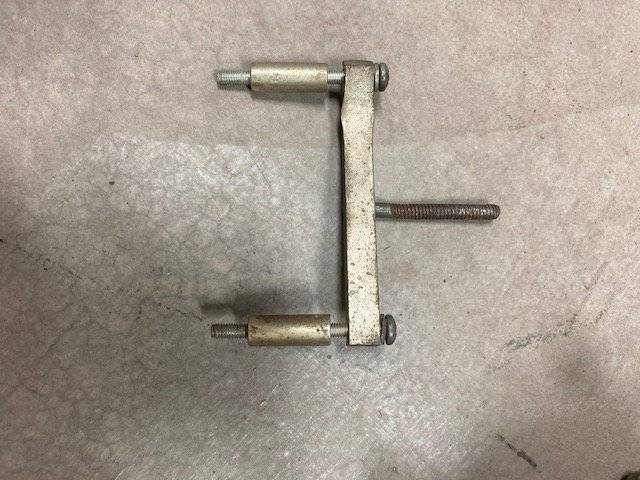

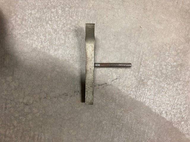

Here are some photos of the bridge kit. I think it is pretty straightforward how this kit provided extra support for the stud holding the air cleaner by adding the two new, longer screws to firmly hold the air cleaner to the base of the carburetor via the bridge instead that is much stronger than using the airhorn for the mounting the air cleaner stud (note that the threaded stud that holds the air cleaner in place is part of the "bridge" that goes across the body of the carburetor and secures the air cleaner rather than such a stud mounted on the weaker air horn as in the original design). I did not tighten the screws of the bridge kit in these photos since I will be taking the bridge off again when I rebuild this carburetor for use on one of my 360s.
If you have any questions, feel free to ask.

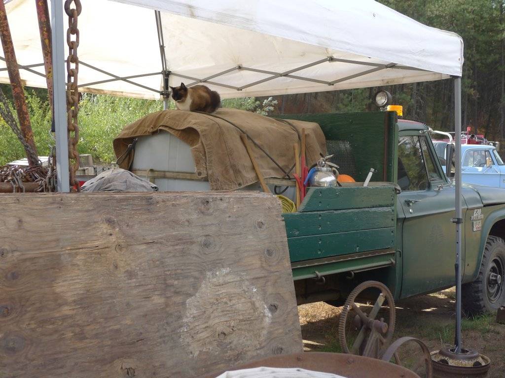

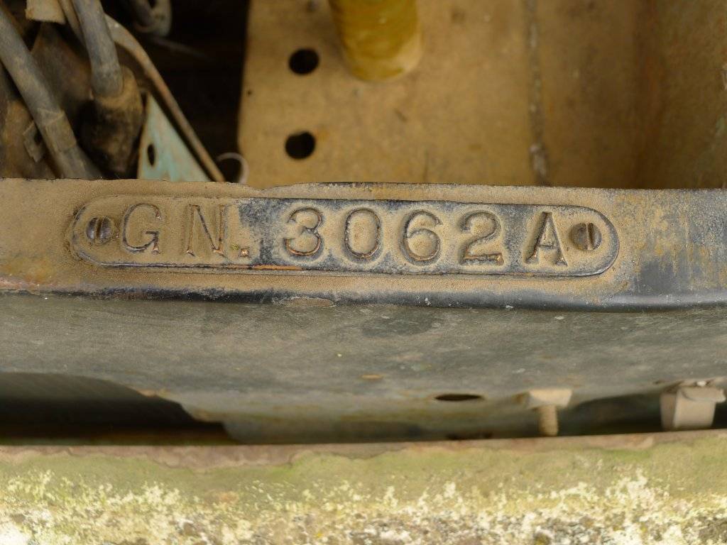

'66 D200 possibly ex Great Northern railroad rig, brass inventory tag on the core support.

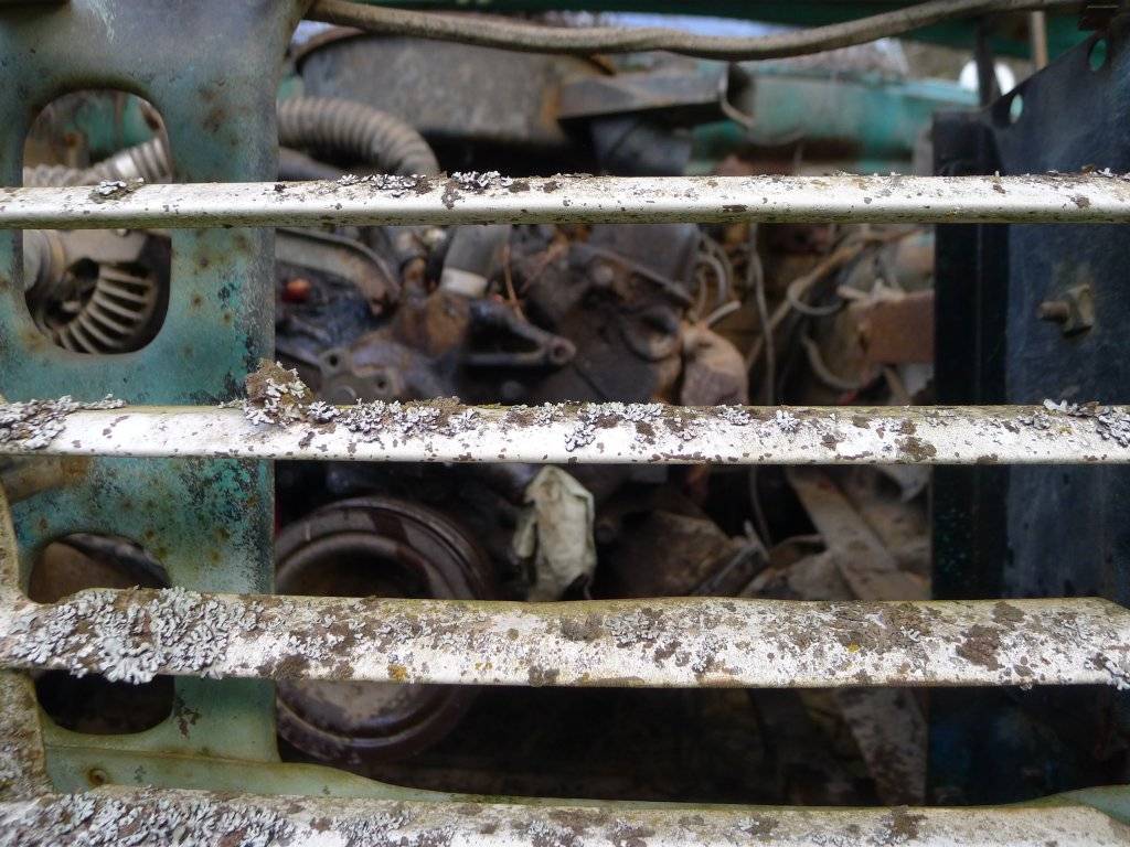

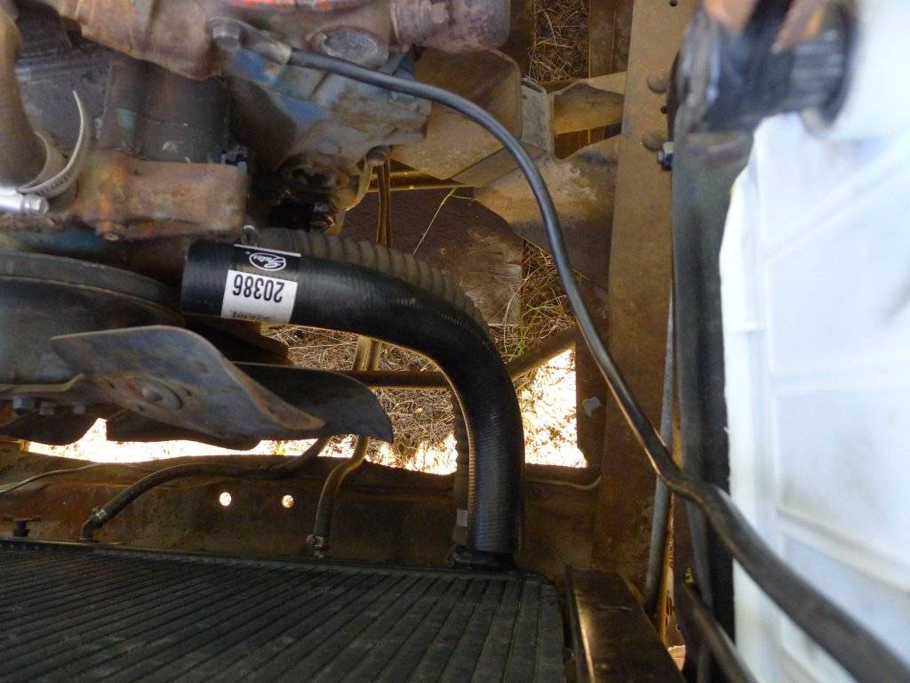

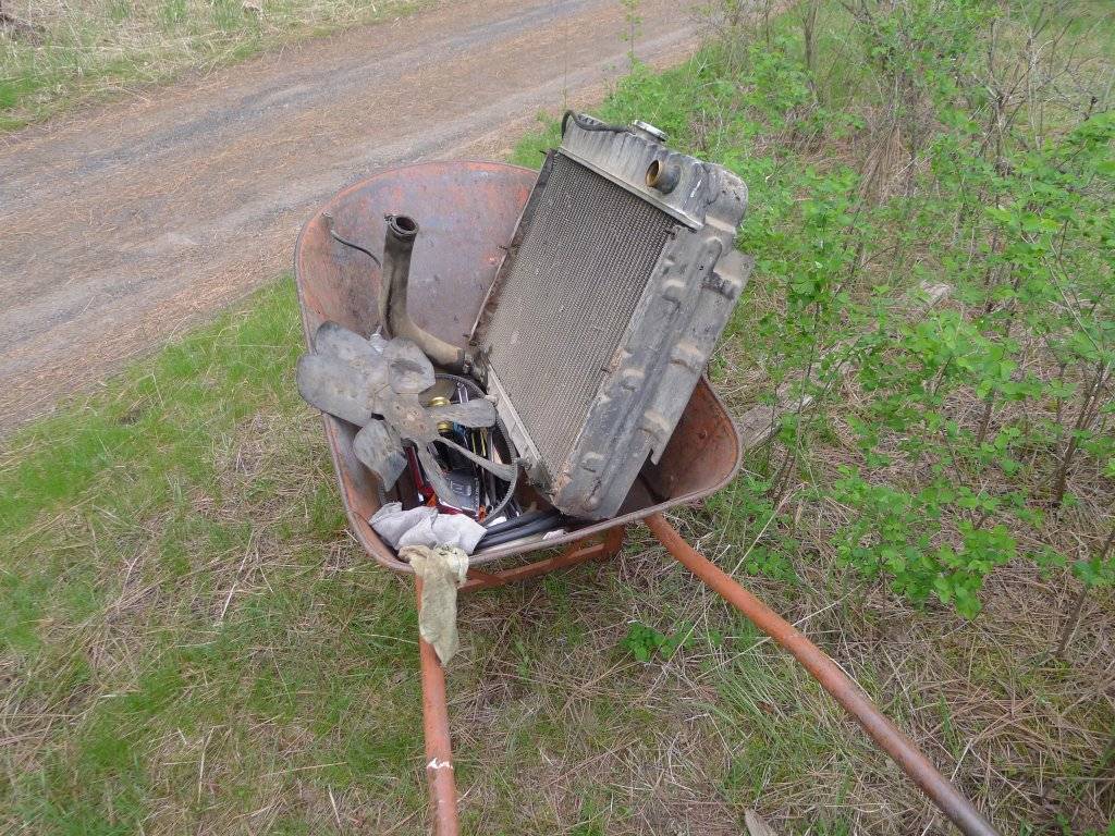

And the '66 Monaco 383 w/AC rad that came out of that truck, which I had rebuilt, and then almost a year later realized it would fit my truck with missing rad correctly if I switched ears from a truck big block rad, and I just happened to have that rad, and a swap at the rad shop and this is after nearly 2 years without a rad under the hood of this truck, and it started up on at 1st touch of the key. Rebuilt 318, shuts off just as a fast, tight.
Now with proper hoses, make that a 3 year project.
View attachment 586969 View attachment 586970 View attachment 586971 View attachment 586972 View attachment 586973 View attachment 586974View attachment 586975 View attachment 586976 View attachment 586977
That's a handy FIX! I like this as much as I do the steering pot wire clamp.
