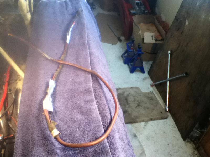

I THINK heat is a major component here. I HOPE it is anyways otherwise I'll be under the dashboard. Yes. electrical demons are difficult to cast out.

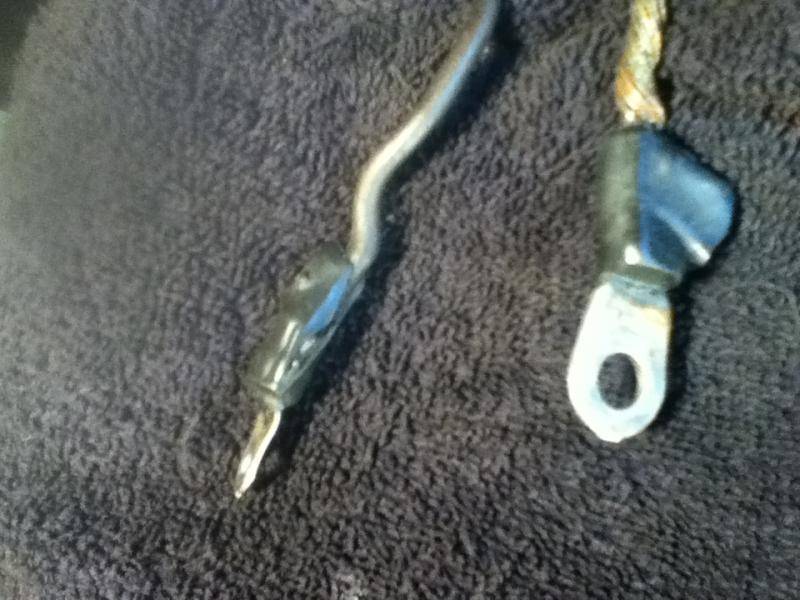

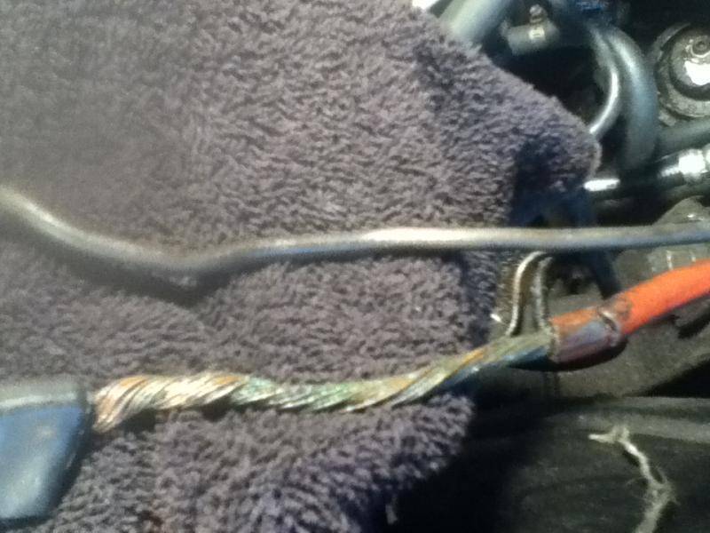

Might there be any significance to the fact these two wires were once attached to one another via a plastic/rubber piece at the end? I split it apart while handling it. This end connects to the starter motor itself. I wasn't going to bother trying to duplicate that when I make up the new cables. I'll insulate the crimp on each wire separately, then wrap the wires together with something like this further up....
http://www.jegs.com/i/Thermo+Tec/89...2&cadevice=c&gclid=CK_D0eaH1r4CFUMF7Aodb28Adw
That just means it was the original wiring. The two insulators were just molded in one piece so it bolted up to the starter easily.
Nothing for you to worry about.

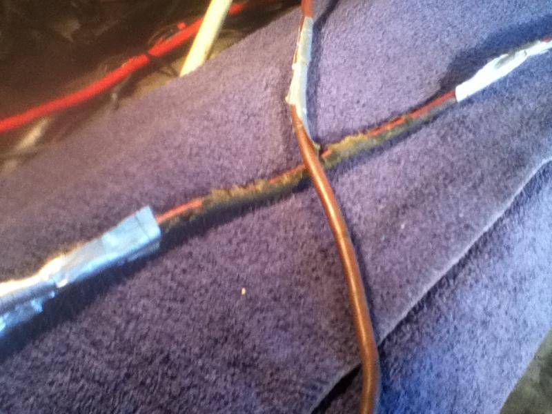

Actually, it was a tad over 40 bucks...but I had to get a few extra things along with the cable. The wire for the solenoid is undamaged and the insulation is completely intact along the entire length of it...could use a good wipe to get the grime off, but other than that its going back on. I was going to attempt to make everything from scratch before you jumped in and screwed the program all up Big_J, lol. I can understand though why making it all up would at the end yield a superior set up.......but for this situation Chrysler factory replicate is good enough for me.
Many thanks BJS...I learned something I didn't know about the difference between the automotive and welding type cables.
So I HOPE I nailed the problem. I believe it was the extremely poor condition of the original cable....intense heat was causing greater resistance. The end that connected to the stater terminal was bare conductors that were beginning to unravel and had acid buildup in it. When the car was parked and cooled down a little it would start right up. With the intense heat not so much. This was driving crazy b/c I couldn't see the bare part of the cable down below so it was hard to understand what was going on. Anyways I got new 6' starter cable from AAP, clipped the battery end and put my own post clamp on it. So far its been ok...(since sunday) no start up problems when hot, turn the key and it kicks over without any hesitation. My thanks to all who chirped in. Keeping my fingers crossed.
