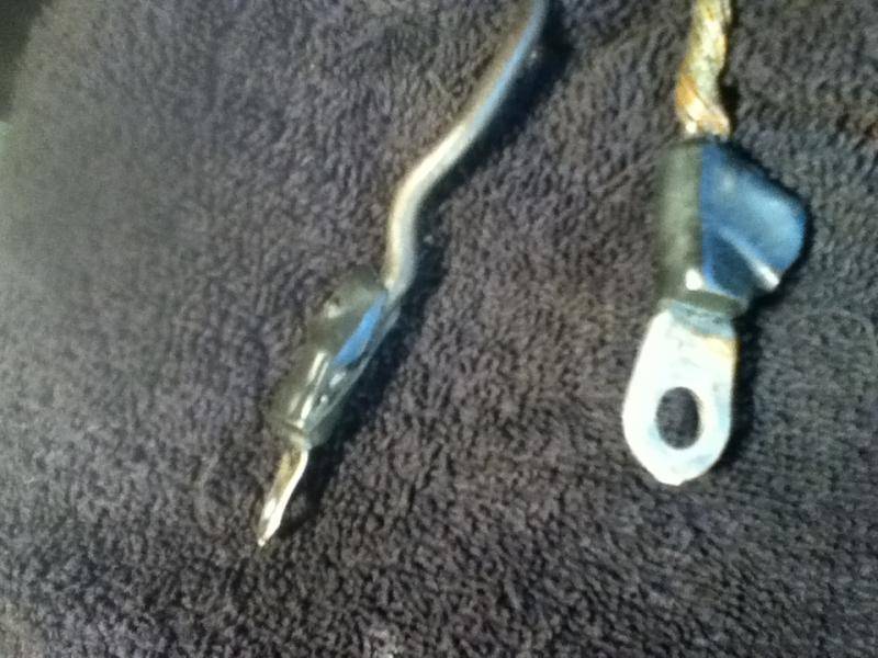

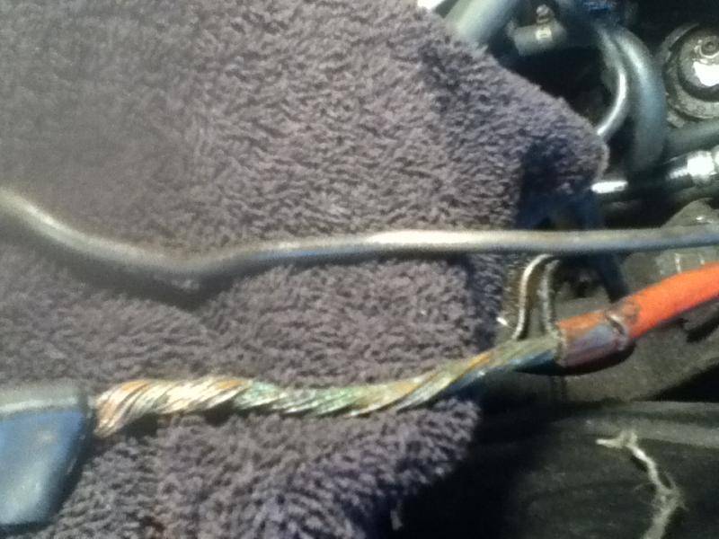

So finally got time to come at this from square one.....the ignition cable. Down below its toast, just from handling it ...pieces of insulation and plastic started cracking off.....appears to have acid buildup and the conductors are starting to unravel.....not good. I bet this is the problem.
