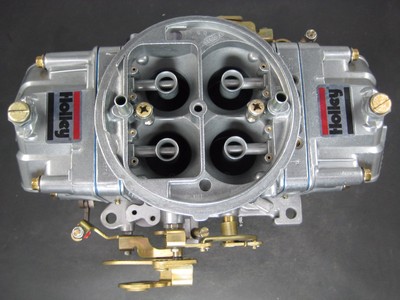

It sounds like you really want to use that carb. It really isn't a good match for any other component on your engine.
What will happen with too big a carb, it will bog and lose low end torque. You will actually lose power. Plugging in the numbers, 383 CI x 5500 max rpm/ 3450=609.5 ideal CFM x .9 VE= 548 real needed CFMs
If you could get right cam (Magnum ish) , aftermarket intake, elec ignition, headers, your motor would scream. If you choose a couple wrong parts, it will be a turd.
$400 isnt much coin to really make a dent in a project. I would concentrate on following the factory route with electronic ignition, 4 bbl intake and a Magnum spec cam. You can trade that big carb off, here's a link to a possible option for you.

Thank you, I think I'll put the 830 up for sale then. It'll also give me like 500 extra bucks so that wont hurt

Best upgrades for a 2bbl 66 383? I already have a holley 830hp carb. $400 budget on hop-ups not including the carb. I have bo problem tearing apart the motor as its already on the stand. :poke:
On a $400 budget I would leave it the way it is.
Really, a 383 2 bbl is 270 hp and 390 tq.The smart thing to do would be upgrade to electronic ign and call it good.
I wouldn't follow my own advice though, some of us want to do it the hard way. If you do decide to make the motor more powerful, just be aware that it usually never stops.
If you put a bigger cam in, you need bigger intake and exhaust manifolds. Don't forget that new 4 bbl carb.
The $400 thing, yea, if you're that tight for money, put it somewhere else that's needed.
You'll be happy without that big ole carb though...sell it and buy some other stuff!

Just bought this last night for $350. Its a 600HP that is CNC-ed to around 670cfm. Now with selling the 830hp I'll have an $800 motor budget. Also, it already has elec. Ignition. Pertronix II and flamethrower coil. So I'm figuring, intake manifold, cam, torque converter, and some super-cheap headers that I can bend to fit. Probably should've mentioned that I'm not worried about keeping it stock.
Any specific intakes and/or cams to consider?
Basic dual plane or a cast iron unit will work just fine. Call Jim Dowell at Racer Brown for the right cam for your application. An 800 carb will drown a stock 383. $400 won't take you too far if you start pulling heads etc.. hit some swap meets..
That carb is designed for high end street use on engines with 240 plus degrees duration cams and engines pulling 8 inches vacuum at idle. That carb would work good with a fairly radical cam ,lots of stall and a really high gear ratio. On a mild engine not so good. You need to take your time and do your research on these things. I would recommend you purchase some books on performance engine building and pour through as much literature as possible and develop a good understanding on performance builds. It will help save you money in the long run and you will get positive results the first time. You need a clear goal as to what you are looking for in performance gains. If you are looking to get this car on the road and running in the very near future I would keep the motor bone stock put it back in the car and just drive it. If you want to make power gains keep saving your money over the next couple of years and slowly accumulate the parts. It took me over two years to build my engine. If you have the patience and are willing to wait that long you will be much better off and much happier with the final results.

Add me to the list of "an 830 mech secondary carb is too much" camp. With mechanical secondaries, you gotta keep the carb smallish or it'll fall flat on its face when you stomp it. Vacuum secondaries or or an air-valve carb (AVS, Thermoquad, Rochester Quadrajet) work far better most of the time, unless you are prepared to spend a lot of tweaking to get the throttle tip-in and accelerator pump shots tweaked just right. My personal favorite is the AVS (or the modern equivalent Edelbrock Thunder Series). Holley and I just don't get along well, though I know others like them and they are very tunable.
So on your $400 budget, you gotta be careful. That pretty much means keep your heads, pistons, etc. because tearing that far in will eat the budget fast. I'd sell the 830 carb and buy an AVS (or a vacuum secondary Holley, if you must), get a cam/lifter set, custom exhaust (with or without headers as budget allows or doesn't), upgraded timing chain set while you're doing the cam, and electronic ignition. Boom: fun on a budget.
