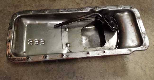

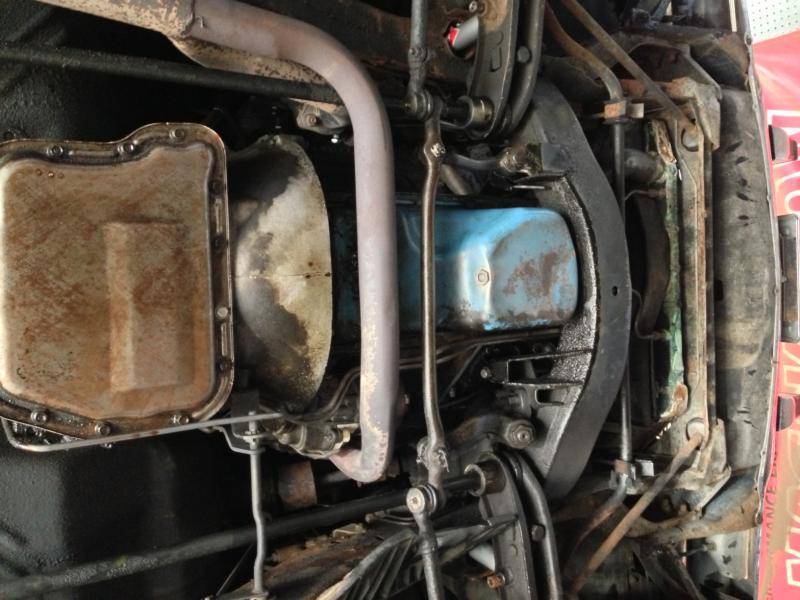

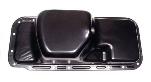

I believe a c body needs the notch for the idler arm. Just because it fits all b and e doesn't mean it will 100% fit a c, may work fine just something to think about.
There is indeed a chamfer in the sump for the idler arm... the specs on the Jeg's site don't show a lot of info. The expanded vehicle application list for the Canton Racing pan includes C bodies. BUT, it would still be best to see a drawing of the pan or photos all around before fully committing.
Edit: just found this...The gold irridite and chrome pans have the chamfer: http://store.440source.com/Oil-Pans/products/54/
I don't think I've seen an oil pan on C-body that didn't have a dent in it.

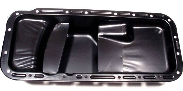

Update: 440 source has repro pans that are a match to the 699 or 187 pan (they say the two are identical). Also has baffle. Here: Oil Pans
Negative aspect: $250.
The link I posted above is the wrong pan for a C-body. The chamfer is there, but still needs a notch like the pan shown below.

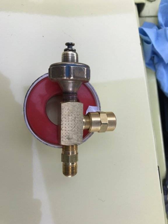

I finally installed a dual system - gauge along with the idiot light.
I don't think I'll leave the gauge in place permanently, mainly because it was just for a status check, and I don't want to clutter up the dash with any more stuff.

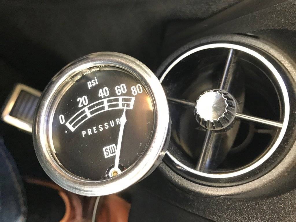

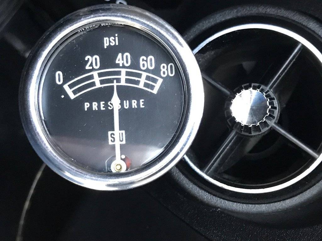

But - it this gauge is correct, I have about 35 psi at idle hot, and 70-80 psi at speed, hot. 10w-30.
What is considered "ok" for a 440? This seems "not too bad" to me. I'm burnin' oil at the rate of 1qt/1000 miles, but at least the bearings seem ok.
130k miles on the motor, never been out, still driving the hell out of it!
