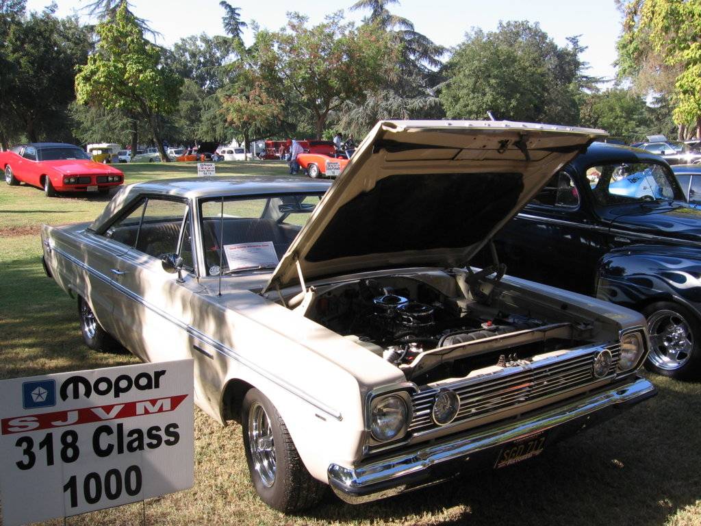

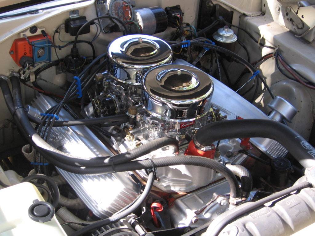

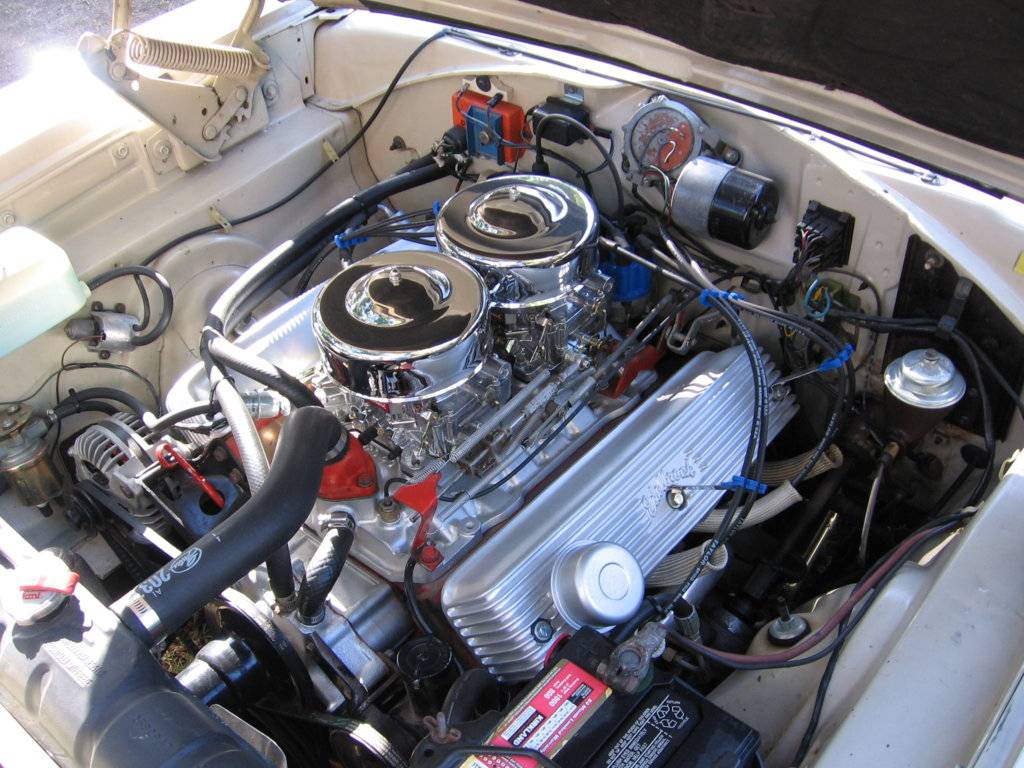

Oh baby! Oh baby! Didja see this one, Wil (@bluefury361) ?!?
It was in a '65 Plymouth at a Mopar Show in Madera, 2009. I liked it and took two pics of the engine. Ha!
