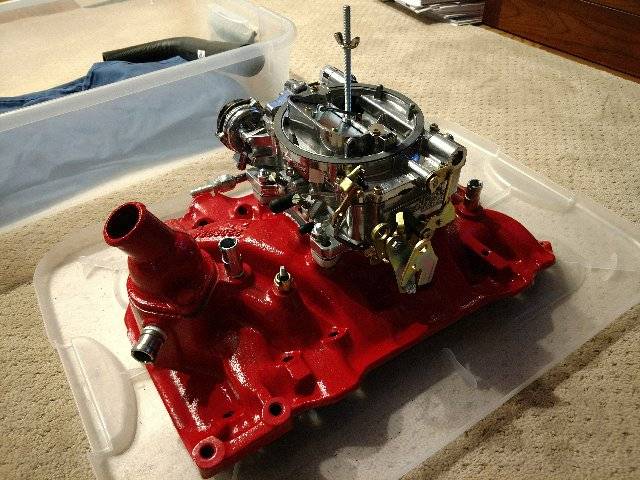

Well I've made some progress over the last few months...had the manifold media blasted and painted it poly red. Bought and installed all new coolant nipples. Had to buy a new coolant temp sending unit as the 2bbl unit is too small. I found a 3/8" phenolic spacer was just thick enough to allow the butterflies to open without interference while keeping the overall height increase to a minimum.

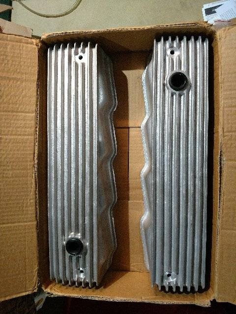

Also purchased a pair of the finned aluminium valve covers from the blokes at Pentastar Restorations. Think I'm going to leave them natural cast look rather than polishing them. I've got all the new gaskets I'll need and think that the throttle linkage adaptation shouldn't be too difficult. The last piece of the puzzle is the poly performance cam I found at camcraftcams...figure if I'm going this far, a little lumpy idle should tie the whole project together...

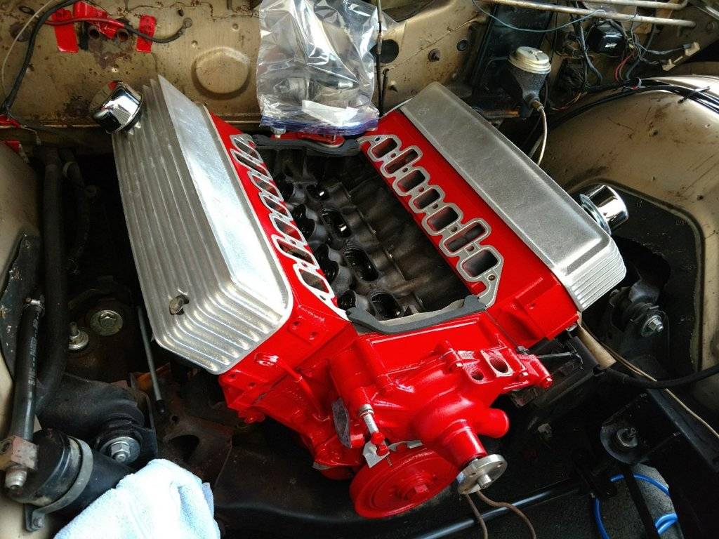

A couple pics...
Finally getting close to finishing up this project. It got a lot more complicated with "additional tasks" that involved removing heads, grinding valves, installing slightly higher performance valve springs, new valve stem seals, a performance cam and new lifters. More than two months later, heads and cam are finally back on/in and readying to FINALLY install the 4 barrel intake that started this whole project! A couple questions on the intake installation- the Fel-Pro head to intake gaskets are metal crush type gaskets... should they go on dry, or should I coat both sides around the intake and water passages with Permatex aviation form a gasket (or the Permatex high tack gasket sealant?
Also, what's the consensus on the front and rear foam rubber gaskets?...I hear varying opinions as to whether they should be used (with a blob of Permatex at the ends) -or- Not to use them at all, and instead just run a bead of Permatex entirely across the front and rear intake mating surfaces???

AMC motors have the same type of gaskets on the front and rear of the valley pan area. I was told to not try to use them and just use large amounts of Permatex. I didn't listen at first. When the gaskets kept rolling I took people's advice. Has worked well.
on the ford and chevy small blocks, it's the law to toss the end seals. i use motorcraft TA-30 gray rtv. also a very thin strip of this around the coolant passages. brown aviation around air passages. that motor looks fantastic with those valve covers. old school.
The embossed metal gaskets came from the factory with no sealant and that will work as long as the mating surfaces are not pitted or rusted. I use the aviation Permatex on any that are badly degraded. The regular liquid Permatex is fine for one ones that are just not perfect but not badly degraded. I use the red Permatex RTV form a gasket on the ends. Be sure the ends are very clean and completely free of oil.
Dave
Thanks for the advice...the intake and head mating surfaces are perfect, so the metal intake ones will go on dry. I had heard of many problems with people using the foam rubber gaskets on the ends...I can't imagine dropping the manifold exactly over the bolt holes the first time without moving it slightly to line things up. I can see how the foam gaskets could easily get scrunched up or rolled by trying to adjust things slightly. Probably should have used the Permatex red on the timing cover...think that crummy paper gasket will come back to bite me!...live and learn...
