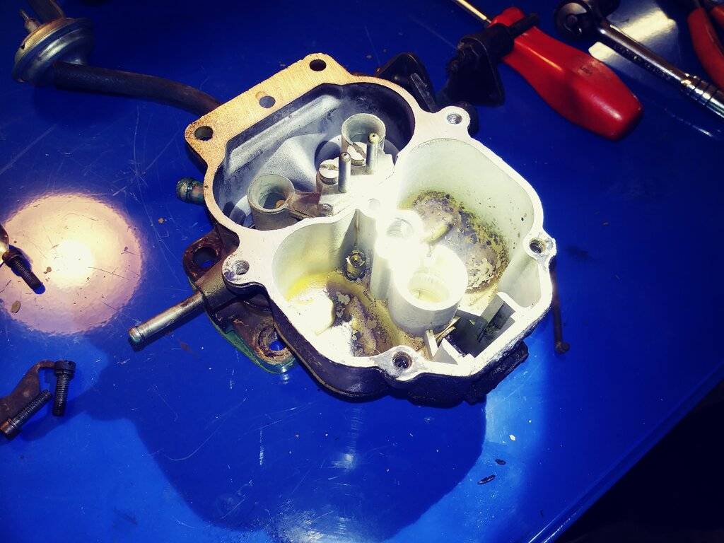

I gave up trying to tune mine and had it rebuilt..
I can bet that if you took apart your carb it may look something like this..
Carb should be rebuilt if the car has been sitting a long time. No doubt at least open it and clean it out.
I sent mine to Dave at Woodruff for a rebuild. Came back great. Car is actually running cooler because the mixture is properly squared away. Still dealing with vapor lock issues, but other than that, she's running much better since the rebuild.
Was actually very clean inside. I rebuilt the top end of the carb and cleaned it up good.
The adjustment screws were all wrong, and 1 was unknowingly missing...
