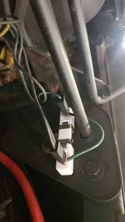

New ballast resistor didn't do the trick, but now see its .633 ohms...I think it should be 1.2-1.4 ohms if memory serves me right...

Still not working with the new balast resistor, but worked bypassed...
Put the old ballast resistor on- worked without bypass.

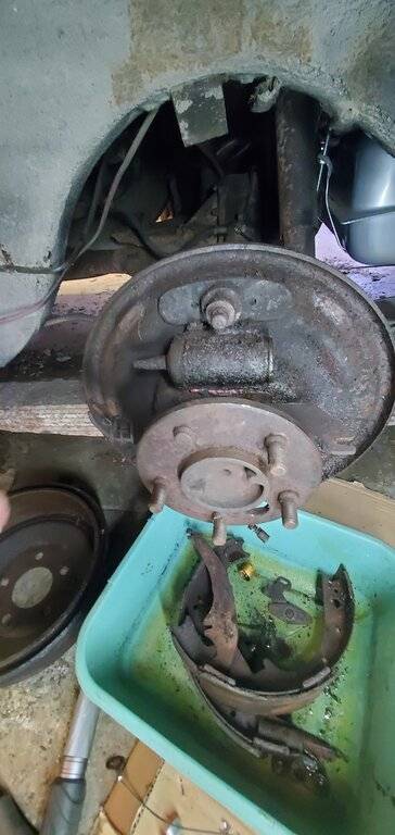

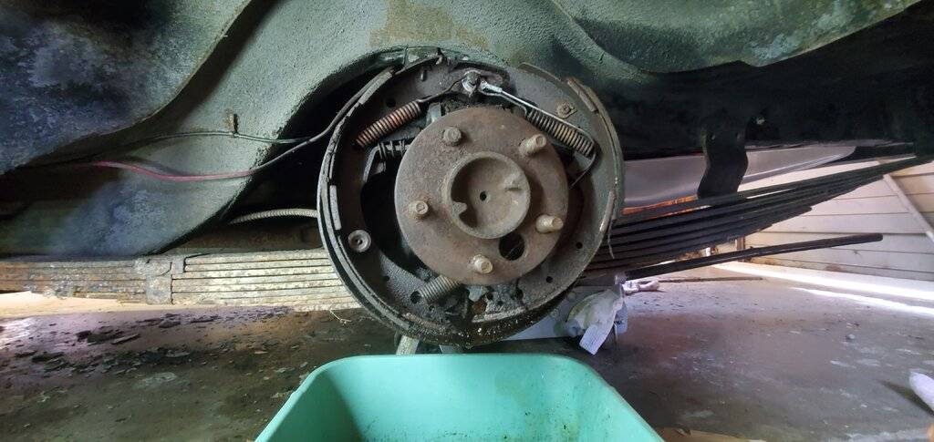

But yeah, found the front drums to be all new, including cylinders, rebuilt entirely the back, all new, all the way around- from the booster to the back right lugnuts....

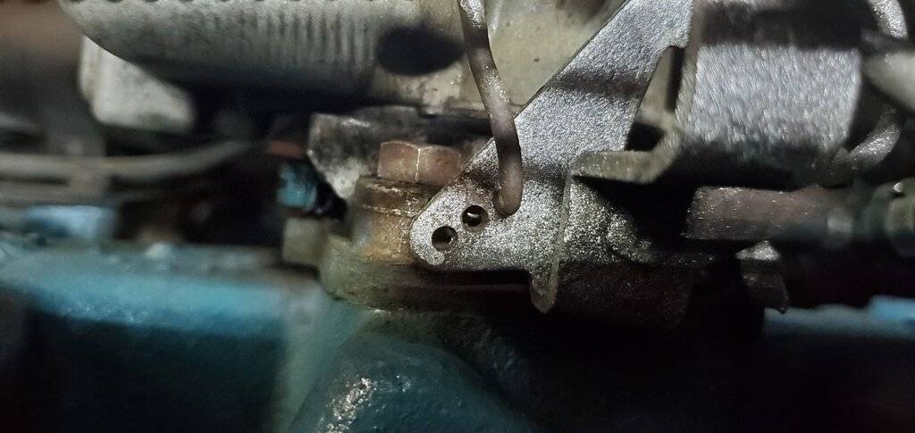

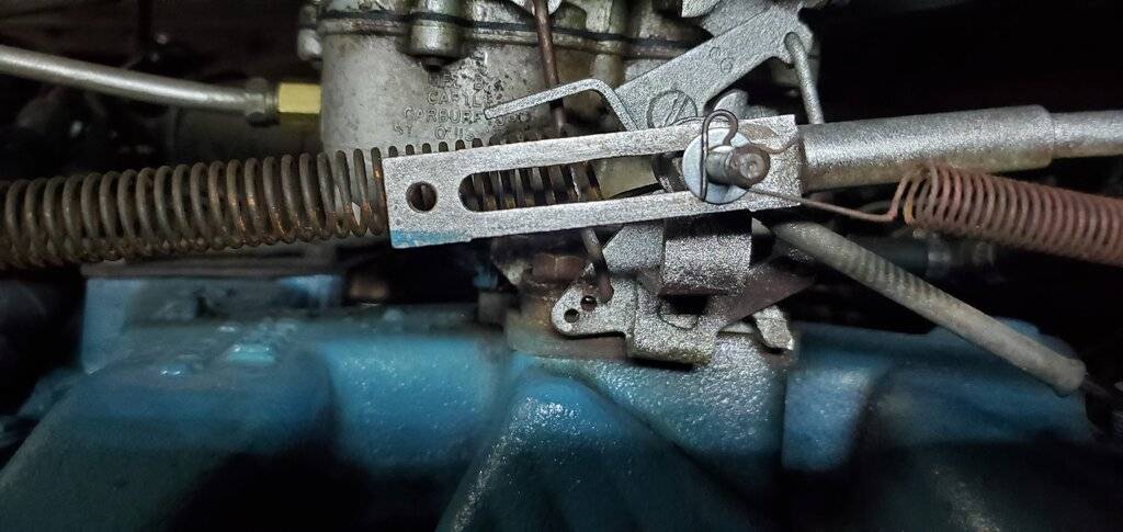

After getting breaks together, had a bit more time to kill...and found my carter carb has 3 settings for climate...interesting....when it was parked, it was dead winter in MI, being driven an hour each way daily in 2001, 1 hour each wsy....and was set for cold weather....moved the part to the top hole, and ran much better, see pic-
but, now....idles great, but have to feather the pedal a bit to rev up, initially, before it will rev without stalling....
New accelerator pump hardware...
Timing? To compensate for weather snd reposition of rod on carb?
Not sure here....
