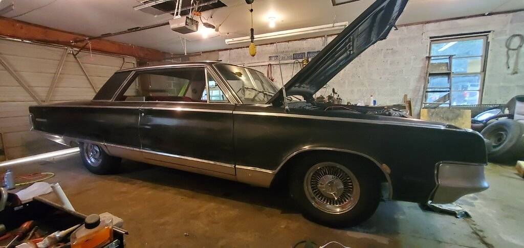

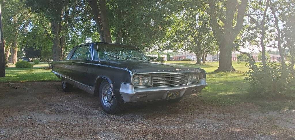

Took it outside for some sun-
Ill elaborate more soon...this dude in lic is not me, ha!!!!
