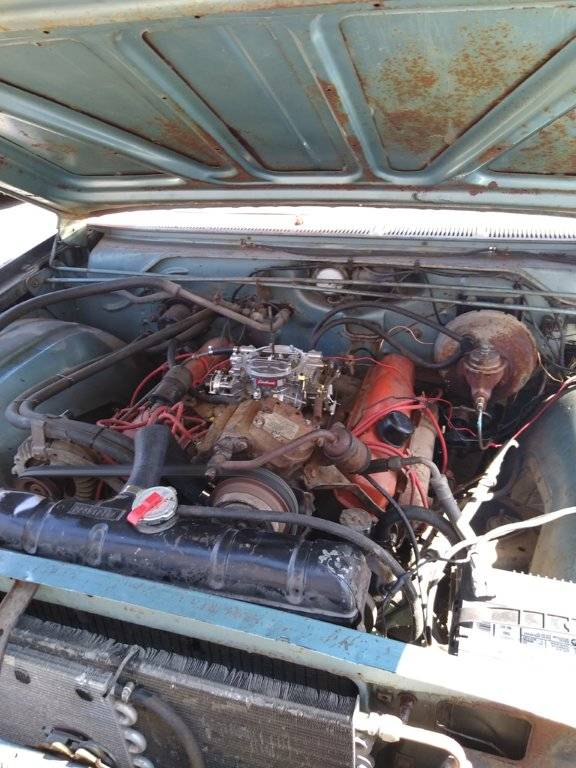

Decided to start it up, let it run a bit...didn't seem to want to run, gave a little gas to get it idling- shotgun backfire, blew up my muffler....
Not touching it again tonight...
Wow, are you me??? That's the kind of stuff that happens to me.. guessing your carb trickling gas did that

remove the coil and crank it. take the plugs out and Let all the **** in the chambers dry out. Don't push on the throttle.
I'd even pull the carb off just to make sure no more gas flows in
You need to work that motor a little more. Make sure it's loose and everything is working as it should
