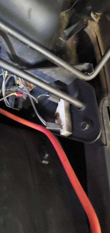

That ballast resistor looks like a wiring issue. It's just a big resistor... could have just been bad, or you have a wiring issue as already stated... to the coil. Carb floats are probably stuck. Tap lightly along the sides and see if that helps. Maybe needs a rebuild.

Hot Ballast Resistor
The white thing?
The white thing? Ballast resister. Drops voltage to coil. It gets warm, but shouldn't smoke.... Check wiring to coil
Thx for the lead. I'll check it out.
It was very hot and definitely smoking. Too hot to touch.
In the first link, C body bob wrote-
You can burn the contacts up leaving the switch on. Not sure why the ballast would start smoking with the engine off.
The car had stalled, and key was turned on...hope that was it.

too had a problem just like yours. Mine was the wire going from the coil to the dist. It only had a couple of hairs that were not broke. Car would run fine for awhile then just die. Let it set for 15-20 minutes and it would start right back up. Fixed the wire and haven't had any problems with it since. Just another idea to look at.
I'm going to check all wires. The car runs nice on warm up, then beautiful till hot...then just dies...and doesnt want to run well or at all after- figured it the carb, but now...
