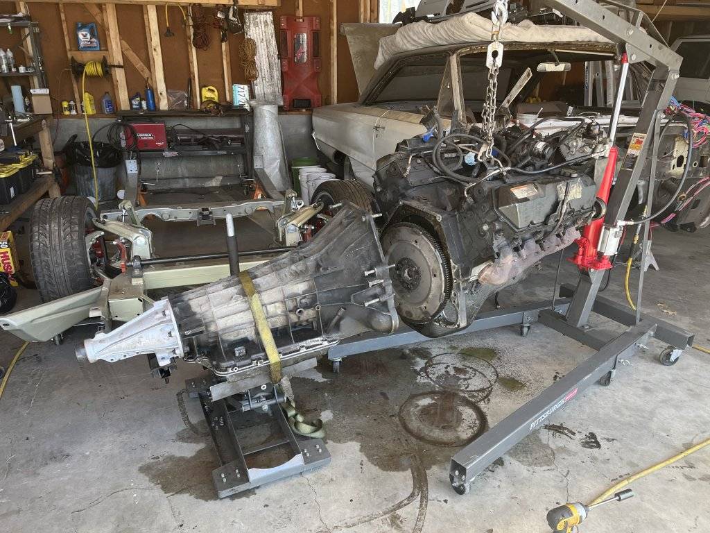

Nah shouldn't be. There's a lot of stiffening that was done to begin with because I was planning on a 512 stroker at some point. The engine will be significantly heavier, but we're not talking orders of magnitude heavier, just a couple hundred pounds. With how tall the T444E (7.3) is, It'll be above the hood line, so I'm talking with a buddy of mine that owns PFC here in Kansas about modifying the hood into a wide cowl, induction hood.

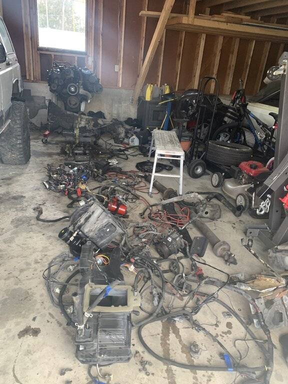

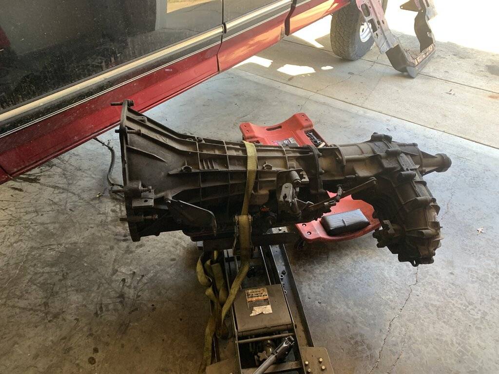

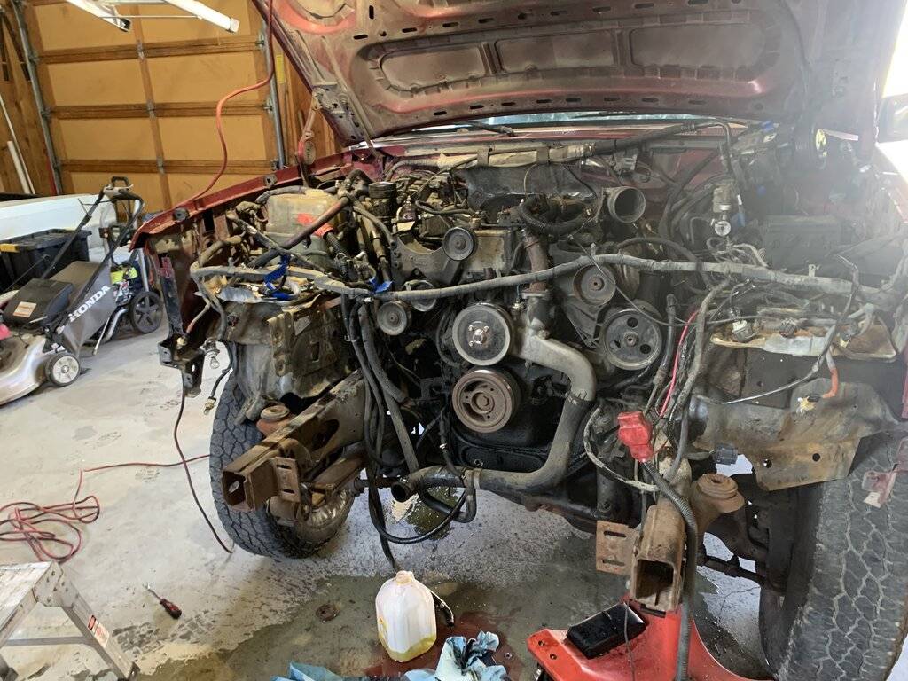

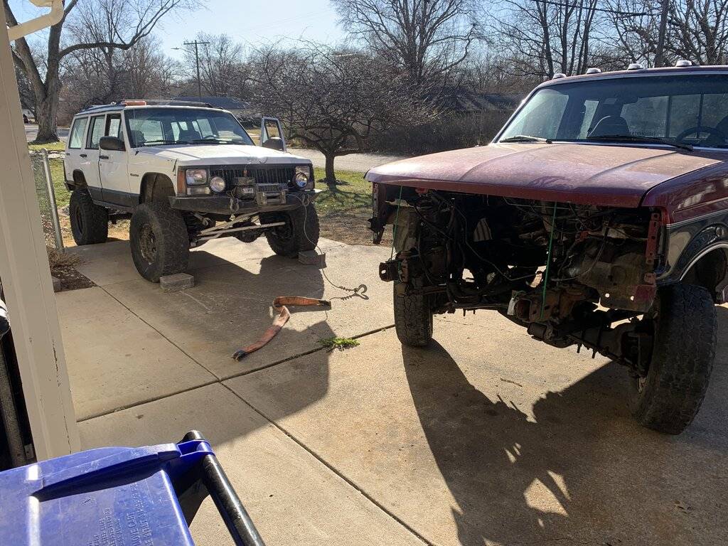

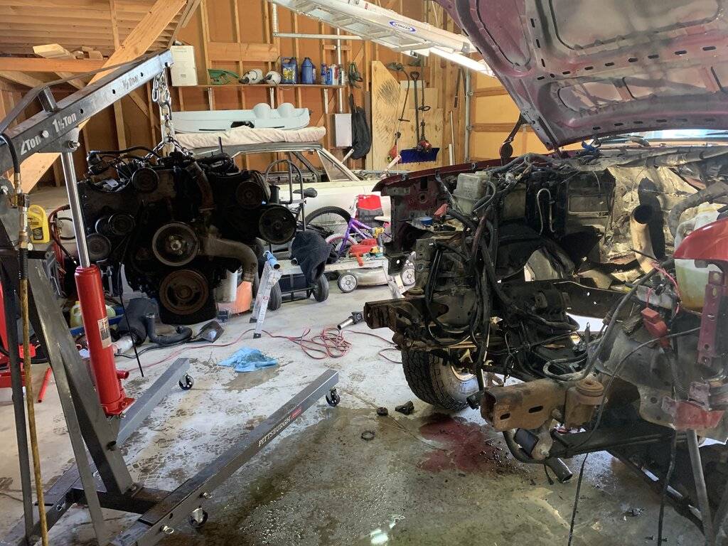

On the week leading up to Christmas, I rolled Lucy into the garage and got to work. 7 Hours later, and her engine was in the stand, and the transmission was on the ground. The next day I set to picking the truck clean to the bone. By the time I was done, literally nothing remained but a shell. I ended up using Nancy (my XJ) to tug everything back into the driveway so that I had some place to park.

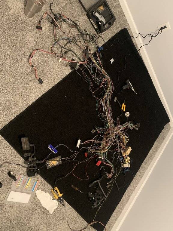

From there, I decided to start on the cab wiring harness to delete the stuff that I don't need. Since all I need is the engine management stuff, and my Monaco is already completely wired, there's quite a bit that could be deleted from the harness (door locks, power windows, interior lights, radio, etc.) After several very careful hours of surgery, I finally consolidated the harness into something that's more amenable to the build. From here, I'll start working on the other two harnesses (the under-hood harness, and the transmission control harness). Then once I think I've got the harnesses done (It's cold in KS, I can work on them inside in the comfort of my PJ's), I'll work to start fitting the engine and transmission into the subframe, and then the car itself.

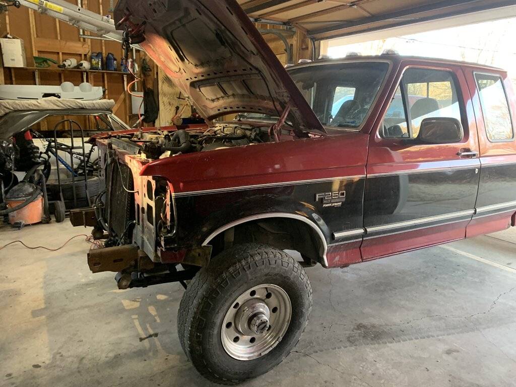

The F-250 doesn't look too bad in the pic's. What totaled it? Frame damage?

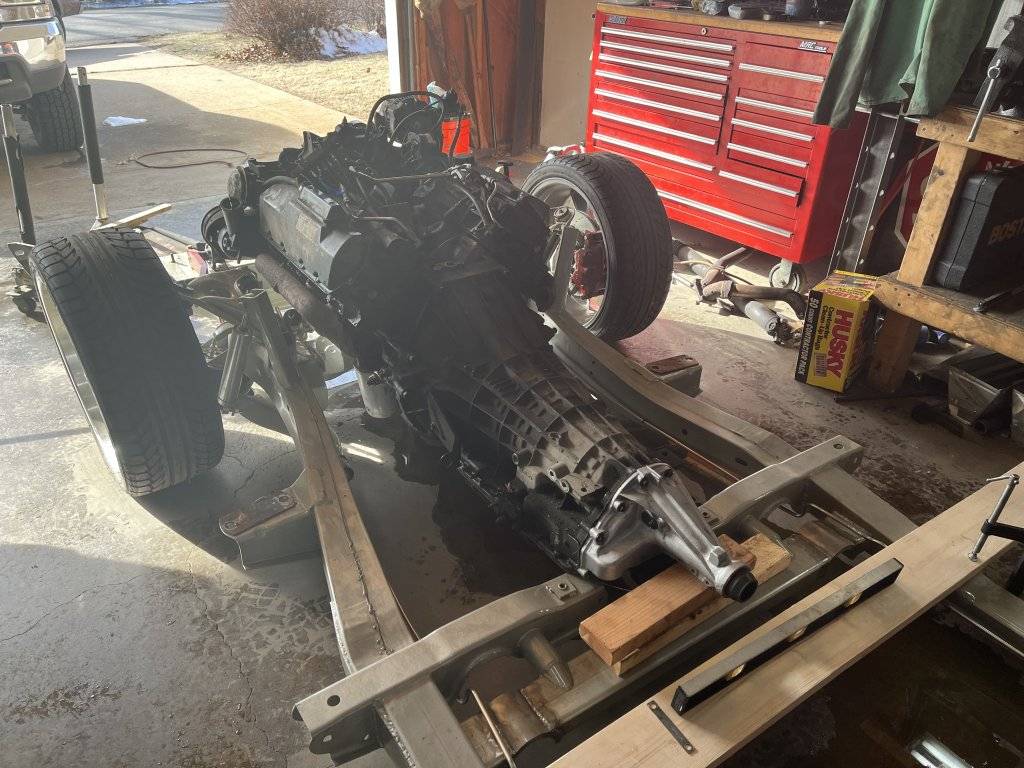

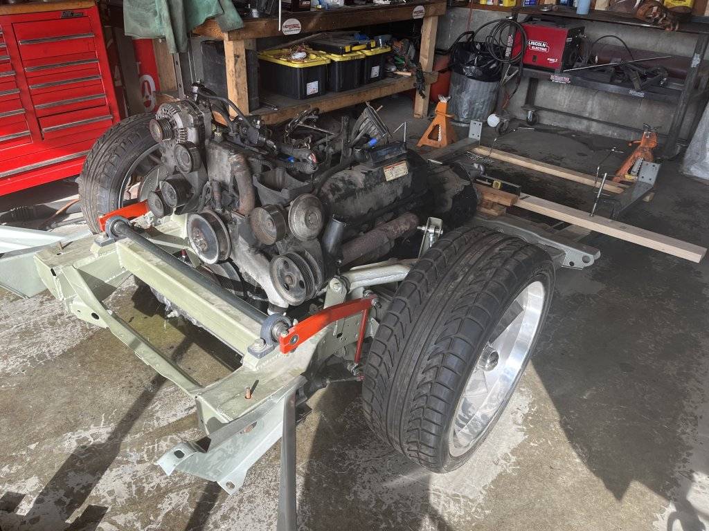

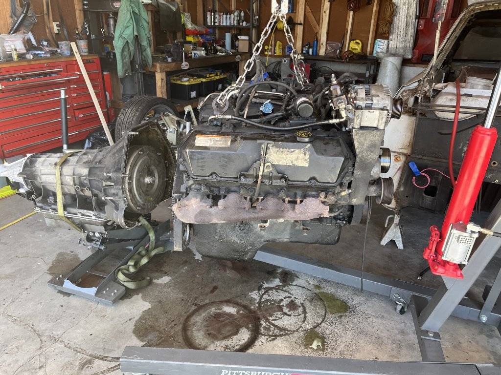

Finally got the engine and transmission set into the car, and oh man, it’s a tight fit. It’s actually pretty crazy how well everything actually does fit into the car, as well as how well a lot of my previous fab actually adapts to the engine and trans. Unfortunately I am going to have to cut out the stock crossmember, or at least trim it, but the bracing that I did on the back side of the car is actually almost perfect for building a new trans mount. Either way, now that it’s set and centered, I’ll start fabbing up my motor mounts and the trans mount, then I’ll see if I can’t fit the entire sub-frame assembly back into the car. There’s still a lot of stuff to tackle before she’s road worthy, but this is one step off the list!

First gen 7.3L right? Are you going to try to squeeze a intercooler in like the sec gen 7.3L?
Lol the short answer is sort of. Back when I had it built, I basically custom selected the strongest components within the first and second gens to create a more robust engine that could hold big power if I wanted it. The block is actually a 2000 block, but it’s got 97 forged internals, o-ringed heads, ARP head studs, etc. I’ve thought about sticking an intercooler in front of the radiator header, but the big issue I run into is that I honestly don’t need the power. Reduced EGTs from the intercooler would be a bonus, but realistically that’s more of a concern when hauling. The other thing is that Lucy would hit and hold 40psi all day long, which is slightly over the reliability limit of the stock intercoolers on the 2nd gens. On a set of mild street injectors, Lucy dynoed at 350hp and 800ft-lb at the wheels without an intercooler, so if I wanted more power, I can up the injectors since I already have the HP oil infrastructure to handle the increased volume of even bigger injectors. The thing I’m scared of is that if I put too much in it that I’ll actually bend something. I’ve heard rumor of folks sticking mammoth big blocks in C-bodies and tweaking the unibody, which is the last thing I want to do after all the fab that’s gone into it.
