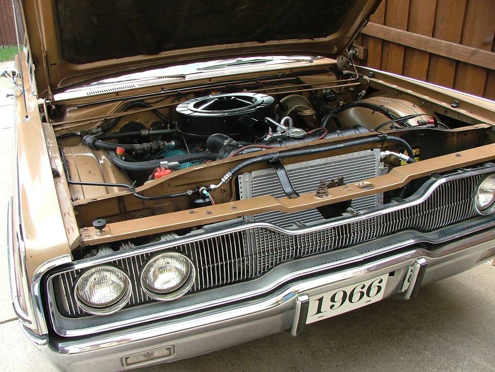

4 months have gone by and I am no closer to solving my A/C problem, I need some real expert assistance. If you go back to post #72 here you can read about my problem which is that my converted A/C system which worked perfectly for 2 years all of a sudden lost more than half it's cooling power last May. I checked the pressures and tried to add refrigerant with no luck. Everything else works fine, heater is not bleeding into the cooling vents, etc. Today I hooked up the gauges again at an ambient temp of 80 degrees. With the system running the low side read 60psi and the high side was 58. I hooked up a can of R134 and opened the valve, the low side jumped to 90 and the high to 125. I let it run for about 20 minutes, the low went up to 100 and the high did not change, I don't think any refrigerant went in. The chart for 80 degrees ambient says it should read 40-50 low and 175-210 high so it is way off. Has anyone had a similar problem? If so please let me know how you solved it.

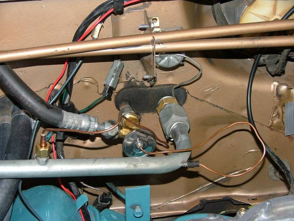

Have you tried replacing the expansion valve yet? I dealt with A/C this summer as well. The compressor creates the pressure, but the expansion valve causes the drop that separates the two sides. Try taking a temperature gun and measure right before and right after the expansion valve. There should be a temperature drop. Any small particles can get in there and clog it. If you have to replace it anyhow, you might as well give it a few whacks Fonzie style and see if anything changes.
I haven't replaced anything yet although the expansion valve has been mentioned a few times. I did tap on it gently a few times while I was attempting the charge with no effect. I actually have two expansion valves since I have two evaporators, the front was replaced with the conversion but the rear was not.
OK - after many months of lukewarm A/C, multiple hose manifold hookups, requests for help and frustrated confusion - I have apparently solved the problem! As is the case often with me and cars the solution hit me in the face and involved stupidity - and even though the practical results are great the technical results are still confusing.
Cut to the chase - the main reason for the too-high low and too-low high pressures and the failure to accept refrigerant was - wait for it - I forgot that the charge valves at the charge ports loosen and tighten THE OPPOSITE of the manifold valves. So when I thought I was opening a valve I was actually closing it, and vice-versa! A few nights ago I watched about 8 YouTube videos on A/C problem diagnosis and one of them - only one - mentioned this little fact. I pulled out my gauge set and looked, then hit myself in the forehead a number of times.
So today I hooked everything up again, turned the valves the right way and everything was different. Low side started at 10 and high at 125 with system on. Opened the R134 can and it actually went in, can got cold and the vent temps started to drop. It took over an hour but I put in nearly 2 full cans so it must have been quite low on charge. I pulled all the hoses off and took it for a ride - WOW! On a 90 degree day with just the front unit operating I drove for about 20 minutes, starting on max AC and high blower. I quickly froze me up so I dropped down to regular AC and medium blower, still too cold so down to low blower. Even at that setting it was plenty cold, I am pretty sure it cools better now than when I first did the conversion.
So here are the confusing technical results. At a 90 degree ambient temp like I had today, the low pressure should be 45-55 psi and the high should be 250-270. The actual readings on my gauges today were 35 low and 140 high when I stopped the charge. I can't explain it and as long as the system works I don't really care. Thanks to all who commented, I really appreciate it.

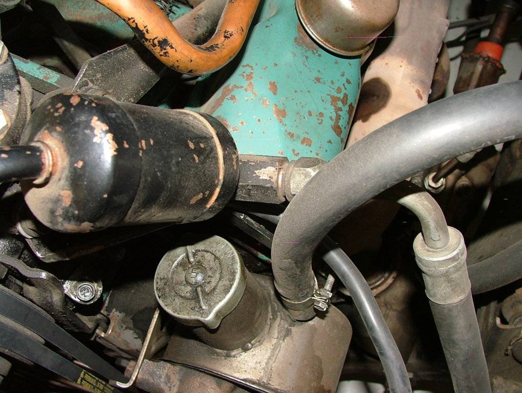

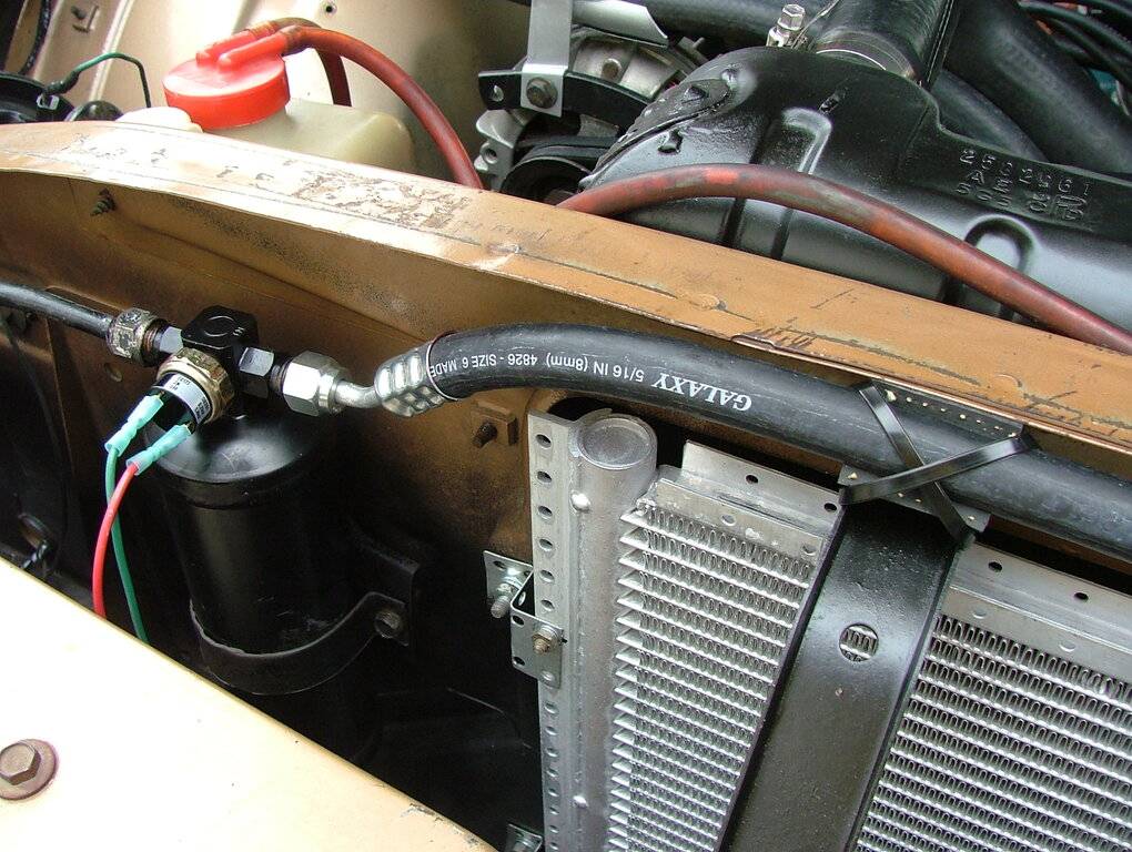

Thanks, I'll check the hoses, I'm also going to verify all the mode doors are working properly. The rear unit on these cars is always on when the front unit is activated, the only control is fan speed, but yes I had it on full blast. I did replace the filter dryer keeping it in the stock location and adding a pressure switch that was not stock. The sight glass is painted over. There is no obstruction for airflow to the condenser.
is there a part number or website link for the dryer and sensor?? my original sensor does not match the threads for the new dryer.
I bought the dryer on ebay, Four seasons 33317. Pretty sure the switch came with it.

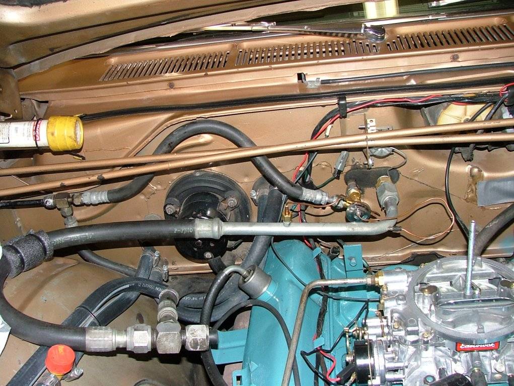

The only unconnected fittings are at the dryer which is mounted in the oem location. I made up a wiring harness connecting the thermo cycling switch to the pressure switch then back to the compressor, all 14 gauge wiring
@TxDon Can you explain specifically where the red and green wire go to once they leave drier/receiver. I think you said you added a switch that wasn't OEM so I'm not clear where those wires go/do when the original system didn't use that thermo-cycling switch. Thanks.

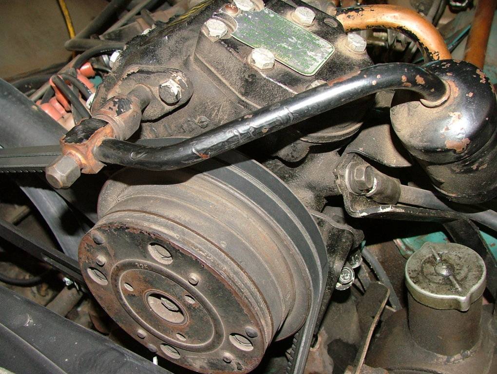

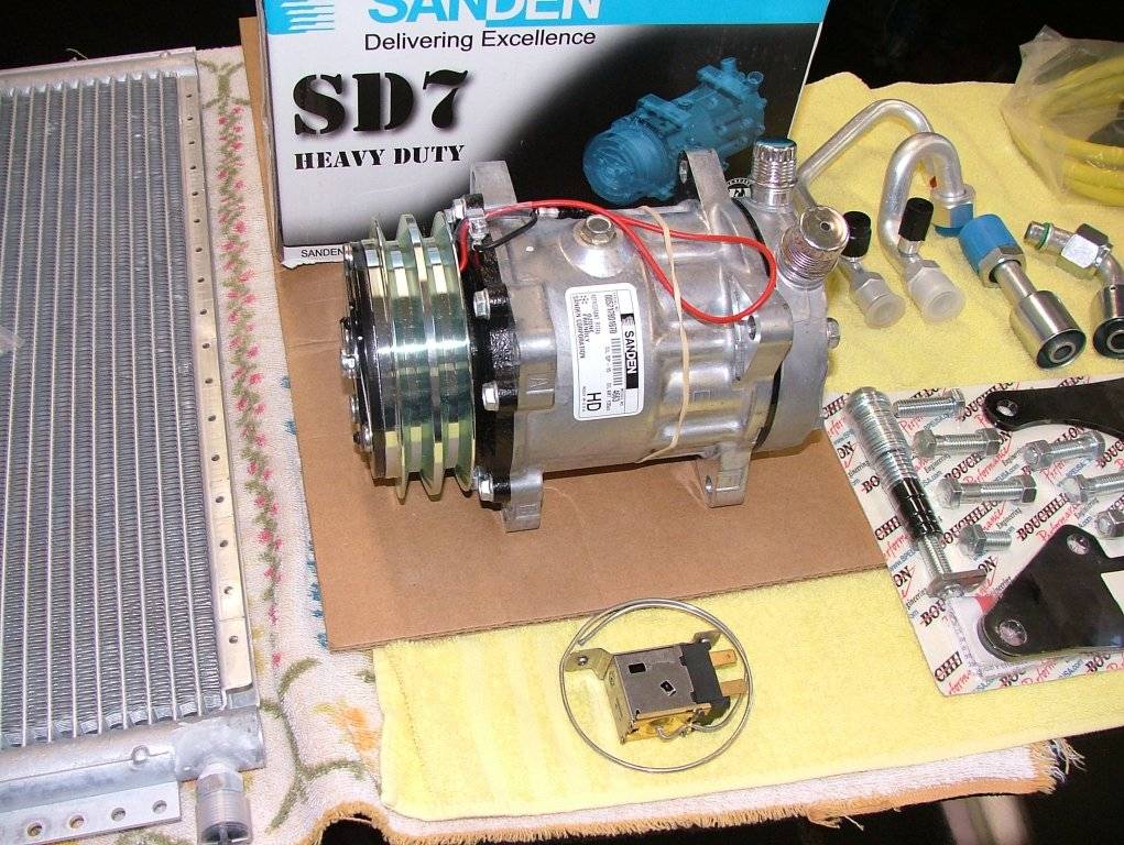

I added a thermostatic switch with a capillary tube on the firewall near the expansion valve. PN 119-9920 from Nostalgic AC Parts. Shown in the parts photo below the compressor.
