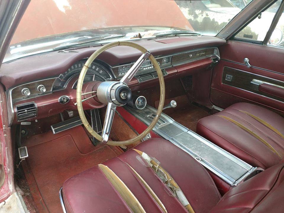

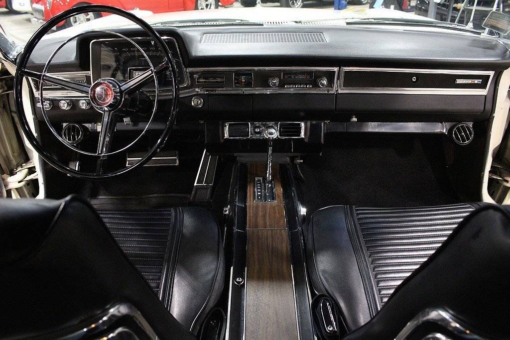

We spent most of the day installing a dishwasher for the Combat Commander. But afterwards, I snuck out to the shop to work on the donor console top from the New Yorker.
Here's a shot of the New Yorker (red seats) and the Fury (black seats) for comparison. Both consoles are the same with a different paint/finish scheme on the lids. The very top is a two piece so I tried to have the removable lid powder coated but the process lays down a thick coat, killing all of the detail and leaving the lid very boring. So I found some Mahogany Vinyl from these folks and decided to give it a shot.

Wish my fury interior looked like that!
