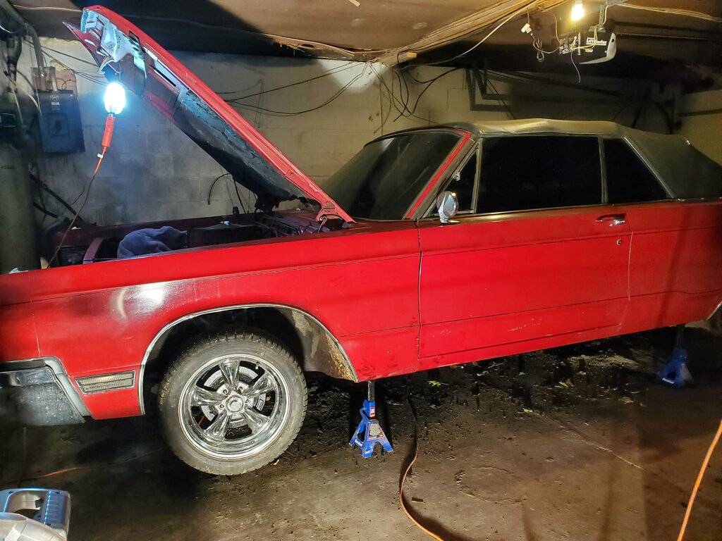

So my baby has been sitting in a garage for the last 10 years or so and has less than 40K miles on her. I am all over the engine but what about the tranny? Do I flush and add a new filter and fluid, what seals should I replace or should I have it rebuilt. Budget budget budget.

It's leaking pretty good up front near the Torque Converter and down plenty, I added 3 quarts just to get her to crawl.

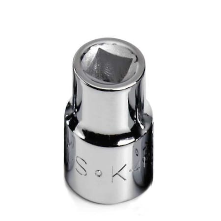

Getting an old auto sealed up tight is a project!! I just rebuilt my '66 727 and is was leaking from every place it possibly could. Dropping the pan is also a good way of inspecting as has already been written. Adjusting the bands is a simple process that can be done easily once the pan is off. One is on the outside and doesn't need the pan off at all. You need an Inch pound torque wrench and a 5/16" square socket. Yes. square!!
