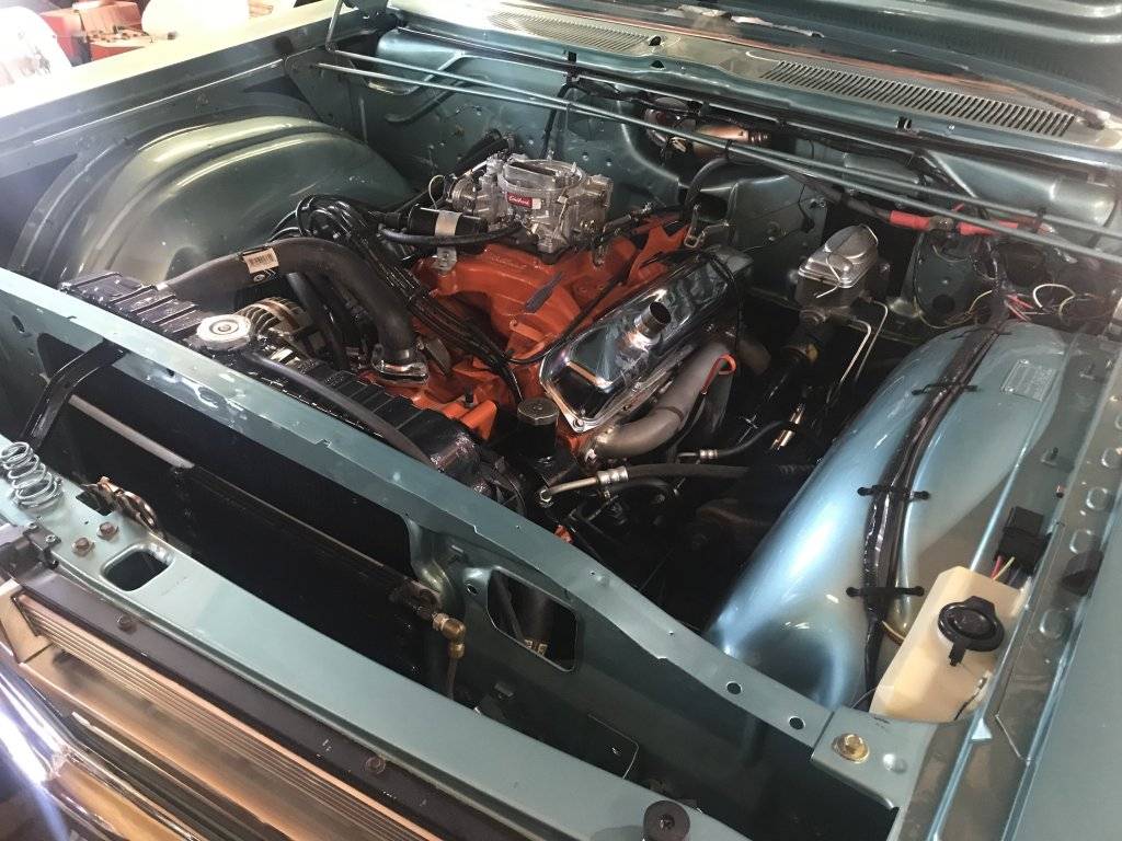

Hi Everybody,
Here we go again with having more problems with the car now. Today we decided to get it out for the year to get it ready for a show this coming weekend, and we noticed a small leak coming from the back of the underneath of the valve cover. This was not there when we put the car away last year. We decided to get it out anyway, and my stepdad decided to play with and advance the timing on the car then take it for a spin around the block…. Well, in my opinion that was a mistake. We took it around the block and it ran great, until my stepdad really laid into it and put his foot to the floor. When he did that the car started to sputter, pop, bang, and misfire. I even said what’d you do?! to him. We got it back home and he fixed the timing back to where it was before he messed with it the first time, then he decided to take it for another ride…. well this time it wouldn’t even make it outta the driveway without popping and banging so we put it away and let it cool off for awhile. After we let it cool off, we took the plug wires off and they looked normal and good EXCEPT for one. One of the plugs was really loose and was only finger tight so I’m personally thinking that this is the only problem, but my stepdad thinks differently and thinks that its something electrical and ignition related. As I said, its always somethin with this car. My stepdad says that the car has not brought him joy since he got it on the road and that he’s really ready to just take the stroker motor out and put a regular 440 in it. I don’t wanna give up hope on it, because I think its just something simple but I really don’t know anymore. Does anyone think differently than me or my stepdad? Tomorrow or the next couple days, we plan to tighten the spark plug then take it for another ride to see what it does.

Ok, I have an update. The car still runs horrible. My stepdad worked on the car. He says he tightened the loose plug then made sure all the rest of the plugs were good and tight, then he took it for a ride. The ride was good, until he decided to turn around and go home. He turned around and it died on the side of the road. Then when he went to restart it, it turned over slow and hardly wanted to start. He gets it started and the carburetor is on fire. He blows it out then brings it home and put it in the garage. This is all I remember him telling me. He says he’s done with it… the engine I mean, NOT the car. He says he’s so angry with it he’s going to take the stroker engine out, and put the stock engine in. His friend Rob (or @1968Chryslers) and I are trying to convince him to keep it and find out whats wrong, and that another friend of Robs can maybe come over and look at it. My stepdads other friend Kevin (or @jetboy) also offered to look at whats wrong with it. Does anyone else know what could be wrong with it?

Hi Bill, yes a new tank and unit were put in when the engine was. Fresh gas was put in last year when we put the car away, like we always do every year with our cars. There was a pop or backfire from the carburetor yes. We don’t use socks in our tanks. I just do NOT understand how your engine runs so good, and ours runs absolutely terrible when they were built by the same person at the same time.
Correction on my post 184: my stepdad says he retarded the timing on the car before he originally took it out for a ride.

Thank you for the information, I appreciate it. The car is on its 3rd carburetor, 2nd electronic ignition brain, and I believe 2nd coil. The car currently has a Demon carburetor on it, and a blue Rick Erhenberg brain in it too. I unfortunately do not know the cfm of the carburetor though. The cars wiring and distributor is also all brand new from what my stepdad says. I will ask him what else is new on it and what else was done. He says he’s not putting anymore parts in it though. I’m just tryin and really want to save this engine because of all the time and especially money spent on it, but my stepdad says he’s had it with it. He says he sold his Dodge HEMI Magnum because it gave him so much s***, but nothin compared to this car and he would rather have that car back. At this point, I don’t know whats next. I just hope its a simple, and easy fix so the engine can stay in the car. I will update on what he decides and if it gets fixed.
