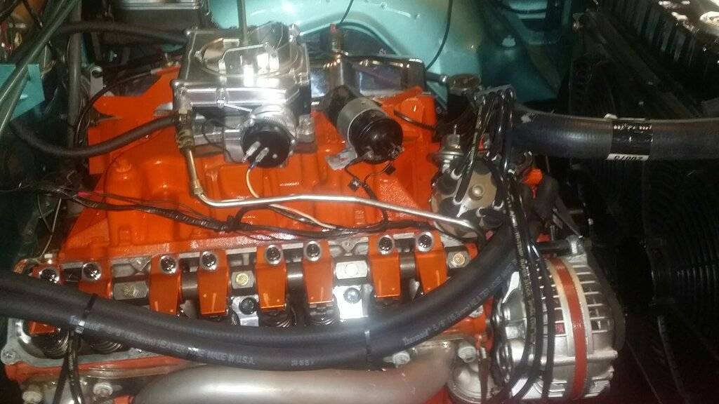

Hello All,
Yes another useless post by me but I figured I would give an update on the project. We performed a hot valve guide test last night on the 440 stroker engine on the left divers side valves only, no numbers were involved. Yes I told my stepfather it's not the valves it's fuel related but it was after we performed the valve test because he wanted to just to see. We did the test and it is not the valves (like I personally thought). We took the bolts out of the valve cover, started the car, and let it run to about operating temperate, shut it off, then took the valve cover off and did the test with a little bar and piece of wood. Just so happens nothing was tight, but I suggested testing the right side valves also anyways just in case but we did not last night but probably will soon. Also we tripped the starter relay, watched the left side valves, and nothing was sticking or anything from what we saw so we figured if it was that bad we would of thrown a push rod already. We talked to @FURYGT, a very good friend this morning and he suggested a couple things such as a performance fuel pump and line and a couple other things.
To expand and clarify on the above post, a new distributor from Rick Erenberg has been installed but the car has not been test driven. They are going to try bypassing the electric fuel pump to see if it is causing a restriction when off or an over pressurization situation when on. Discussed timing and vacum readings as outlined by 70bigblock dodge and a few other things.

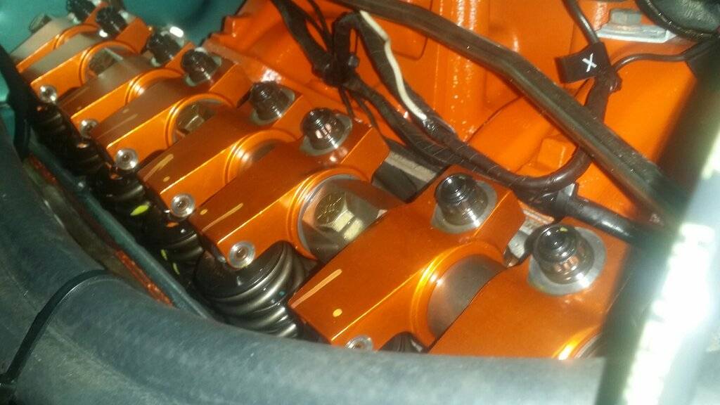

Hi All,
I have another update on the stroker Fury for everybody. We tested the right or passengers side of the valves this time to see if they stuck just in case, and just so happens they did not. We also put in another coil to test that and it did not change anything. That said my stepfather talked with FURYGT about the car and he suggested getting an MSD Blaster II from Jegs and a new HiRev ECU or brain from Mr. Erenburg (the same person who we got the distributor), and also a Holley Blue fuel electric fuel pump. So we are going to try the MSD Blaster and the HiRev brain, and if THOSE don't fix it then we will try the fuel pump then look into the fuel system.

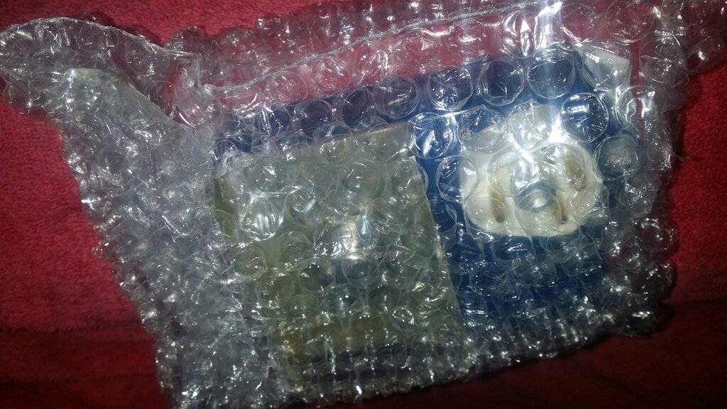

But wait there's more, my stepfather took FURYGT's advice and bought an MSD Blaster II coil and a new ECU from Mr. Erenberg. Which by the way these have arrived to our house. So the next thing we will do is put these in and see what the car does, and hopefully these will do the trick. I will keep everyone updated to what happens.....

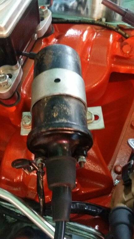

Not to say it out loud but I think we maybe getting somewhere with the '67 Fury 440 stroker engine, I got a bigger update than usual. As I mentioned in my last post, we bought an MSD Blaster II coil and a new HiRev 7500 brain from Mr. Erenberg that Mr. @FURYGT recommended. We put the Blaster coil and MSD ballast resistor in, then we WERE going to put in the Erenburg brain BUT we read the instructions first. Good thing we did too, as the brain was not compatible with the MSD coil. According to the instructions the brain needed to be run with a stock coil, so that said we took the MSD coil out BUT left the ballast resistor in then put the brain in.
NOW, we start the car and let it run for about 20 to 25 minutes and it ran very good. Better than it normally does to be honest. We put it in gear while the car was sitting in the garage and normally it dies BUT it didn't this time, which was a good sign. We did this about 2 maybe 3 times and still no stalling. So NOW we take it out for a test drive in the evening when it was cooler out than during the day, we took it to get gas and back home which was about a 10-15 minute drive going and coming back and it ran flawlessly with no stalling. We let it sit at the gas station while we filled it up and let it heat soak, it started right back up with no issue. We are not out of the woods yet though, the true test will be taking it out during a hot 85-90% day and seeing what it does but for now things are looking up for this car.
Sounds very promising. I think the distributors that you were using were no good and the high performance module helped give the spark that the 520" needed. You may want to ask Rick E. why a stock coil is needed with his high performance module. One would think that a high performance module would need a performance coil.

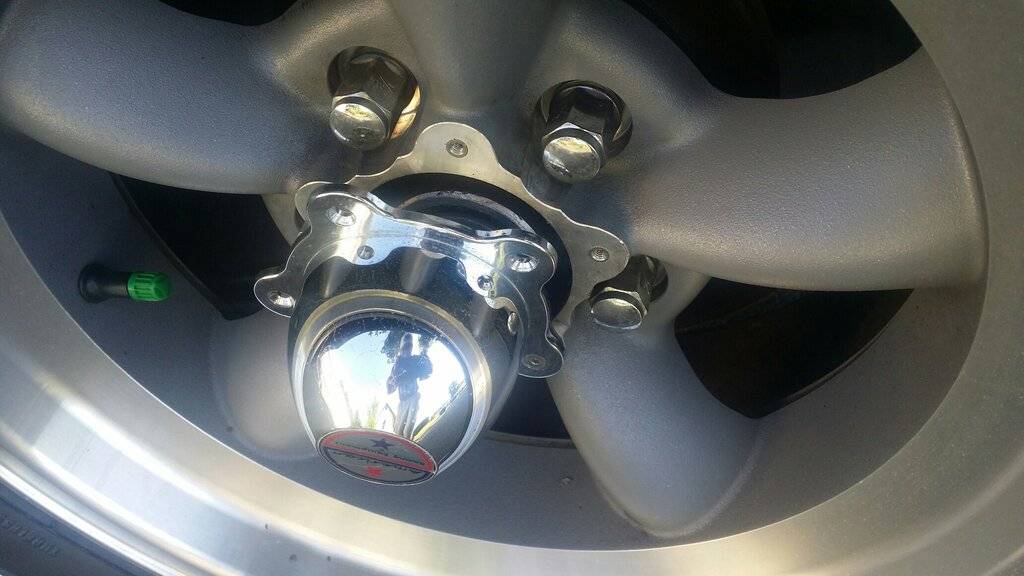

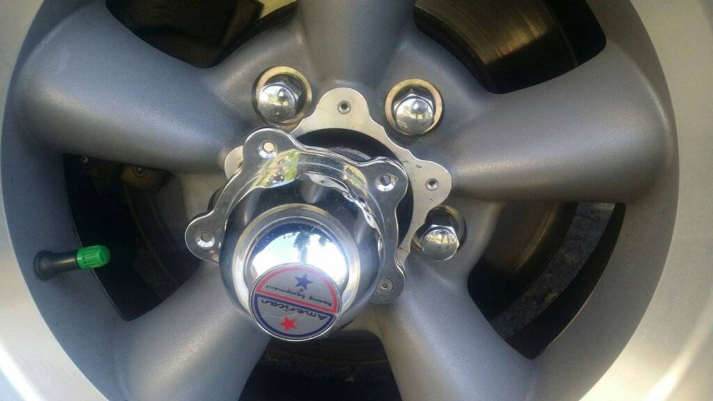

I got an update on the '67 Fury II with the stroker 440 engine. We had some good and bad things happen to us today, and I swear this car MAY be cursed or something. We took it out for a test drive today in the 80 degree weather and it performed great with no stalling. We got it up to 110 MPH on the highway as a matter of fact too.
The Good- we took it out for about an hours ride and the temp got hot and nothing bad happened,
However.......
The Bad- the little hub cover on the rim was hanging off by a thread with only one screw and we heard it on the way home flappin' around and were like wtf is that now. Mind you this was just fine and tight the other day. The other bad news is..... the freakin' heater core is now leakin' so now we gotta get one from RockAuto and fix that. I swear it's always somethin' with this car.

I admire your tenacity. You're getting there and the car is so worth it.

Hi All,
However.......
The Bad- the little hub cover on the rim was hanging off by a thread with only one screw and we heard it on the way home flappin' around and were like wtf is that now. Mind you this was just fine and tight the other day. The other bad news is..... the freakin' heater core is now leakin' so now we gotta get one from RockAuto and fix that. I swear it's always somethin' with this car.View attachment 387220 View attachment 387221 View attachment 387222 View attachment 387223 View attachment 387224

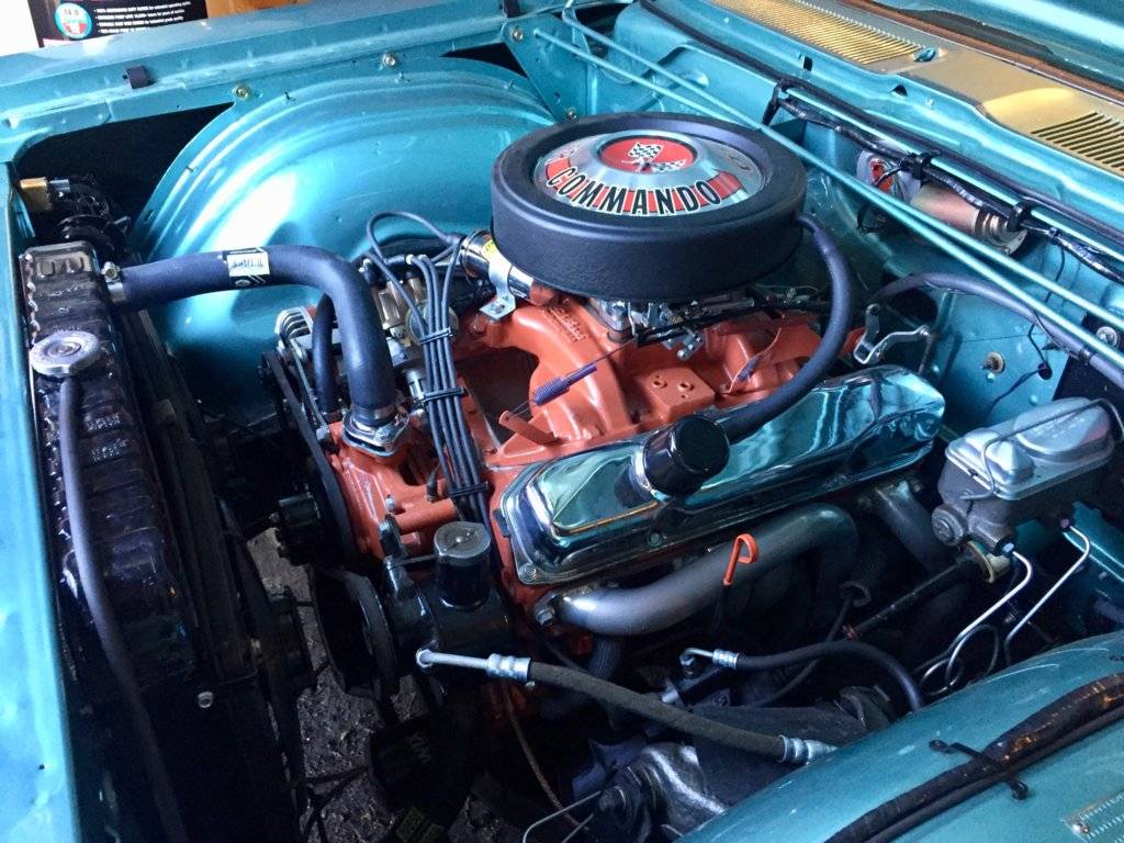

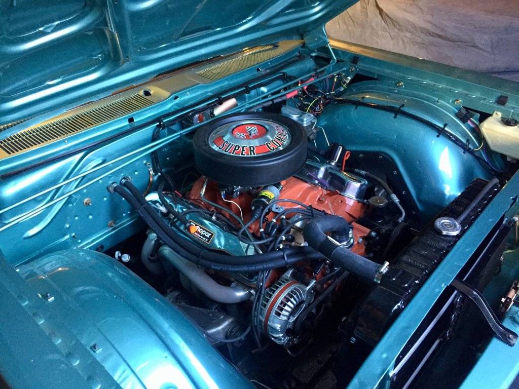

I was having similar issues. Silly Mopar engineers put the coil in one of the hottest areas of the engine and tipped on its side. I moved the petronix coil to the lower fender and put it upright where it gets plenty of air from the fan. I also bought a 1000 CFM thermoquad and wrapped the fuel line except near the fan. I added cold air setup which is a noticable difference above 80 degrees. I bought a new OEM fan and clutch, covered all the places air could escape around the radiator so all air has to go through the radiator now. Since then, I've never had any stalling, hesitation or overheating problems since. However when sitting for a short period of time, temp gauge goes above 250 degrees. Still starts and goes down to 210 within a minute but I'm going to add an electric fan later this year. I just want it to run correctly so I guess my issues are easier to fix than high performance engines
I'm not interested in going fast since almost every new car today is faster than 60's muscle cars. (Kia's 4.9 seconds 0-60, Hyundai 5.2 or just announced last week, Ford's 2021 1400hp Mustang...That's just crazy (almost as crazy as going 110mph in a 53 yr old car...hee, hee!)
Lets see the other end of your cold air intake system. I like it.
