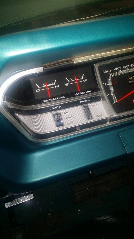

if all they have is the gauge as an indicator, then they need to do a bit better. what's shown looks hot and should be confirmed.
by their post, misfire does not occur at temp A, but does occur at temp B. putting numbers to this might help.

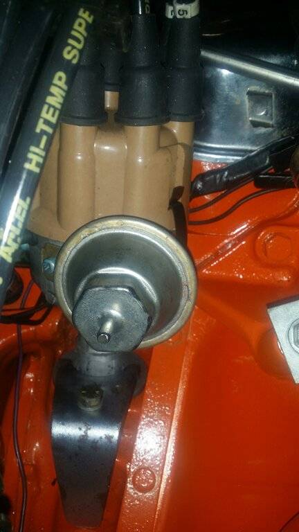

I think that there are/have been 2 problems. Too little clearance with the piston ring to cylinder wall clearance, which the honing should have fixed and second, some type of fuel or spark issue and I would bet that the 2 Mopar Performance Distributers used are junk and that another distributor that is not a MP brand will fix the problem.
OE Chrysler use a good used one and clean and lube. Or just call /contact Halifax shops for a reman.

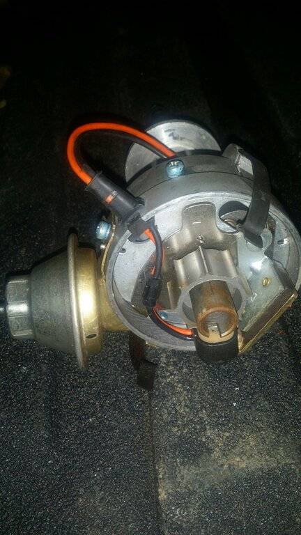

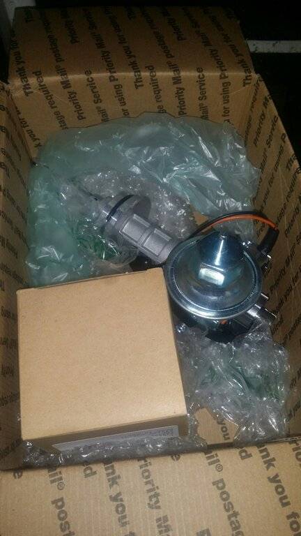

Hi Everyone,
I got a little update on the '67 Fury stroker 440 project. This evening we put in another distributor, this one a built to spec 440 Commando and not a performance one. It did help a bit, as it has a less advanced curve than the Mopar Performance one that was on the car. We also took the timing with a timing gun before and after we swapped the distributors before starting the car and letting it run, which was the same both times. About 10 degrees. It ran a little better with the new distributor, seemed like a little longer also. We let it run about 15-20 minutes after swapping distributors and got it to operating temperature, put it in gear, and it did die but it also did start back up right after with no issues. Otherwise that was mainly all we did for the evening with it. Unless someone has any other opinions, at this point we are suspecting tight valve guides and we will check them next time we work on the car. The first 2 pictures are of the "old" distributor, 3rd picture is the new distributor in the box before we put it in.

Pictures of distributors do no good. A picture or video of a vacuum guage on the engine running would speak volumes.
swapping known good ignition components from a good running engine/vehicle would
Yes, but I know what a distributor good or bad looks like. What I don't know is the vacuum reading at idle at the 10 degrees, or what it is a 15 degrees, or at 20 degrees. Then some educated guesses of where to go next or if it rattles real bad at 3000 rpm with the initial set on 20 andt is higher vacuum then we will know that the curve needs shortened.
