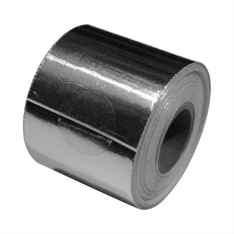

Vapor lock.
Several things you can do.
Wrap the fuel line with heat barrier wrap.
Carb insulator kit.
External electric fuel pump.
The coil could be bad.... swap it with another one to eliminate that possibility.
I do think the fuel is boiling and changing from a liquid to a gas and causing your problem.
