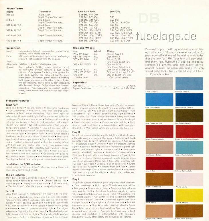

Also, what rear end is in your car? Is it an 8 3/4" diff, if so, is it original to the car? Just am not sure if the /6 cars had a different rear end to V8 cars? Note according to the factory brochure, 3.23:1 was the standard rear axle ratio in a /6 car, with 3.55:1 optional:
http://www.fuselage.de/ply69/69ply15b.jpg
For the 1970 model, 3.55:1 was the only rear axle ratio in a manual Slant 6 Fury:

Hi Aidan,
Yes it is a manual steering car and it is a chore to drive in tight spots! the big block and the stick means you're gonna get a work out parking the thing! lol.
The rear is an 8 3/4 with 2. 76 gears. I am not sure if it is orig to the car or not though.
I do want to swap in 3.23 gears.
Mike
I am surprised that 2.76 gears would be on a /6 3 speed on a Fusie.
That is a lot of weight to launch.
Recipe for a new clutch at least once a year in my opinion.
Yes, get the 3.23 in there!
