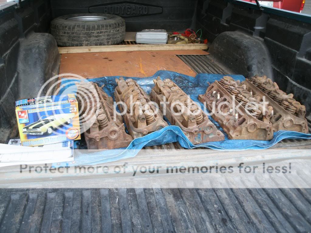

Stan, I had to get something out of my truck, took a few pictures and got some numbers. All 5 have 2.02 Intake Valves and 1.60 Exhaust Valves.
I hot tanked them, the rust is surface, if you wipe it with a damp rag it comes right off.
Nick
