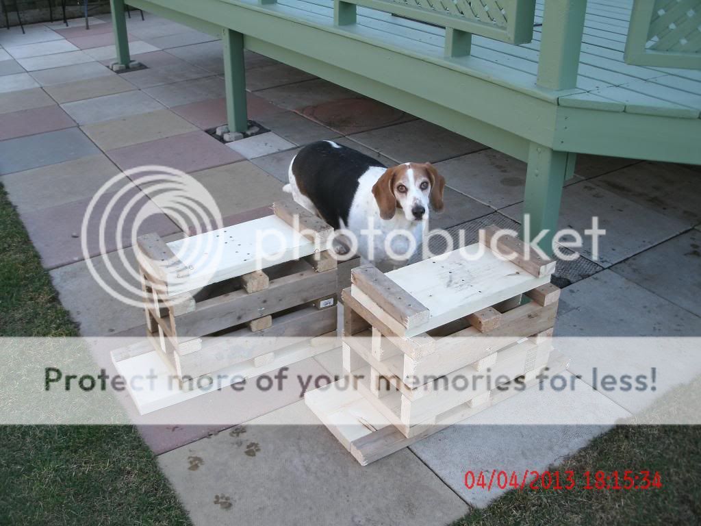

Blocks built, was surprised at how sturdy they are, took them to work and put a Silverado 3500 dump truck's front end up on them, no cracking, nothing, held the weight no problem. Will get the car up on them at some point this week.
My Beagle/Hound approves
now I see why you were so interested in the blocks my car was on :happy3:
Nice job on the blocks I have thought many times to do this.
Thanks, Came down to necessity for me.

holy jeesus rust.... don't stop now! say,, whats the specs on those wood blocks? that looks pretty handy
Believe it or not , I've seen a lot more rust on vehicles that were licensed and on the road. Scary stuff.
The wood blocks are fairly simple, required materials;
1- 2"x10"x12"
3- 2"x3"x8"
3- 2"x4"x8"
and around 150 or so 2 1/2" Deck screws.
The over all length is 30", the over all height is 15", and the actual structure measures 24" long, 13" High and 10" Wide if I remember correctly.
...and how the hell did you get the car up there on them ?
Floor jack and lot of patience..................................and a change of pants...............
