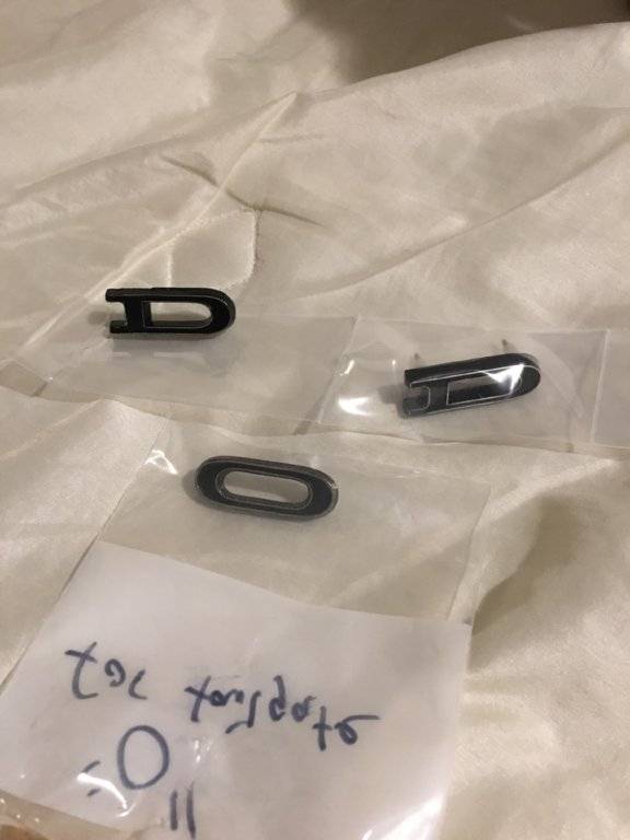

So I have two "D's" and an "O". The "G" is, thankfully, still on the car.
All I need now is an "E".
"Pat, I'd like to buy a vowel please....oh Vanna...?"

Two "D's" came from National Moparts out of Canada. Murray Park had the "O".
