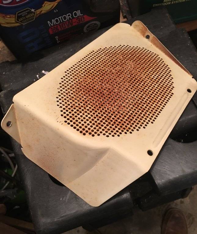

Rainy Saturday project. Naval jelly and rubbing compound on a speaker cover...before and after...
Elbow grease + rubbing compound versus junkyard untouched (more or less)

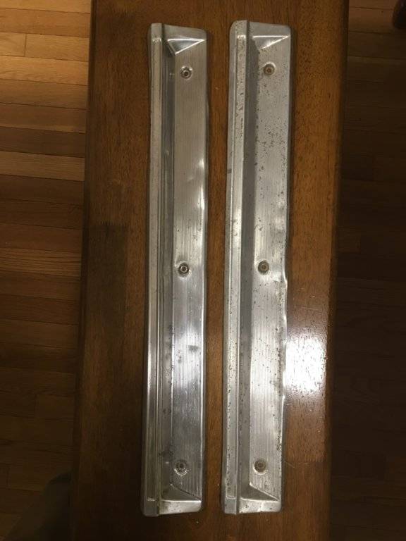

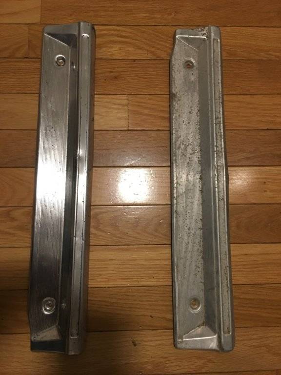

Front doors sill plate....still working on them...not an expert at banging out dents...

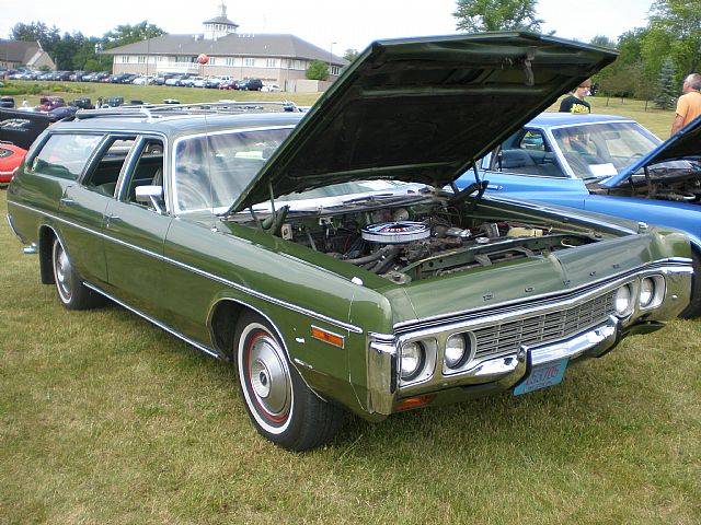

What is that? A 70? Is it a Polara? I don't know all the models that well.
Thanks for thinking of me. I really would like some cargo area plastic and some new rubber step bumper covers. I get the feeling I am going to have to go to major swap meets for those.
You're welcome, yes I believe it was a 70 Polara. One of my steps has chewed up rubber also.

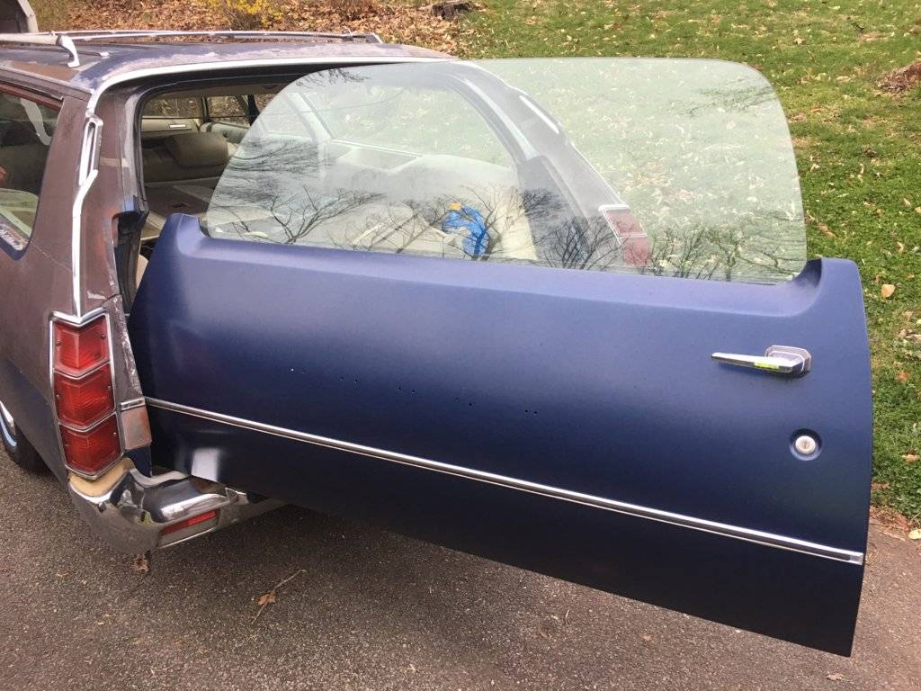

At the shop. Tailgate getting some attention. So happy to see it down to bare metal.
Progress. Tailgate returned to serviceable state. Semi gloss for now. Letters later.
