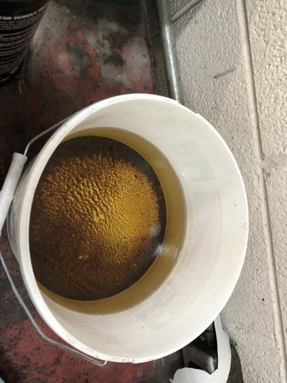

Well, the shop did what I was going to do...run the inlet fuel line off the fuel pump from a jug of gas. And when they did that the car ran just fine. So they are dropping the tank, cleaning it out, making sure the lines are cleaned out too. The inlet 'sock' mesh filter was clogged too. And the clear filter at the engine was evidently dirtier up close, than it looked to me from just looking under the hood. Even the fuel pump had dirt/varnish sludge build up. So when I get it back it should be good to go. Lesson learned.
What came out of the tank. Some varnish and some whitish looking deposits. They are sealing the tank (yay).

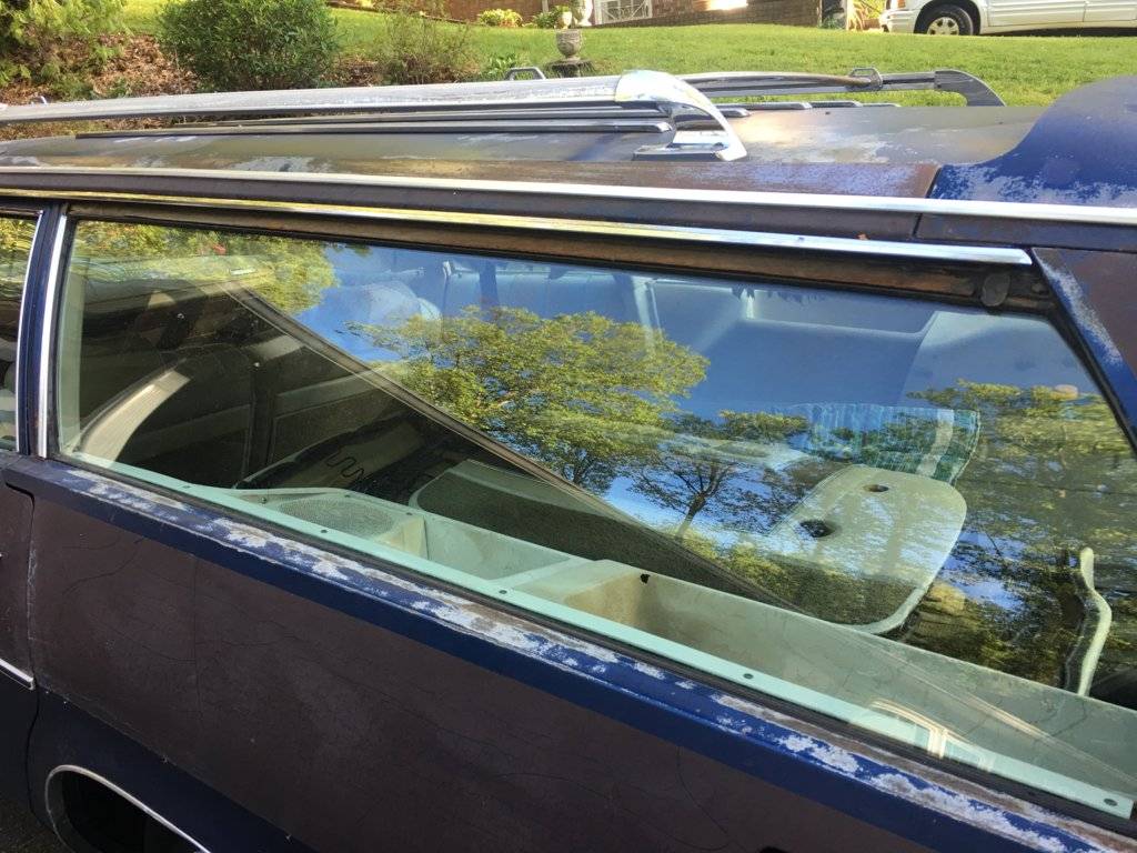

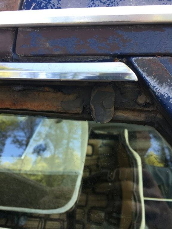

Took a rear quarter window painted trim strip off. It had some surface rust so I want to fix that now. The stainless trim under it was a friction fit which popped off very easily.

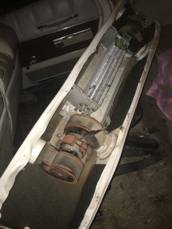

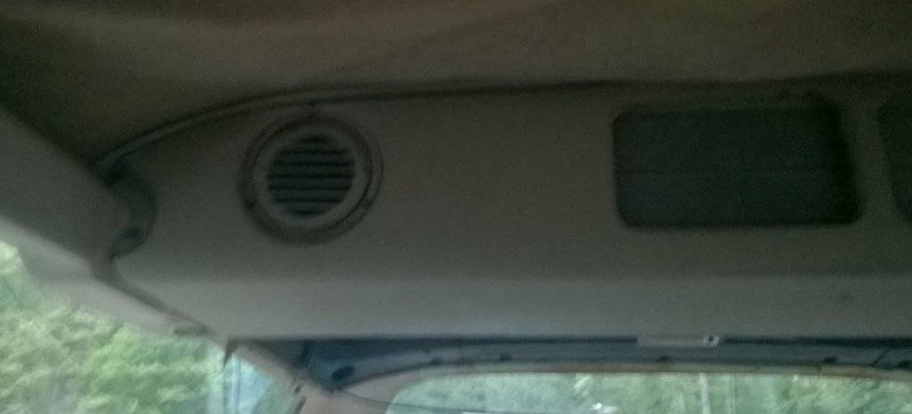

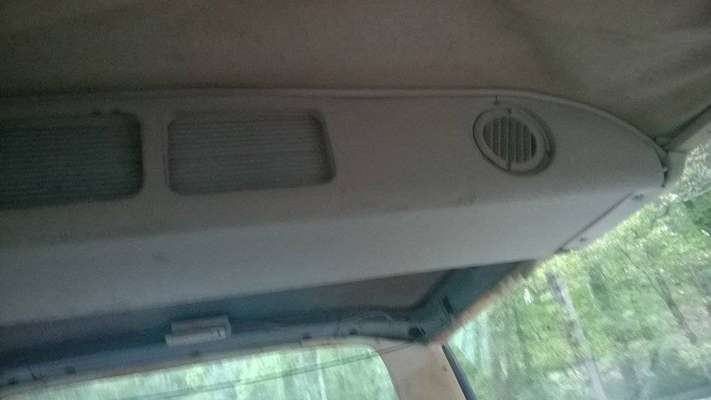

Want to clean the overhead A/C unit over the back seat area. This shows how it looks (both sides).

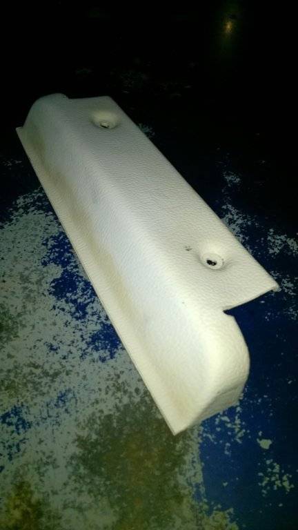

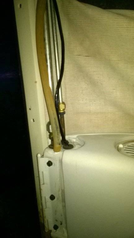

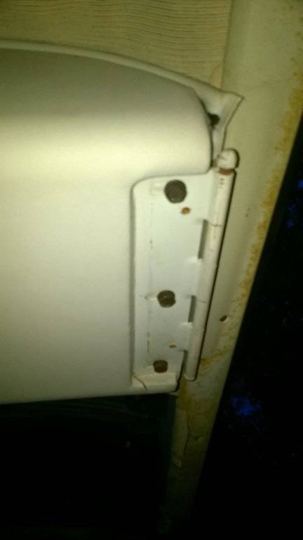

Removed the ABS end cover panels. Passenger side has coolant lines going to it. This thing is really stout. I can tell I better be supporting it well when I loosen the big bolts I uncovered, cause this assembly looks heavy. Looks like it belongs on the roof of a Winnebago. Way to go Airtemp. Note the hinges(?) at either end, presumably for serviceability.
You're thinking: could I mount this in the roof of a stretch limo Imperial, and ride down the highway in ultimate 70's luxury?
BEHOLD....the mighty twin-motor quad-squirrel cage climatizer....the mystery revealed! Uncovered like King Tut's Tomb, unseen by human eyes since 1973....
