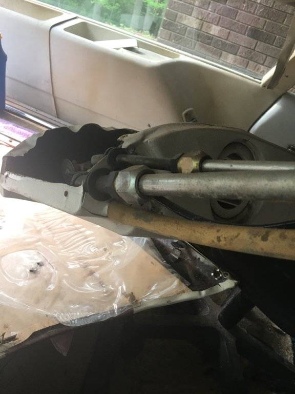

Where did they run the condensate drain???
Astute observation. It's got one coming off the tray. Hidden from view...here's a pic...it's the silicone looking line...

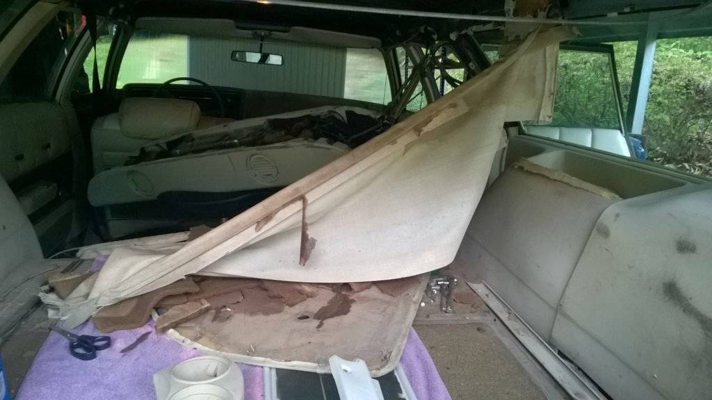

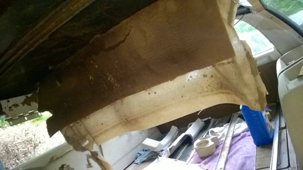

I cleaned the internals up with a vacuum and sprayed some anti rust aerosol around some surface rusted items then sealed it back up and re-attached it to the roof, but not before I ripped down the last remaining vestiges of the headliner. Good bye and good riddance. There was an insulating pad that went between the unit and the ceiling. When I get a new headliner installed I'll have to make sure it gets that.

Those odd shaped plastic cover panels you see lying on the cargo area floor are what hides the A/C lines from view.
