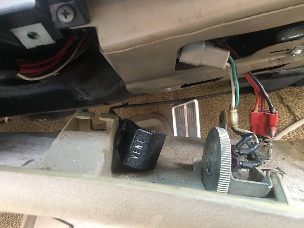

Speed control looks better too, believe it or not. I scrubbed on it a bit. Maybe my pal 70SportSuburban can dig up a slightly used plastic chrome knurled rotating switch in better condition to replace this one and doll up the interior a bit more.

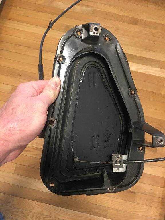

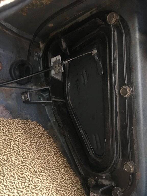

So I procured from him the junked out RH vent and cable. Today I installed it. Photos following.

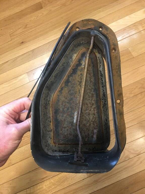

Rusty cable. I put some naval jelly on it, since no one wants a cable to break....

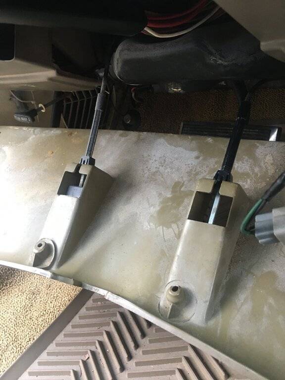

In with the new to me RH vent...NOTE...you have to “fish” the RH cable over top the plastic duct that is at the drivers RH knee...I suspect the RH vent may have been an AC delete item...ya get one or the other...?
And...after all that...just to make the really uptight people go crazy, the word “VENT” is stamped in two different locations, on either control.

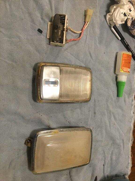

Looked up at the nice new brilliant white headliner and noticed the dome light (in the middle) looked like 5 miles of bad road. I thought at some point I had taken care of this but apparently I missed this detail. I found a plain Jane dome light in a 72-ish Newport coupe (on the bottom) so I’ll clean up the bezel on it and swap it out. And, sadly, I broke off the black switch tab today, in a moment of carelessness. So, time to work on fixing...

You know, I think you could vinyl wrap the bezel in chrome wrap. I've done it before
Not perfect, but much better...I think I have a vintage 70’s can of Turtle Wax chrome polish around here somewhere...
Really? Didn’t know they made it. Tell me more please!
Yes, they make it. You gotta buy quality stuff (3m, avery, kdmp)
All you'd do is cut slightly bigger than the bezel, cut the center out, at starting at one corner, slowly heat with a heat gun, and it will shrink, and you can push out wrinkles
Ok. A little elbow grease. Gobs better.
I love doing this kind of stuff. It’s all handwork and not much brainwork.
That’s cool. Makes sense. They have every other kind of wrap, so why not. I think the wood wrap on my car is Avery. Thanks
