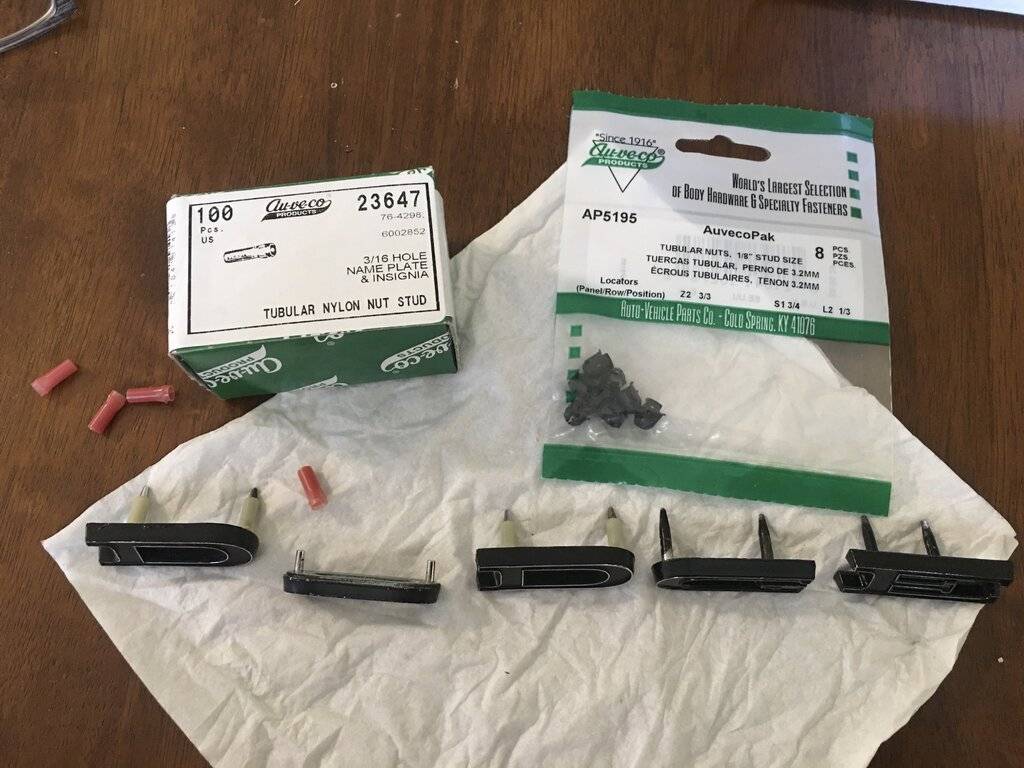

Auveco tubular nuts for the tailgate letters.
23647 looks a lot like the originals on the letters with tall studs.
The other nuts I ordered were just too big.

One down, four to go. The attachment method is not a good design.
Anyone alive today who remembers old cars with letters “back in the day” knows they have a tendency to get loose and fall off over time. I will be watching these.

Oh no Steve. I had some of the letters separately from junkyard. A couple are NOS from AZ.
The Auveco fasteners are what goes on the back.
