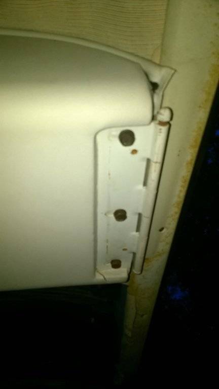

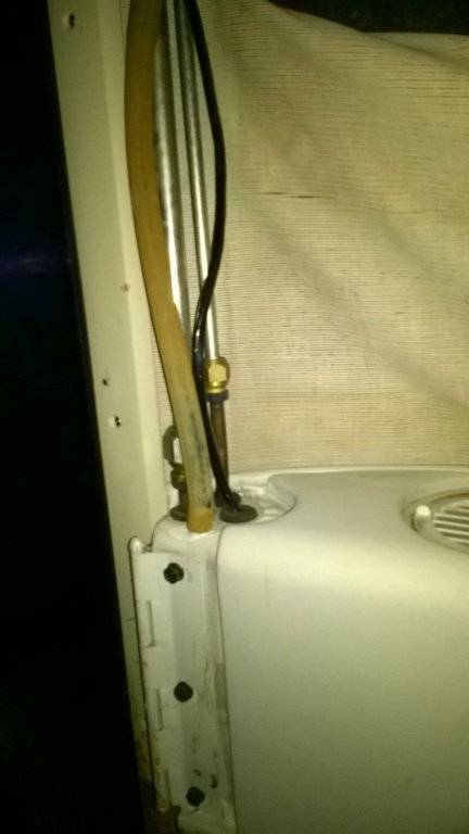

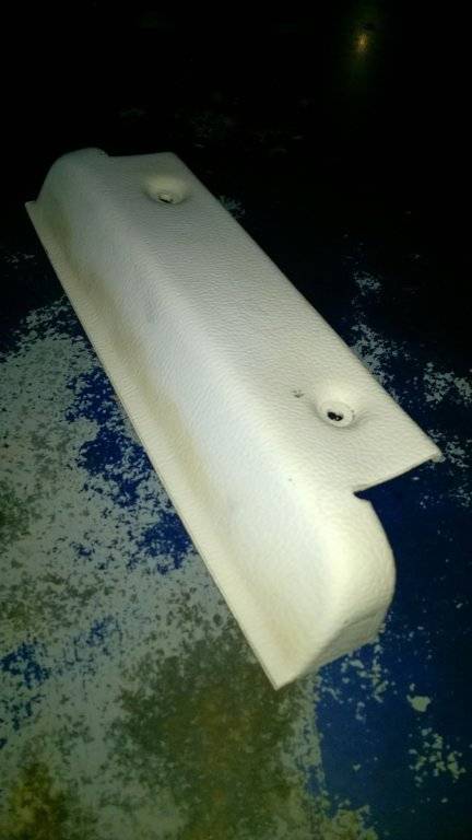

Removed the ABS end cover panels. Passenger side has coolant lines going to it. This thing is really stout. I can tell I better be supporting it well when I loosen the big bolts I uncovered, cause this assembly looks heavy. Looks like it belongs on the roof of a Winnebago. Way to go Airtemp. Note the hinges(?) at either end, presumably for serviceability.
