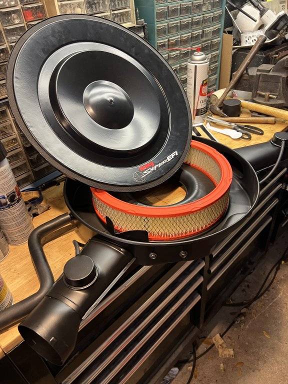

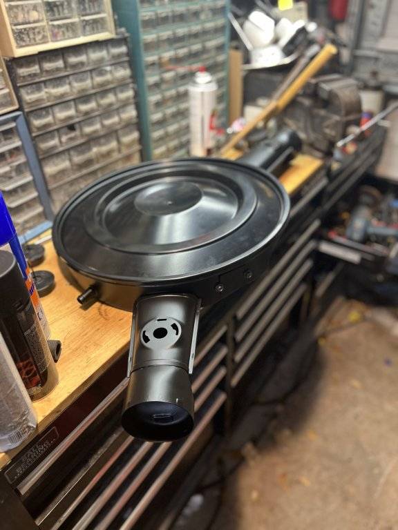

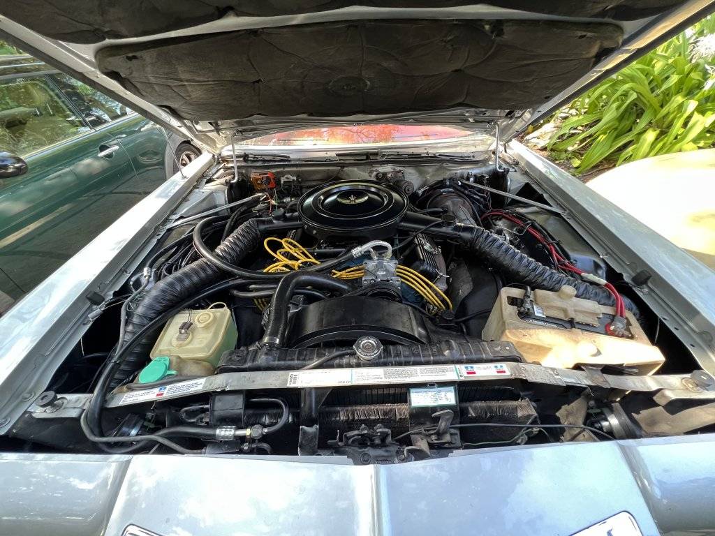

Dual snorkel fresh air! The second hose finally arrived! Both are NIB replacements that match the original perfectly…. Down to the same imperfections.
Just like the factory only double. The fresh air, under normal load, comes in the same way as any other ‘78. But when the vacuum drops, the other snorkel comes into play.
Cool and very functional. Without cool air, the engine would ping. With the single snorkel it would only ping if I mashed it…. A little. I’m not crazy. With the new hose… mucho better. Even increased the timing this morning and…. Wow!
Car came back Tuesday with the slip cured. So I finally got to mash it a little.
The rear end on this thing is all about highway. Engine turns about 2300 at 70mph. So I guess it’s a 2.71:1 or lower rear end. I don’t know.

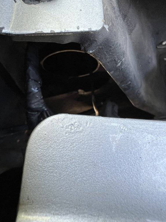

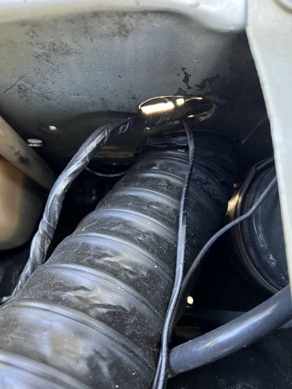

Here’s the engine side of the yoke placement. It was one of the reasons I pulled the inner fender to paint it.
Here’s the other side matching the original opposite placement.

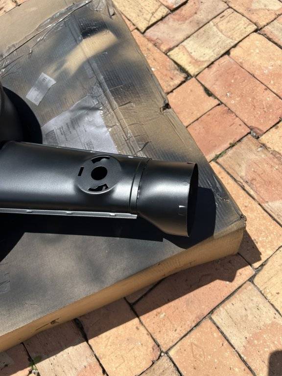

First I got a dual Snorkel with the oval ends. I had no idea at the time that they would fit exactly with the fresh air adapters I scavenged off two original air cleaners I got. The original oval air horns a press fit and pop off with a little persuasion. I had to carefully drill it the spot welds holding the adapters.
After much careful pounding with a body hammer I was able to make them fit exactly.
An exact fit.

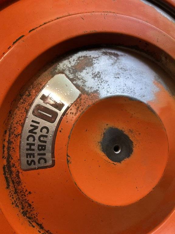

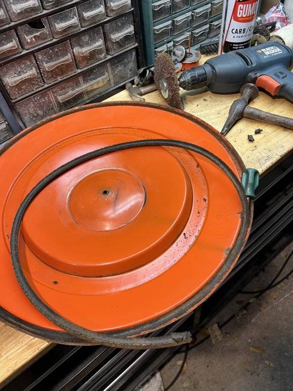

Unfortunately, the lid was so far gone it wasn’t worth my time to refinish it.
I even got a new seal for it… here’s the old one coming out. Next post….
Continuing….

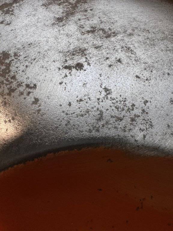

It was badly pitted.

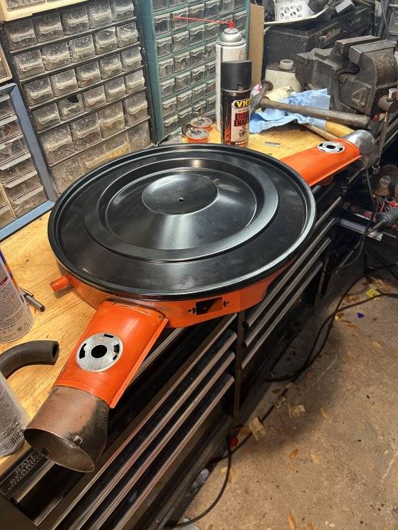

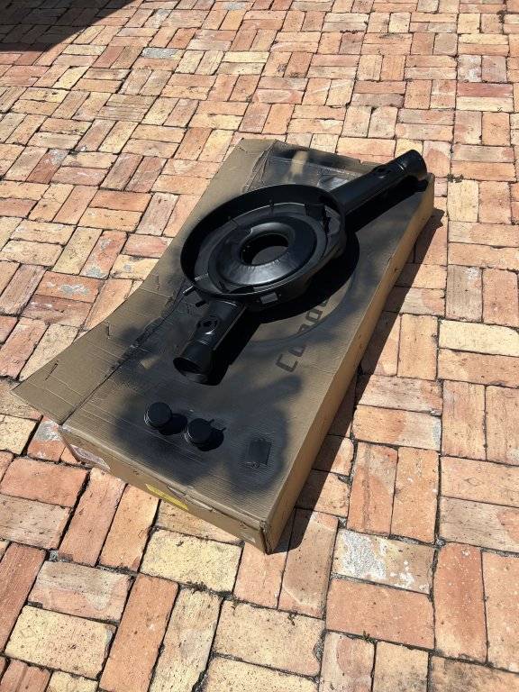

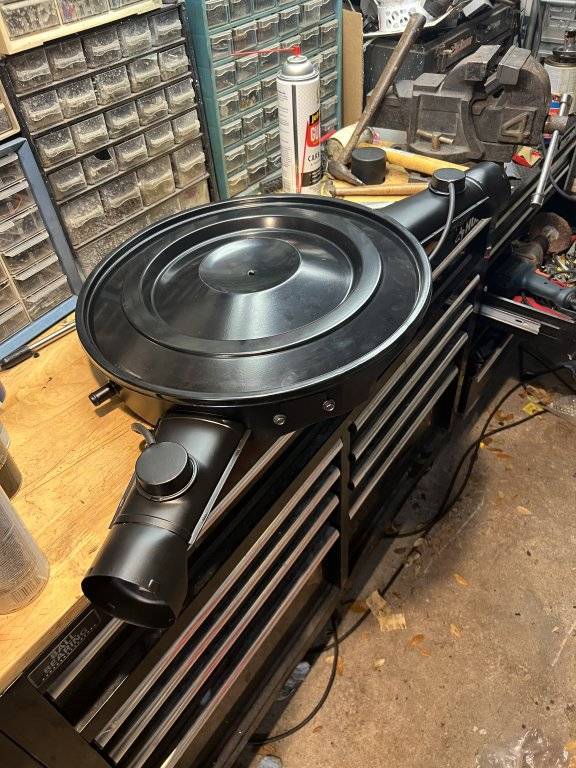

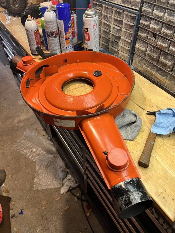

Paint goes on… satin black to match the lid. I found that rattle can paint goes on smoother in the sun when the humidity is up. It’s always at least 75% humidity here in South Florida.

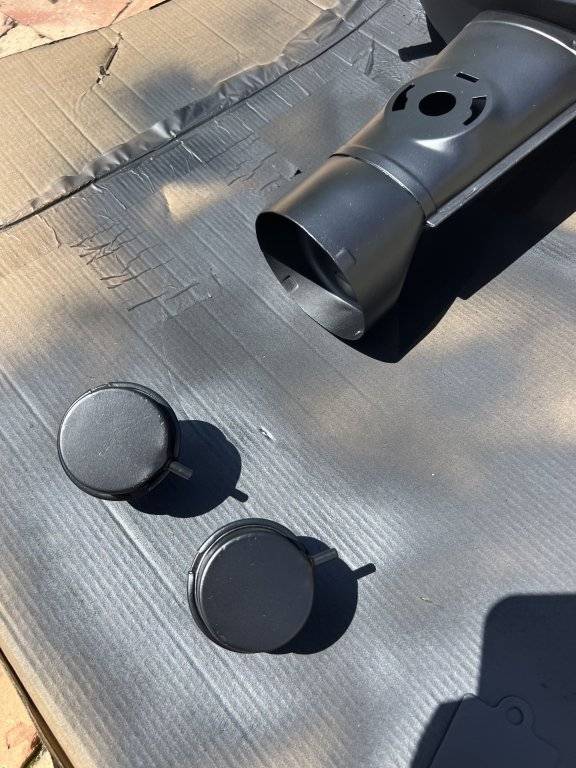

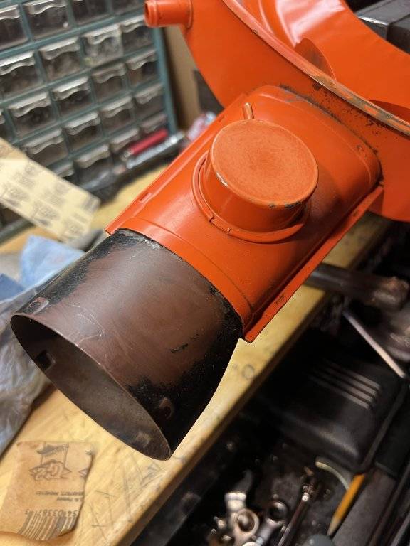

And yes I took it all apart to paint it. Here are the baffle actuators. In case you’re wondering, it took two full cans of high temp paint to cover it with three coats. In the sun, the paint dried fairly quickly. First coat was more of a base misting for coverage not depth. Gave it 30 minutes before I came back for the second. This time for depth and complete coverage of the base orange. I again waited another 30 min before hitting it a third time for smoothness and depth. Very happy with results.
The hose adaptor ends were a very tight fit. I ended up using high temp epoxy to make sure they were even tighter. I had to tap them on with a wood block and rubber mallet after starting by hand.
All painted and about to be assembled.
All together now except for the hoses.
And here’s a little graphic appreciation of the Holley it will go on.
All done.

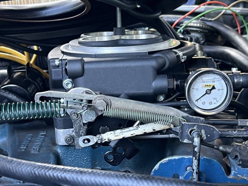

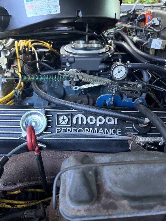

Adjusted the kick down…about 3/16” of slack removed. Much better.
As it was
And as it is now….

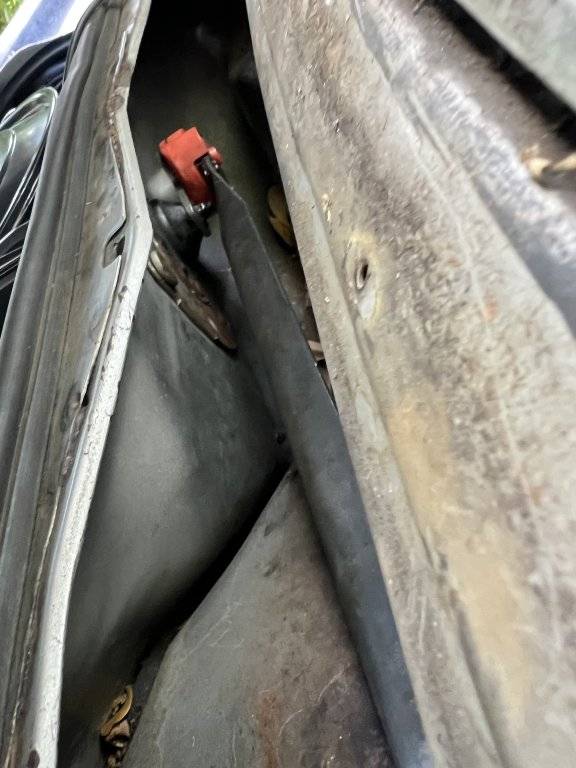

Fixed the damned wipers… again.

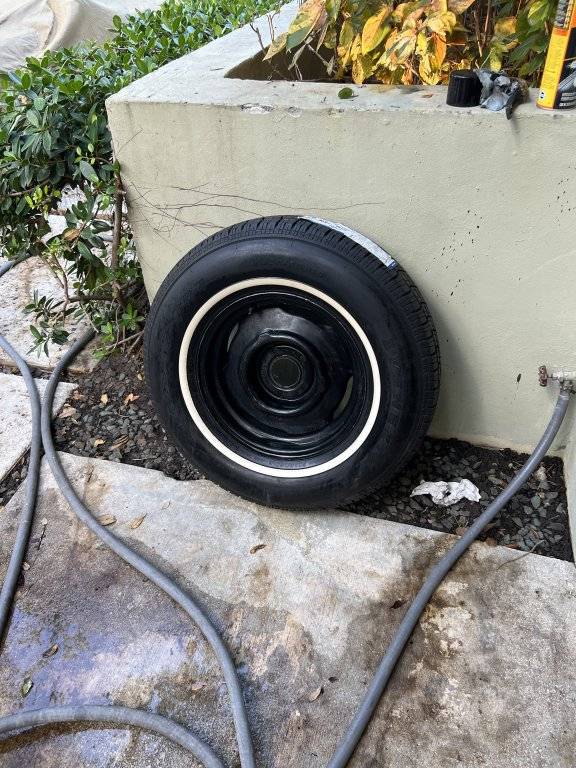

Finally…. Cleaned up a new full size spare for the old girl.

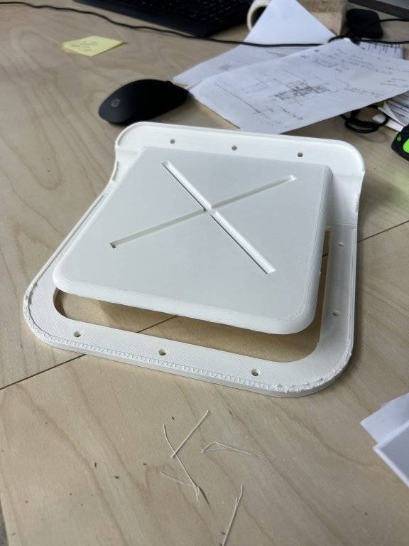

Printer failure…..close but no cigar.
Not sure if it was the printer or the file. Checked both and made some tweaks to the file.
Another 20 hours to go.

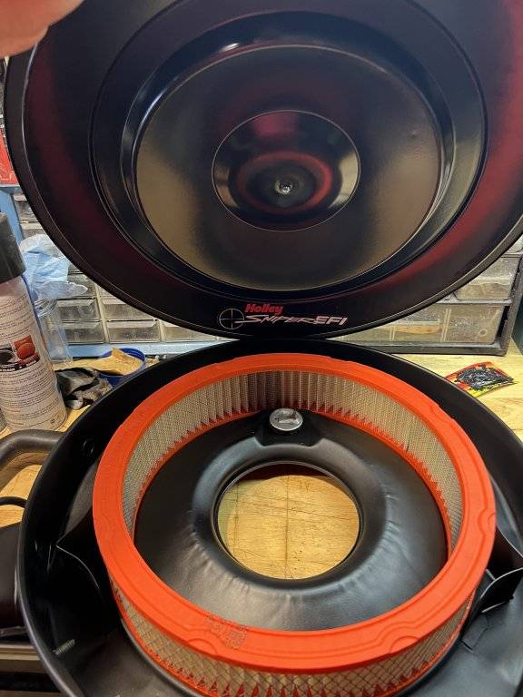

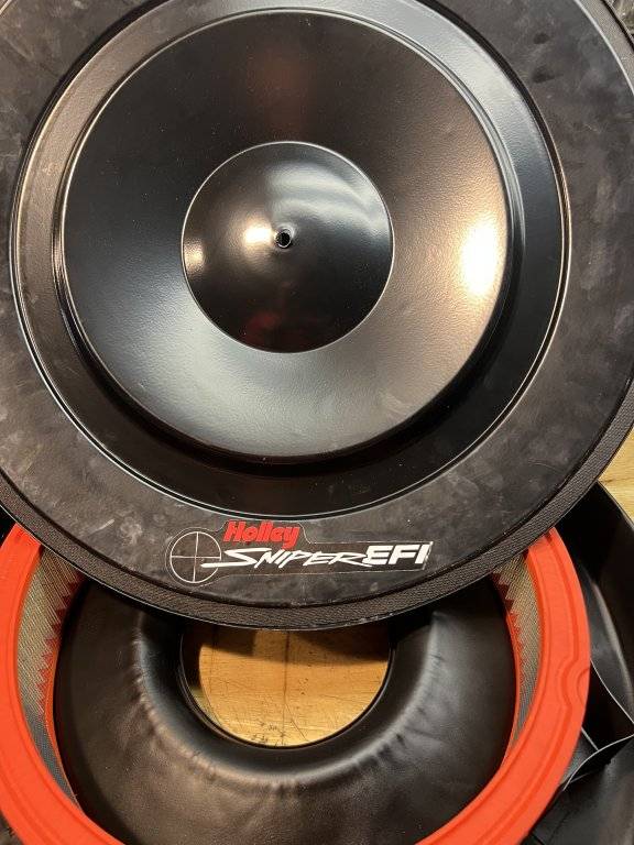

Also got some lettering for the air cleaner lid….. you knew I was going to do something there…..
J
Depending on your vision for your aircleaner lid, you could consider one of these.
I got 2 from MartyMopar awhile back for a reasonable price, and he had several more IIRC.
Lid is from whatever years of 81-83 Imperial had EFI, of course.
