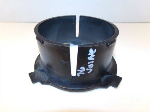

Close….. but not exactly. Waiting on one final small part to finish and reveal. It’s stuck in transit. Was supposed to arrive Saturday. Now looks to be sometime next week if ever. Just as I head out of town.This is the closest pic I could find of the yoke adapter:
Based on what you call 'clues' (and I use that term loosely!), I see reference to some sort of air cleaner hose adapter, some shallow blue scoopy-thingies, and pics of the cowl.
I am guessing some sort of 70s-Nascar-style cowl-based fresh air inlet to the air cleaner.
But the car is pretty nice, so whatever is done must be tasteful and discrete.
Mounted at the rear of the air cleaner, with the original snorkel retained as a decoy, and the size/shape of the blue things suggest baffles for in the cowl to keep leaves and mice from getting sucked in.
Am I close?

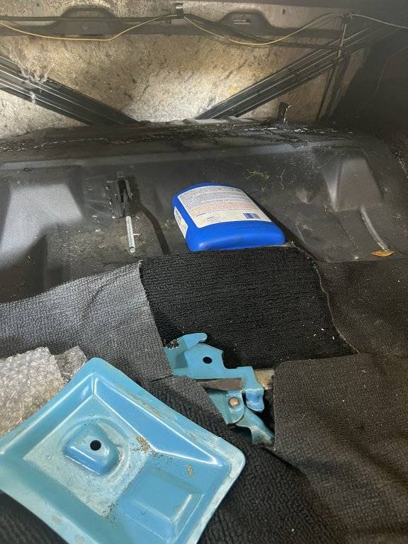

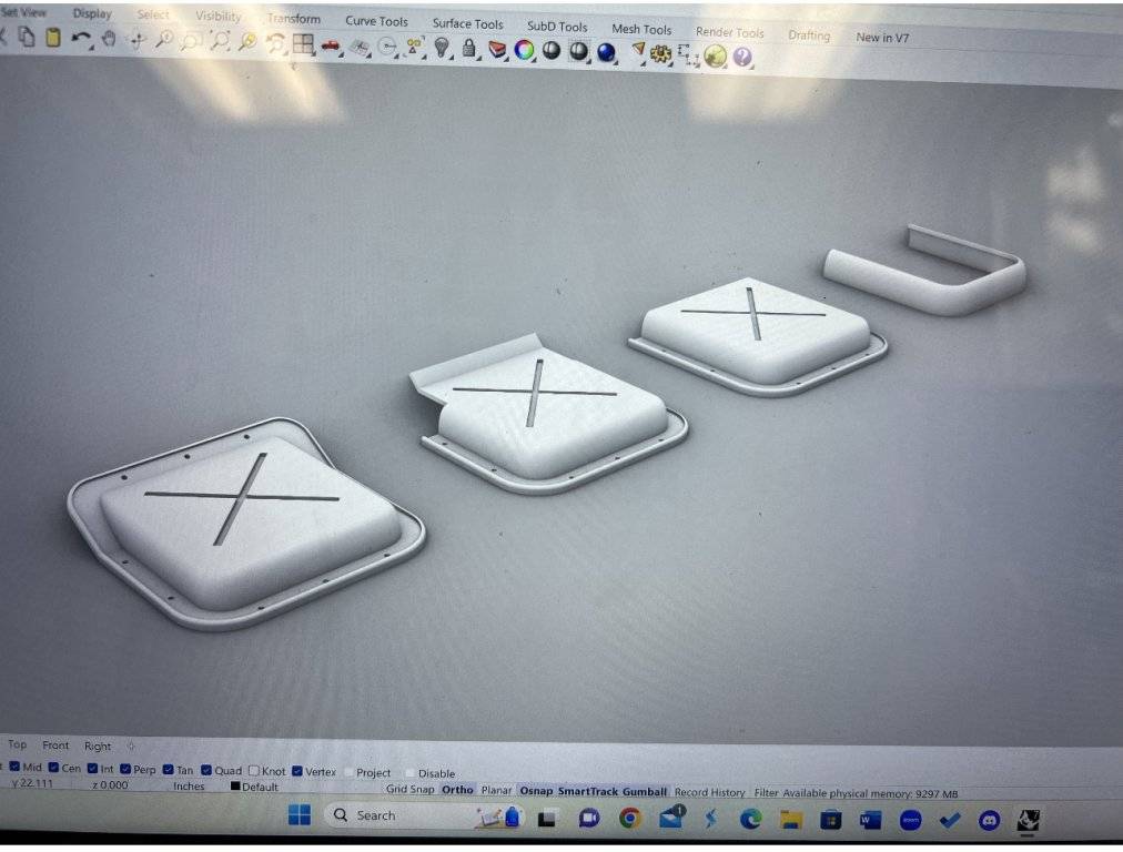

Also finished the model for the 3D print of the pump cover in the trunk….
Cool no? Can’t wait to get the print. Should take about a day to print it.

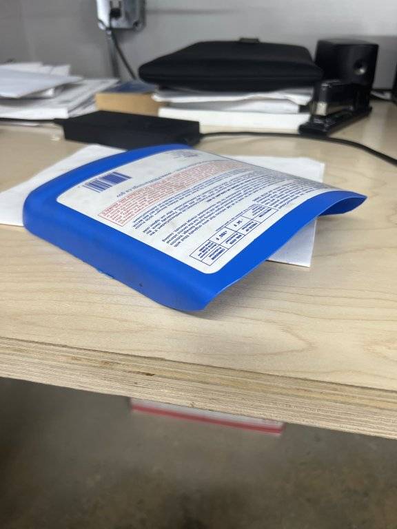

The blue thing (cut up coolant container) was just to get the profile of the edge for the flange.
This will let me close out one end of this project.
