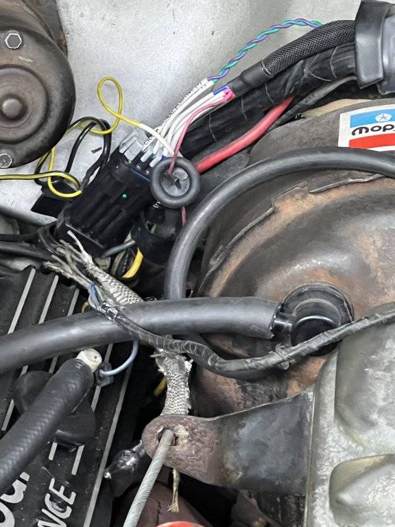

Running the Sniper control box into the car (Finally!). It will go in the glove box. Used the hole meant for the vacuum line to the e brake release canister. Rigging a mount got the unit with some Velcro to hold it and keep it from banging around…. And allow me to pull it out easily to see it.
It’s getting harder to read all those small numbers lately. Age I guess.
…. In the middle of the install, I was working alone in the shop and managed to accidentally push it off the top of the fender. It popped apart and the memory chip went flying… took me over an hour on my hands a knees to find it. Snapped it all back together and it worked fine. Had my balls in my throat until it did.
Yes.. I know….. I need to put a snap clamp
on and fully push on the vacuum line to the booster…. Lots of little details and sorting to do. More to come; like the excess coil pick up wire from the Sniper main harness.

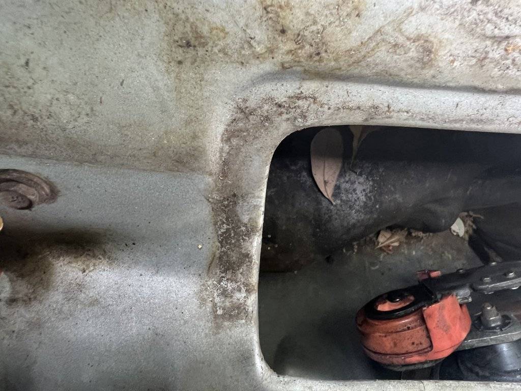

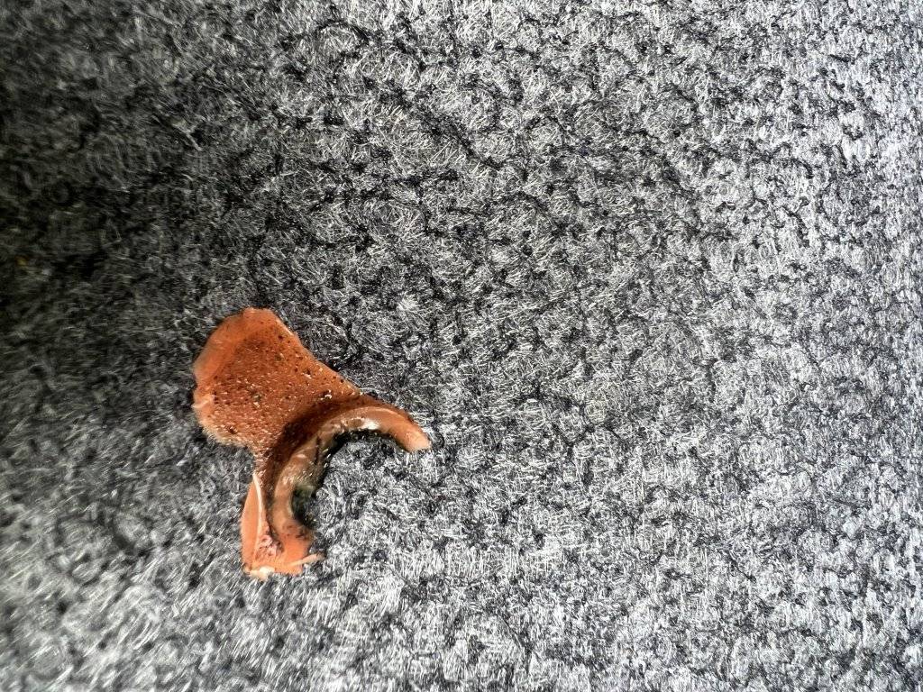

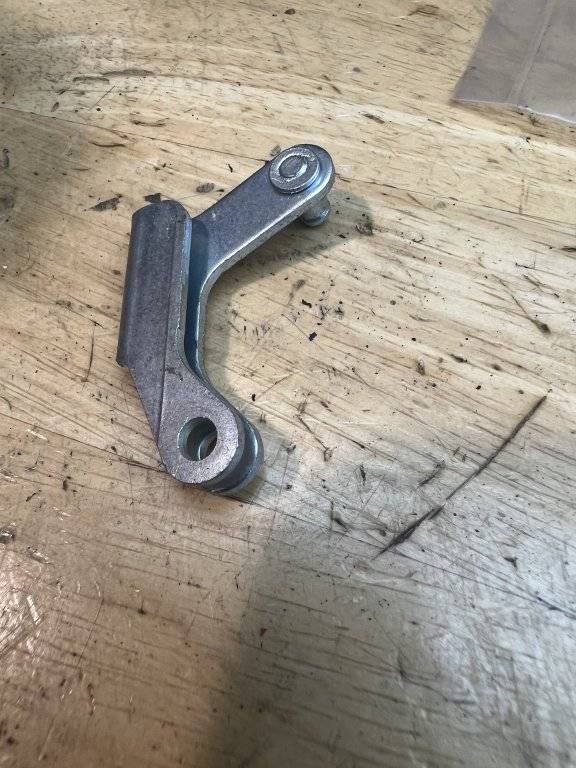

Then I installed the repaired drivers side wiper arm. Turned it on and got three excellent wipes before the clutch crapped the bed. Heard a thunk and saw that both wipers were still connected so I knew it was the power arm. But which end…..
Several screws later and a bit of vacuuming and I had my answer. Looks like it was at a bit of an angle and in tension. Five years later… it let go. Oh well…. At least I have some practice.
Top sheared off from the side in tension.
Next time I’ll bend the bar a bit to remove the tension. Won’t take much.

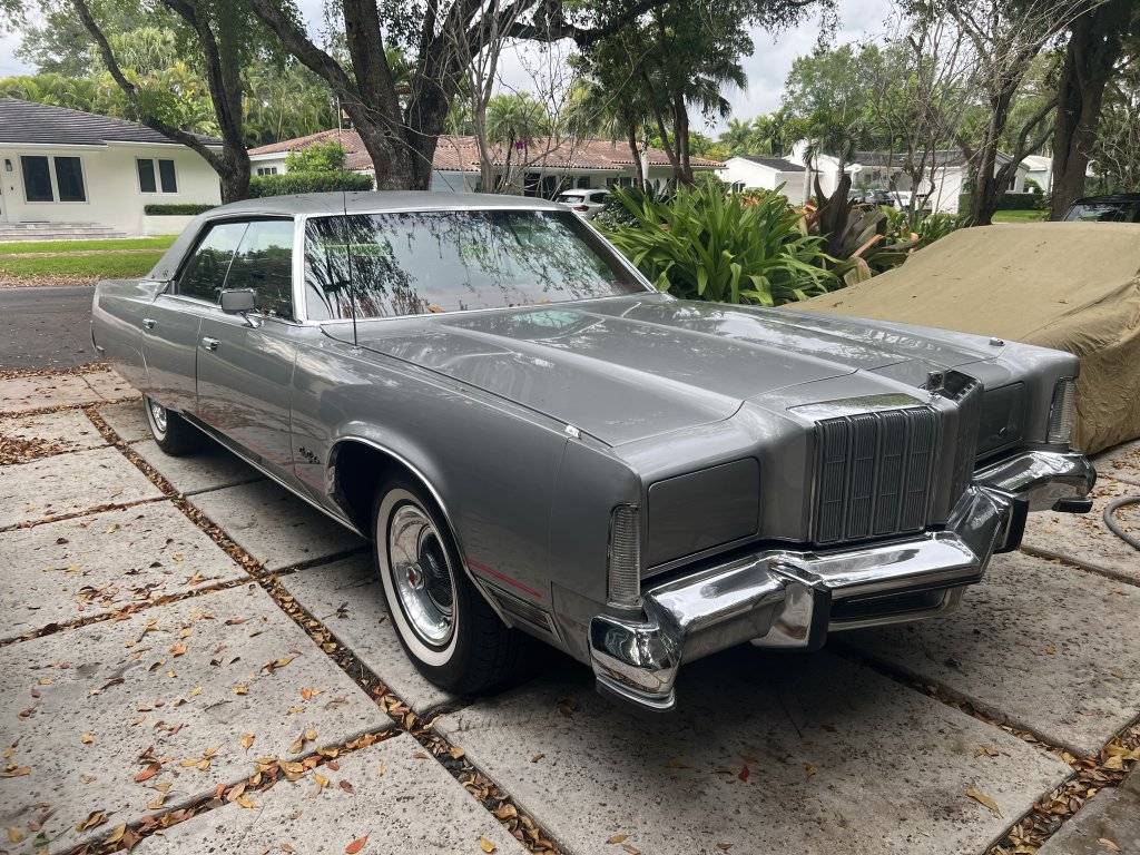

Brought her home Friday night. Gave her a good bath and polished the rims a bit. Not perfect but better.

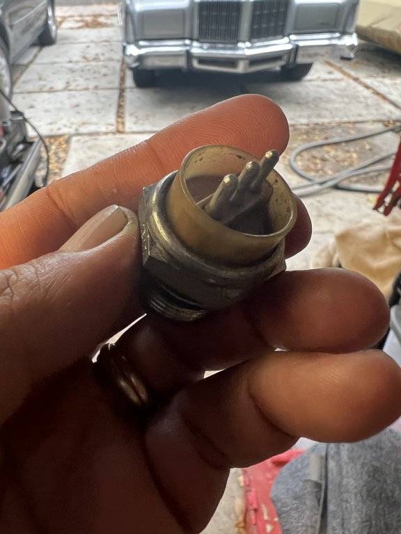

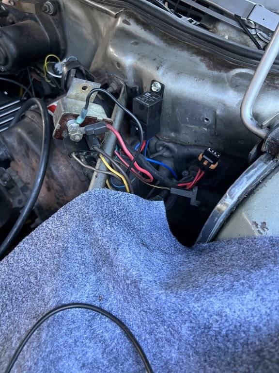

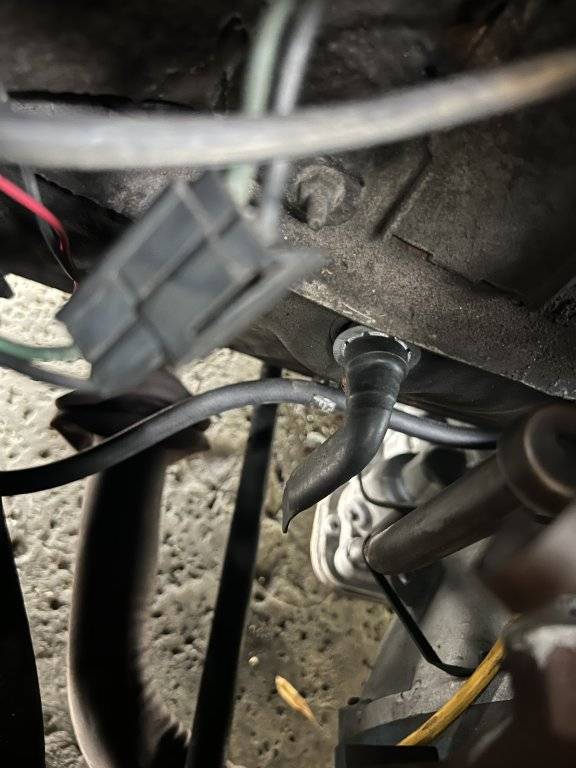

Went to the shop on the way home to check on the Sanden conversion on the roadrunner…. And went to leave and the starter would not engage. Thought I’d might be the starter relay as it is probably original. Took it apart and it checked out. Cleaned up the contacts a bit while there anyway.
Here was my problem. The neutral safety switch had popped off. No way to get it back on and I wasn’t about to use a hammer.
Looks like it’s a ‘78 thing. Luckily….
I had an NOS spare in the stash. All better now. The periferal projects continue….
