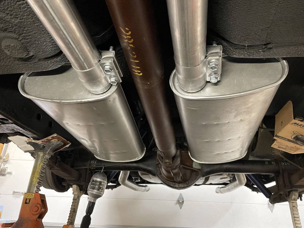

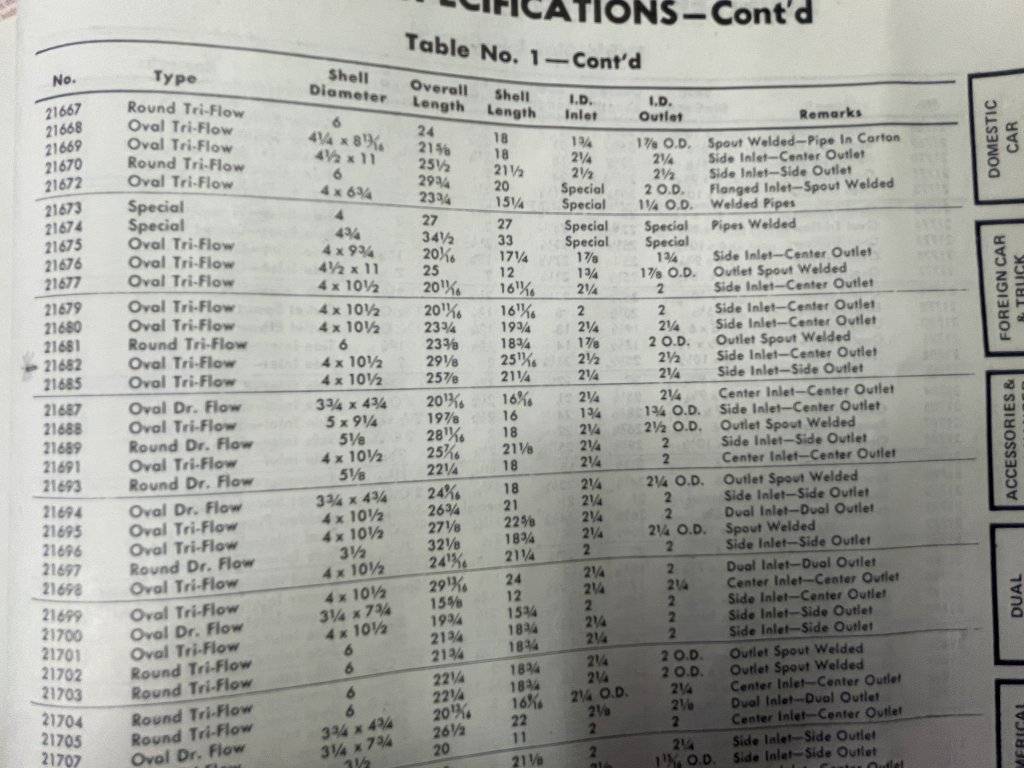

I had good results with the mufflers on my Imperial using muffler made by Motivair. # PF106. I used two of the PF106 mufflers on my TTI dual exhaust.
I found it to be the closest to the specs I found in my old MOPAR/Autopar muffler catalog.

I found it to be the closest to the specs I found in my old MOPAR/Autopar muffler catalog.View attachment 578021

I had the length problem you discribe on my Imperial. I had to cut 1.5" from muffler and 2" from tail pipe. Then I used the stainless 2.5" band clamp. Fit and is nice and quiet with flow.
As it sits right now, the front of the muffler body is close to the floor pan (at the kick up for the rear seat) and I wouldn't want it closer. At the rear of the muffler, there's really not enough straight pipe to trim back.
Bottom line is there's really no wiggle room for a longer muffler. I would think that your Imperial probably has a longer wheelbase and a little more room.
