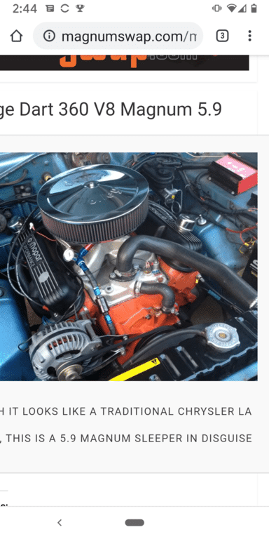

This is Spanish to me. I'd probably want to keep a time specific engine but how would I wire in a fuel pump and such to make that work?
I actually like the look of this
