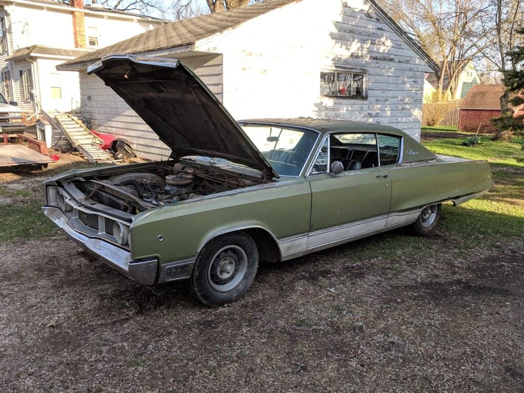

It's got some dings, but damn, I have a complete set! The car fits my scruffy standard, that's for sure. I bet it was a looker when it was new.
No Doubt. Mine's a little dinged up in places. More worrisome is sheet metal screw someone drove in through the passenger side rocker when it came loose... which I don't get anyway. It looks like a lot of the clips on mine are broken as nothing lines up quite right.... but yea, it's all there!

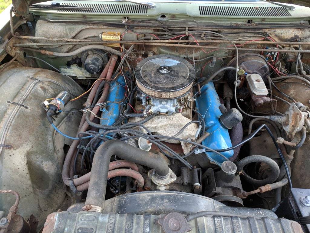

Wrong carb kit! Got one ordered, I'll see it Saturday. I'll replace one gasket that tore, and putter around til then. Got an alternator belt set aside, and a spare battery charging! Gonna drive it to work tomorrow, it only a few miles away, so why not?
Cleaned up the carb, sprayed all the passages and gave everything a good blasting.
All buttoned back up. Haven't put an alternator back in, all I had is one that is rated for much higher amps than stock.

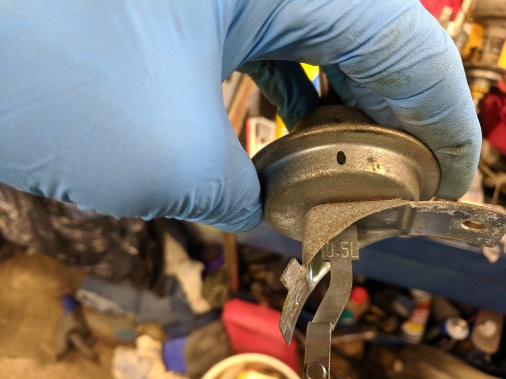

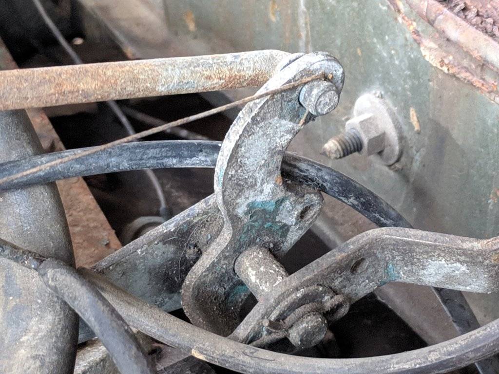

Then I noticed this, and check movement, it was stiff and sticky;
So I pulled the throttle cable off the kickdown linkage, and things moved much more smoothly. I'll take it out in the morning and see how it runs.

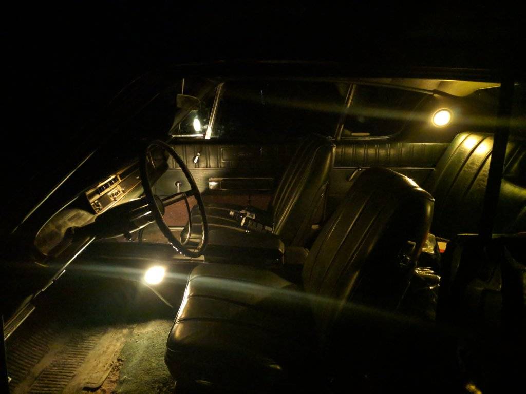

All the interior lights work.

Drove the car to work today, what a difference! The car accelerates much better, takes off and goes like it should. I'm sure it needs plugs and wires, at least looked at, but increasing the line pressure in the transmission makes it scoot! Timing to be checked tomorrow if the weather isn't too bad.

I had a fun ride in, still chuggy, but it was fun to press the gas and have the car move out nicely. Not sure how much the carb cleaning did, but at least it got cleaned a bit. And it fired up on the second attempt (fluid still used) without refilling the bowls. Nice to know my pump is strong!

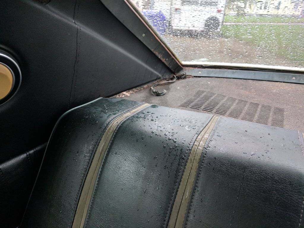

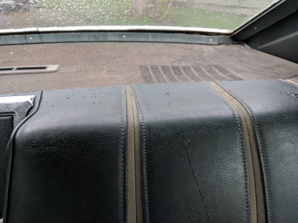

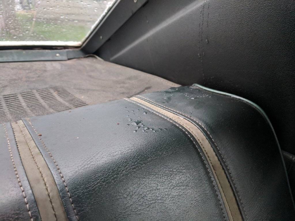

More rain, saw this when I got in the car after work.
Judging by the rust looking stuff next to the rainwater, I don't really want to take off the trim to investigate the source of the leak... But I don't want to ruin the seat, either.

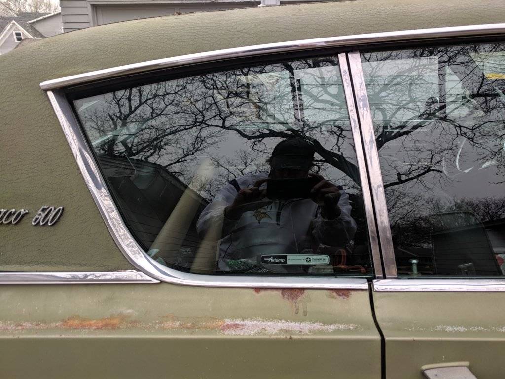

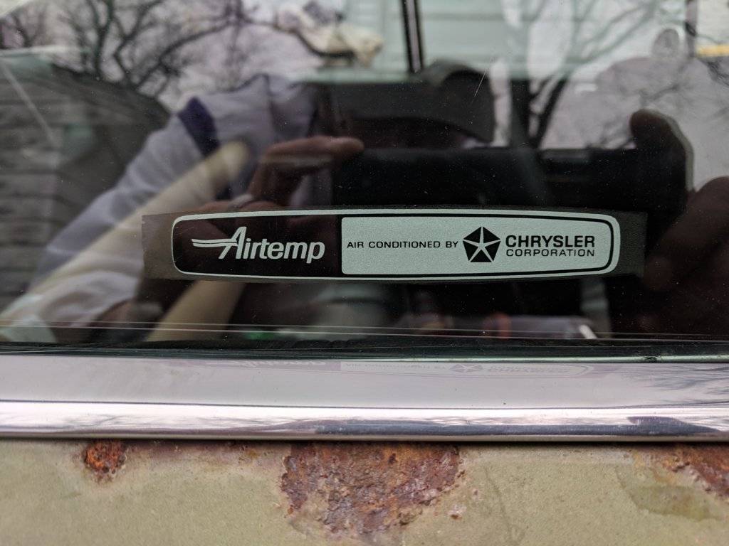

When I was walking around the car yesterday I took a glance at the Airtemp decal, it's in great shape and the nicest one I've had on my cars. I guess the car got parked at least that far into the garage it lived in for much of it's life.
Yea, I feel your pain though I’ve still not found water anywhere but the trunk... the mouse crap under the package tray maybe the absorball in my case though.
My feeling is that while opening it up to investigate may be a can o worms, the more crap you can strip away from that area, the less water can get trapped in. I plan on ripping mine open when it gets back from suspension if only for that reason... well, that and to change the mouse poo.

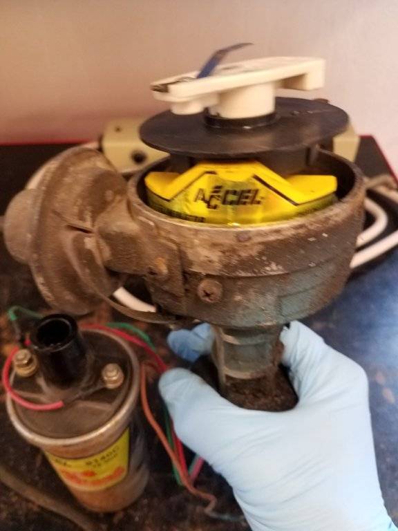

I made the mistake of screwing with the timing, and now it runs even worse! But I shouldn't have touched it to begin with as the carb hasn't been squared away yet. Got the correct kit for it, will go through it today or tomorrow. A shot of my Pertronix(?) in the distributor.

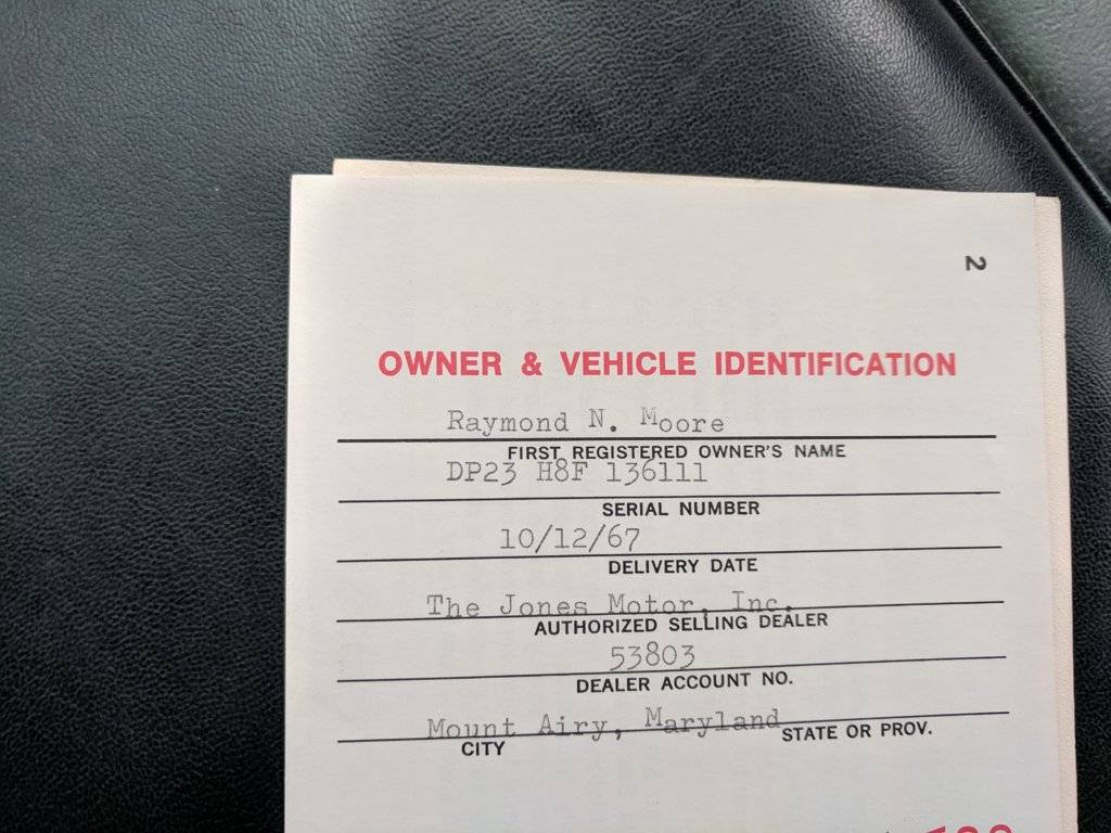

So I moved on to checking the bulbs that aren't working. I grabbed the owners 's manual to find out what bulbs I'd need, and discovered I have the original owners manual. Pretty neat to have that ride along with the car it's entire life. And it's mint, I thought it was a reproduction. Even has the original owners name, and the selling dealers name. The Jones Motor Inc, which is still in business today. I got the information I didn't think I'd get for the car (FCA/Chrysler Historical only goes through '67 if I'm not mistaken) and I had it all along. I just glanced at the manual, said "cool", and put it back in the car's folder. Gotta check paperwork! :BangHead:

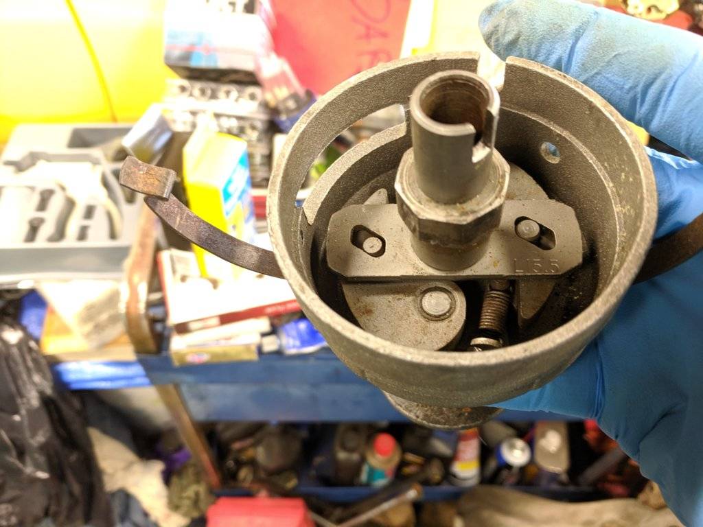

Well, I did a little dinking around in the car today, went through the distributor, trying to find something wrong with it, and I couldn't. But I took.it apart and made myself familiar with it,and the Accel XR700 ignition system (now Fireball in name). The vacuum canister worked when I sucked on the hose, I thought I was getting full advance at idle, but now I'm confused. I'll check the timing,and will probably end up putting a spare Edelbrock carburetor on, but I'll try to get the Holley running first. Time to go do some quick reading, and get back to it, so I can take this to the show Friday. New tires should be at the shop waiting for me.
Also put an o ring on the distributor, as it didn't have one, but it does have a gasket for the hole you drop it in! Engine has original soot and grime inside, I left it for posterity.

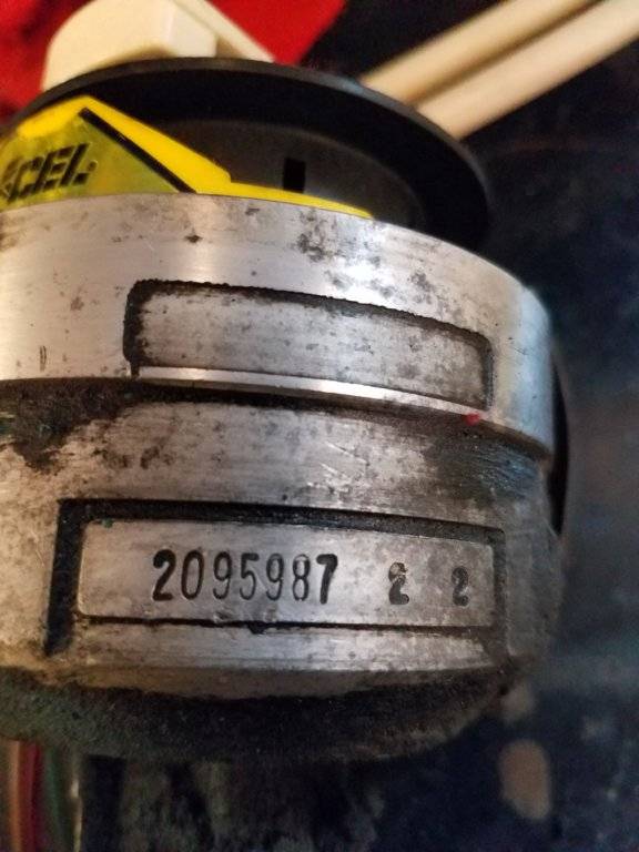

Scott, I took this distributor and coil out of my 300's 413. I'm not real familiar with these. Accel electronic conversion, I think. This is the distributor number too. Any thoughts?
It's definitely Accel, maybe a newer version, the pickup wheel has vertical slots vs mine with the horizontal slots. Did it work? Mine works, just not sure what's the issue in my car, and need to sort out the carburetor also.

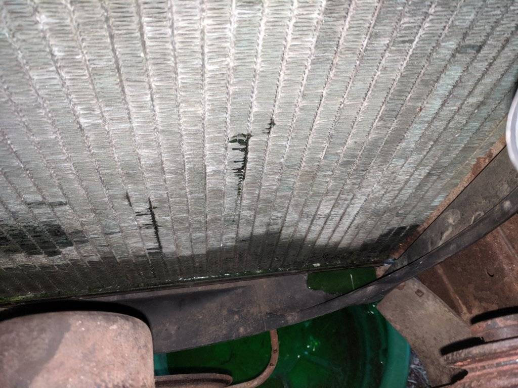

So I got kicked in the nuts by the car.
I'll have to see if my Chinese aluminum radiator will bolt in. I also have to dig through my pulleys to find a dual groove to use so I have an alternator that works. The single groove pulley I have rubs the power steering pump belt. Nothing like seeing how close I can cut it.
Yes, it ran fine with the Accel set up. It's for sale if anyone interested.
Welcome to my world. My fuel leak is the sending unit where the tube comes through the faceplate. I dropped a fuel tank out of the parts car that ran most recently and it was way uglier than I expected - no where near usable. So we'll show up in the Longhorn so I can pick up a new tank/sending unit.
Same thing happened to me when I did my timing chain. Rad was fine when it came out .. handled it real gingerly .. leaked like a sieve when I filled it back up.
I don't even think I touched it! I opened the cap to see how the level was, LOW! I heard dripping later, and looked down to see the above view. Laura asked me what I was going to do. "Grab a spare I have. Good thing for hoarding parts." She rolled her eyes and muttered something under her breath.
