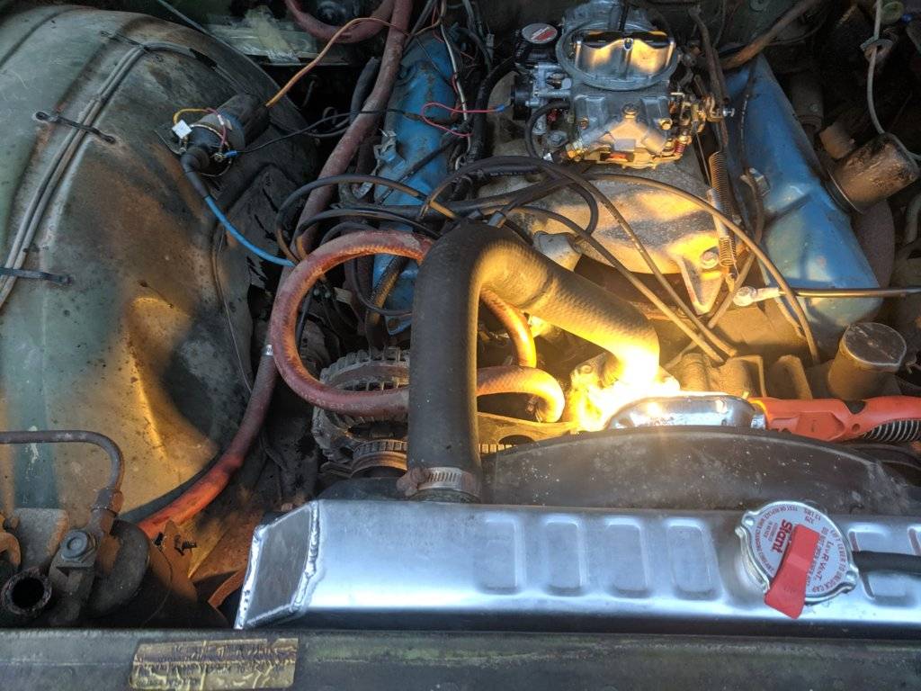

I don't even think I touched it! I opened the cap to see how the level was, LOW! I heard dripping later, and looked down to see the above view. Laura asked me what I was going to do. "Grab a spare I have. Good thing for hoarding parts." She rolled her eyes and muttered something under her breath.
Must be a phenomenon of some kind. Did a cam/timing gear upgrade in the '62 Polara, put it all together and the radiator was leaking. The worst part? Now so is the rear main. So it sets until next winter as I build a 413 for. The 383 is going to go in my grandsons truck.....
I got it together,and now I don't know if the thermostat is opening. Still have the same amount of coolant in the radiator, but it did seem to be moving around, got that slightly cloudy look after about ten minutes, but I haven't added any, and I only put two gallons in. FSM says it takes 16-17 quarts, and I'm only half way. I need to get tires in the morning, and I'll have my mechanic look at it, as it also needs some tweaking to the carb (still) and the timing. I tried for maximum vacuum, and had to turn the timing back to normal, as it was too far advanced and sounded like crap when I tried to accelerate. Should never have touched the timing, but I should be able to get it better than it is. Has a sweet spot I lost, and cannot find. It is being the most troublesome car to sort out that I have dealt with.
You would still have a bunch of coolant in the block even after removing the radiator. Removing the radiator hoses just basically drains it down from the heads. To get it all out you almost have to remove a soft plug. When I had to pull my head I only got about 2 gallons out of the radiator drain.
The coolant moving across the top of the radiator was good to see, guess I'm used to an empty block. And yeah, usually the water pump gets taken off, so that would explain the amount of coolant I put in. Oh well, I have two gallons mixed up if I need it.

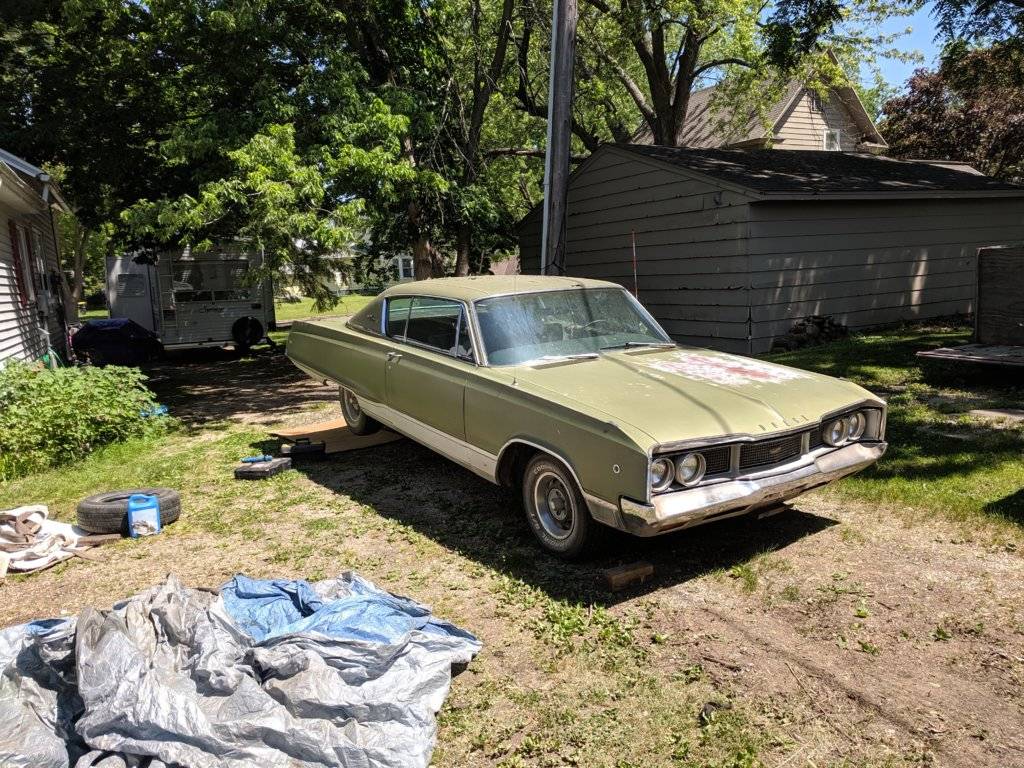

Saturday I tried to make it to the car show, but the car had other plans. It was popping and chugging along, but the gas gauge was dropping to quickly. It went from half (full, as I had just filled up before leaving) to quarter tank only 35-40 miles into my trip. I stopped at a gas station and saw fuel leaking out at a pretty fast rate from the sending unit. Replacement lock ring. So I turned back and headed home. I drove a little bit more to empty the tank some, so I logged 100 miles. I did make it to the car show later that day, and it all turned out fine.
Tonight, Sunday, I wanted to get a little more fuel out of the tank so I went to a friend's house about fifteen miles away. He and another friend wanted to check out the car, so we opened the hood. My friend pointed out my heater hoses were on the exhaust manifold. Good eye! Then he started looking at every wire and hose to make sure they weren't going to get caught on a sharp edge. In doing so, he moved the heater hoses more than I had before, and one started leaking at the nipple for the heater hose. Ok, no big deal as I was planning on replacing them. I looped a hose to both nipples on the water pump to make it home.
While I was showing him the car, I grabbed the air cleaner and set it on the carb. I didn't think it would fit, but it does, so I'll be getting a new element for it and putting it on.

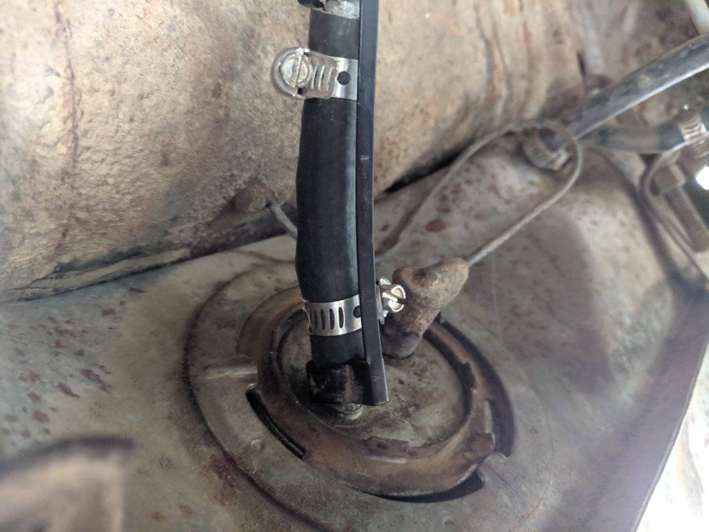

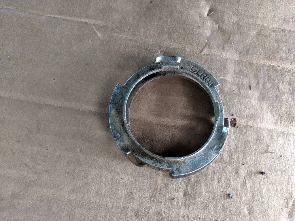

After attempting to go to a car show, and finding out the new lock ring was doing what it does, leak, I grabbed an old one off my '66 Polara parts car, along with some goodies for my '66 Polara 500.
The new one isn't the same it has shorter flanges, it looks like the tabs are in the right place, but it's a little thinner and doesn't "bump" up enough. Don't use GLR03.
The old one came out after one (1) tap with a screwdriver, and then fingers were all I needed.
Installed the old one, hooked up my fuel line, ground strap, and the gauge wire.
Didn't line up the ring the best, so I put that on the list for the next day.

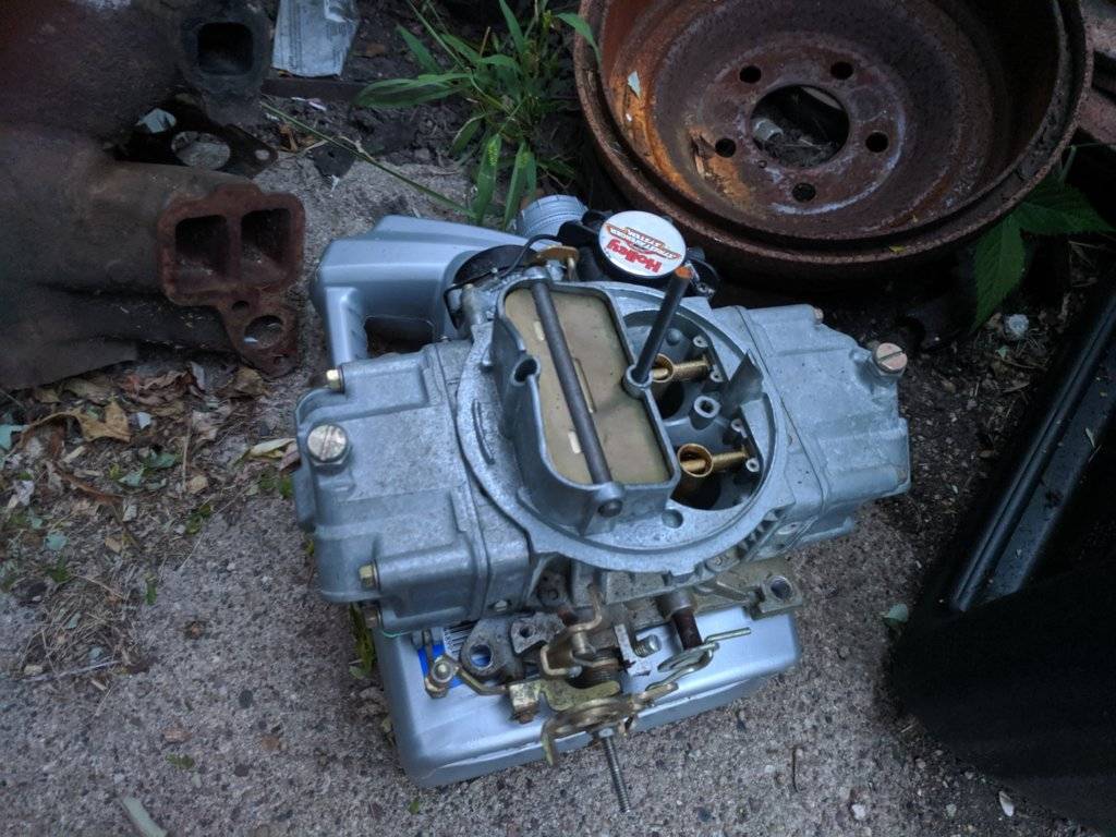

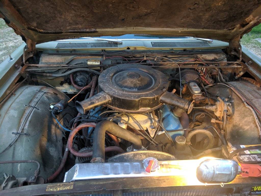

So this car has been sitting in front of the garage, and I haven't done anything to it. I decided to swap carbs just to get it on the road. I had zero hope that it would work. The car had been smoking when running since the carb rebuild, and it wasn't anywhere near correct. Maybe my buddy was in a rush to get out of town, I don't think he'd do a half *** job on purpose, he's not that guy. Whatever, it doesn't matter to me, as I know he will go over that carb and make sure it's right in the end.
So I took the Holley off.

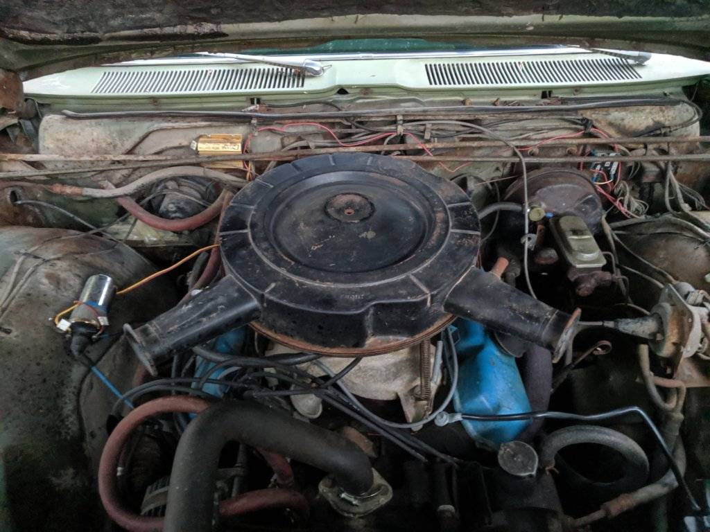

And put on an Edelbrock 1407 750 AFB I had picked up some years back. Had a good layer of carbon-ish black on it, and a little residue inside. Sprayed it with carb cleaner and wiped off the deposits as best I could. Simple as it gets. Put on a clear plastic filter and some new fuel hose, and slapped the linkage on.
Took it out after not really tuning it. Started right up, so I went out for a spin. After thinking I could kill all the mosquitoes in town, I pulled over and opened the hood. I had smoke coming out from under the hood, I figured it was coming from the breather (hose cut that should go to air cleaner). I shut the hood and turned for home. I said "screw it" and kept it heading out of town. It went well under part throttle, then stumbled a few times before cleaning out and hitting it hard. I left town 20 over, and hit a nice sweeping curve at 70, then kept into it for the next mile or so until I approached a sharp turn with a gravel approach on either entrance.
I turned around and headed back to town, I didn't know how much fuel I had left, and the car was getting a little hot, with the way it was set. Burnouts would have to wait, but I wanted to.

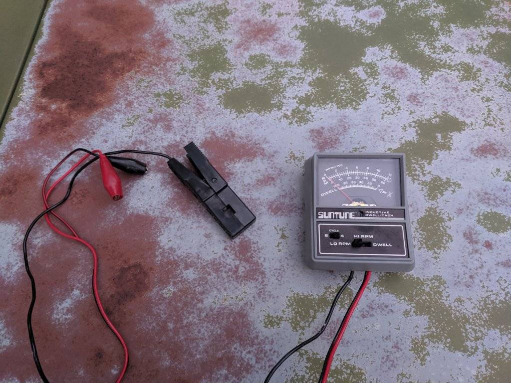

Got back home and hooked up the SunTune my dad had given me years ago, finally put it to use.
Tuned the carb and put on the factory dual snorkel air cleaner, with new Wix filter 42043, which Parts City (O'Reilly's independent, same part numbers) lists for a '68 Dart with a 383.

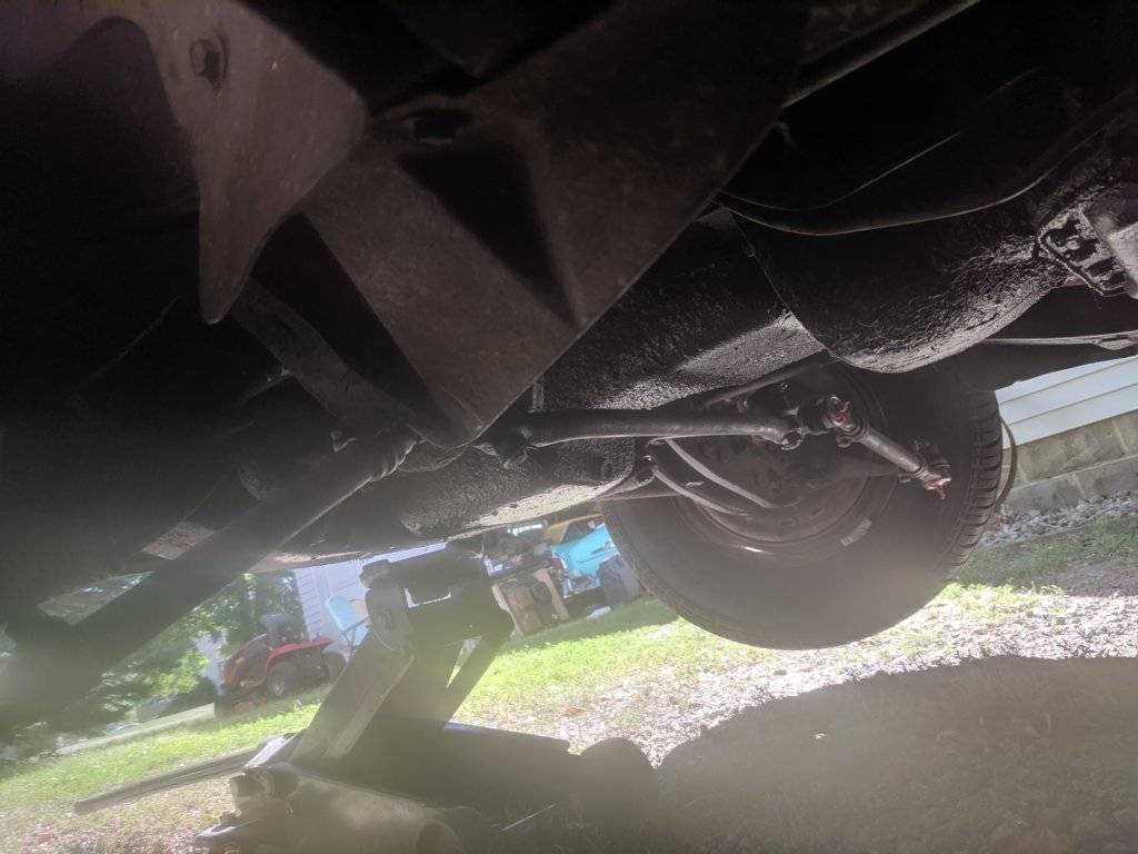

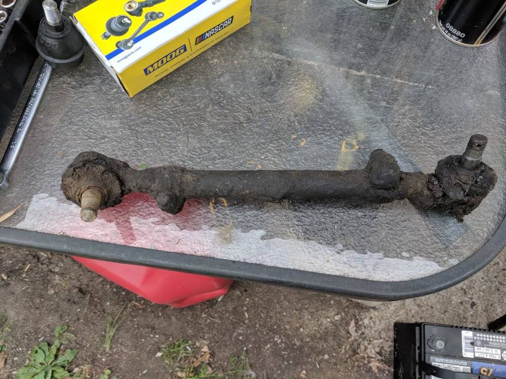

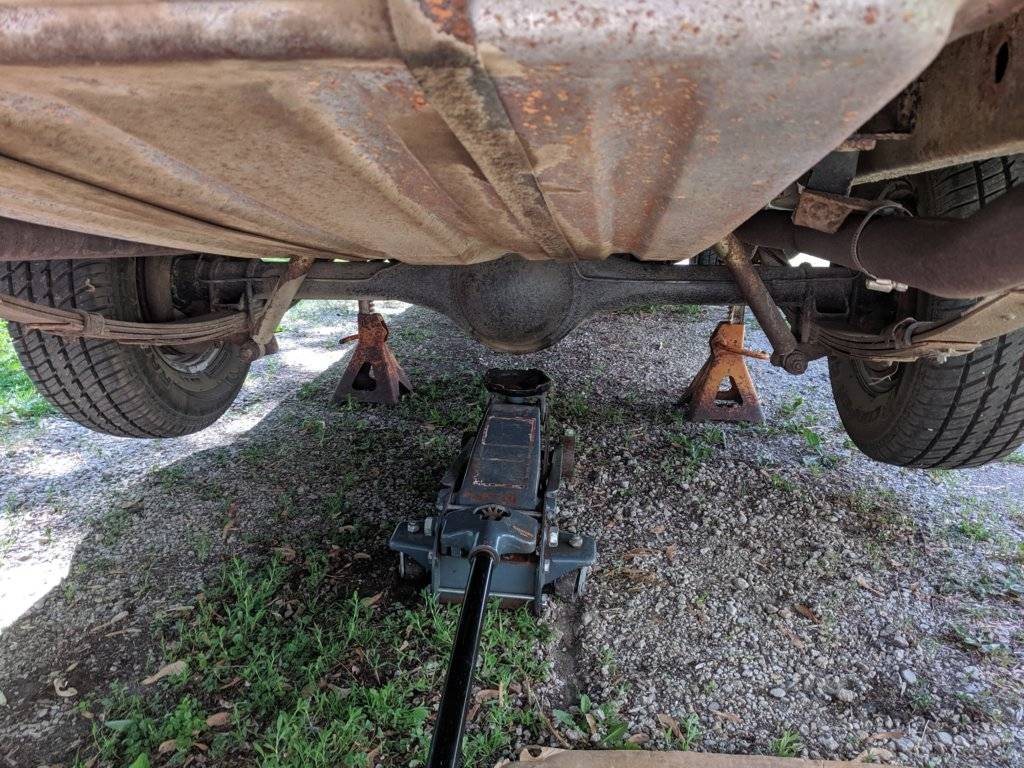

Pulled into the driveway last night I felt and heard a klunk in the front end. I had also experienced some slight steering differences earlier in the day. Time to install the tie rods I bought a month or two ago. They came in a Moog box, which I ordered. Even got a magnet. Took off the drivers side after wasting half of my available time. Pretty grimey.
Took a rusty blade I had and a wire brush to the sleeve.
Good enough for this guy. Slapped it back in, emptied all three grease guns I had (nice of me to leave them empty!) and realized I was late for work. I'll install the passenger side tomorrow.
Are you going to send it out for a alignment or just use a measuring tape to get the toe in close?
I'll get it aligned, I tried to put the new tie rods back to the same spot they were in, should be fairly close.
Got my idler arm and tie rods installed that with the help of the granddaughters, they asked a lot of questions about my tools and what all the parts were. (I'm still hoping I can get one to drive my Dart at a dragstrip when they are old enough.)
Back together.
Wiped off the excess grease, dropped it back down and check the tires, looks pretty close, I'll find out on Friday when I have it aligned before I set out for the Cars at the Lake (CATL) cruise over in Illinois/Wisconsin. Not bad for a first adventure with the car.
