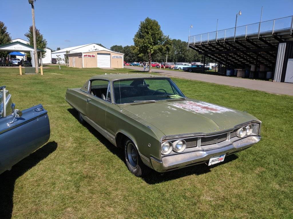

I went to said car show today, it was a beautiful day for a drive.

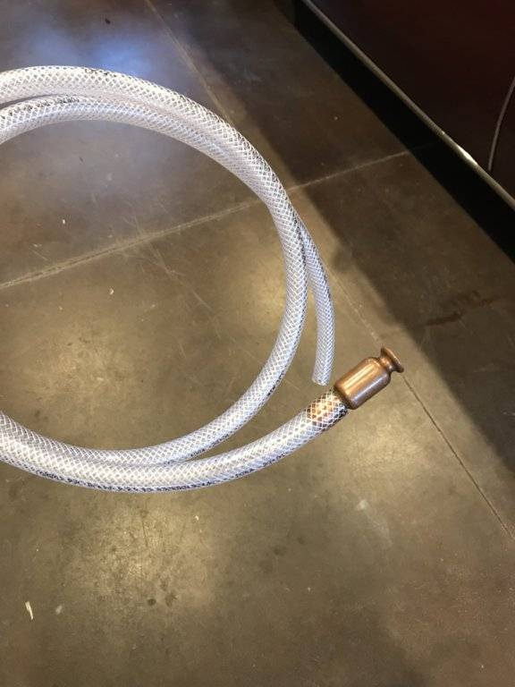

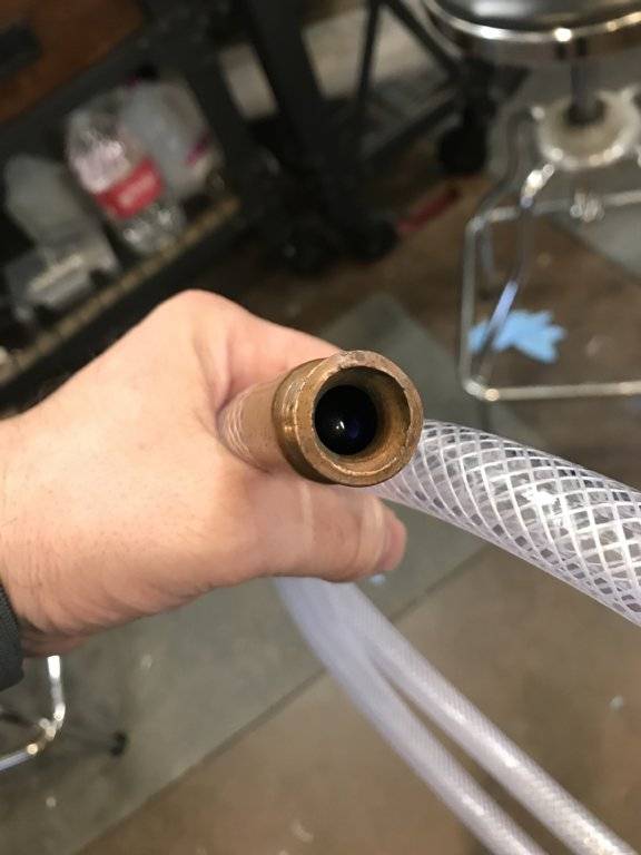

Best way to fill and drain these low fuel fills is a Super Siphon.
My room mate back in the early’90’s was selling these for a while. He sold all kinds of weird crap at trade shows.
This was one of the better ideas.
I see these in some hardware stores now.
It is basically a necked down copper pipe with a marble to act as a check valve, and a hose.
Set the gas can in the trunk, put the copper end in the jug, hose in tank, shake the hose about 10 times. Once the siphon is going it doesn’t take long to empty.
View attachment 367583 View attachment 367584
I have a funnel with some hose attached to it I usually use, but I never took it out of the trunk of the Polara last year, when I thought I ran out of fuel. It stays put with the license plate keeping pressure against it.

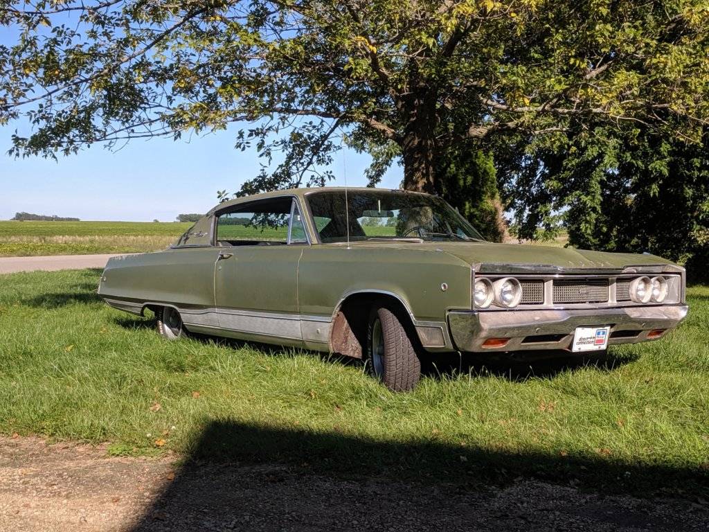

Picture from the drive to storage last year.
