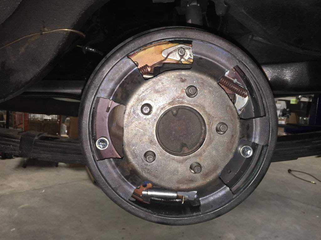

Update: Brand new rear Timkin bearings...I needed it as they were bad and the car coasts & gildes much nicer now. It took out the wobble motion. Axle not bent. Brakes still hot.

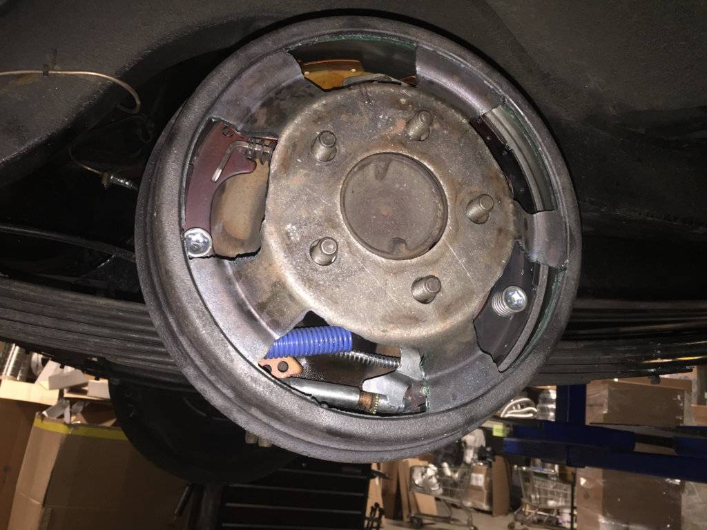

My buddy made windows so we can see how they are reacting. (see pics). Seems like they just keep getting stuck without reason.. Did hydraulic test-again, not that. Removed ebrake completely-again, not that.
We are starting to think about the integrity and accuracy of the aftermarket shoes & drum. Centric 11x2 drum, Raybestos shoe 11x2. I can't find Wagner 334R on line anywhere for 11x2. No other manufacturer I can see makes drums other than Centric.
We here in VT are all stumped!

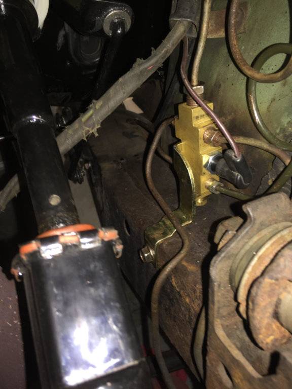

I’ve been away for two weeks so no chance to work on it. I’m proceeding with the hydraulic issue first and have ordered lines from the flex back. The flex itself looks rough so I’ll feel better having new lines. I will report back once that’s complete.

From your pics, I would replace that rubber hose. It was inexpensive and easy to change...The Dorman seems good. The distribution block for your 300 may have been used on different vehicles and some of these stores aren't aware, so they are not on their compatibility list. My CBody 67 Polara has an identical block to a B body car (Coronet/Belvidere), but the ONLY difference was in the mounting bracket. I bought the "BBody" block, tapped off the bracket of my old and the new and attached the new block to my old bracket. (See Pics).
To see if your block crosses with other models, download your car's parts manual: MyMopar - Mopar Forums & Information - Parts & Accessories Books

do you have a better picture of the shoes against your windowed drum? in the pictures above the arc of the shoes doesn't look right.
