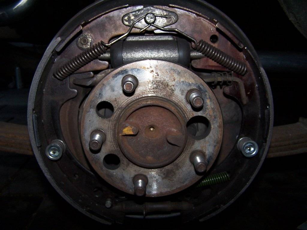

looks like the one shoe is a lot thinner than the other. that one must be dragging possibly your cause of heat build up. I would look in that area. just a thought.
Shoes are brand new on both sides..

I just looked at your pictures again...
rr-brake-used-jpg.83444
In my mind that self adjuster seems wound out a pretty long distance for a bunch of new parts. I would call this a guess at best, but the circle the brake shoes make may be too far out of round and be related to your issues.
I would first, make sure the drums are the correct size and in wear tolerance. We have all had a wrong part or a poorly made substitution bite us before.
Second, I would look very closely at wear the shoes are showing contact marks... if you've had them smoking they should be a bit glazed where they touch. The primary would normally contact top and a bit towards center... if it shows anything at the bottom, I may be on to something. The secondary should show at the bottom either way, so don't look too hard there.
My thought are that MAYBE the bottom of the primary is dragging enough to generate enough heat/expansion to start to "self activate" as you drive. Another diagnostic test would be to drive until hot, jack the rear wheels in neutral and see how much drag there is when hot... something I would have expected the shop you took it to would have done.
If I'm correct... I'm a genius... If not... it's just a guess:)
are the slots in the spreader bar binding? from your picture it looks like it might be dragging on the left side. your adjuster looks pretty crusty. it wouldn't hurt to take it apart , wire wheel the threads and put it back together with some never seize. it shouldn't be out that far with new shoes as was said above. the right shoe looks like it's half worn. any i have changed have the same thickness primary and secondary. you should install the adjuster cable too. it all works together as a team.
Everything and I say éverything is taken apart, cleaned, fresh grease on it etc etc...There was absolutely no rust or other dirt on all the parts..
And for the thickness of the shoes: on all the pics I've found from different suppliers, the primary shoe is thinner...So I suppose is has to be that way.
