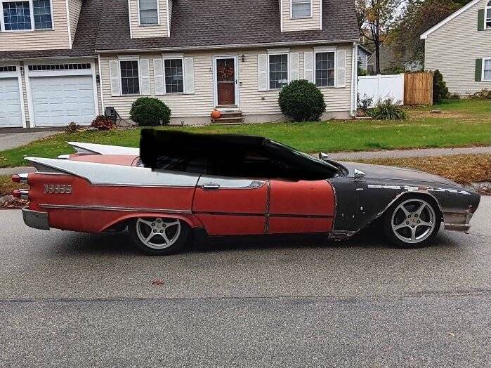

Ok guys, I'd like a quick, dirty and cheap method to simulate the steel roof panel for mockup, slice and dice. Any ideas other than fiberglass?
Cardboard and duct tape is my go-to mock-up material.
I made a mock up front panel for a piece of equipment we were developing and used cardboard. I taped a full scale plot of the front panel to it and had a technician wire up the interior harnesses while we waited for the machined front panel.
Typically I use CAD (Cardboard Aided Design) but I think getting those curves at the rear corners is beyond my artsy skills. I buddy suggested tin foil... I might give that a try...
A couple random thoughts... I've seen stuff like that shaped using insulation foam sheets laminated together and carved with an electric carving knife. That might not work where you are trying to get an internal/external template. Also seen foam core board for mock-ups too.

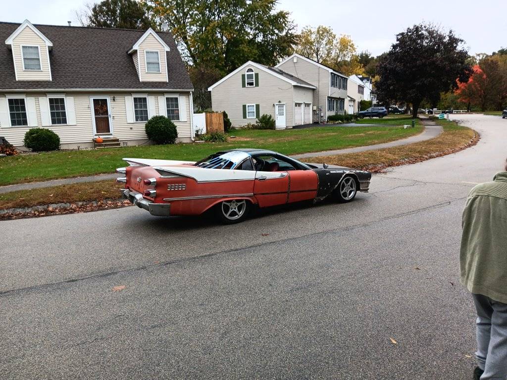

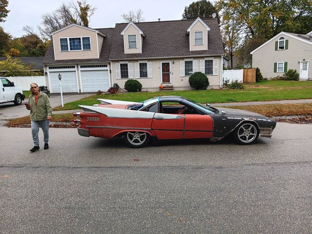

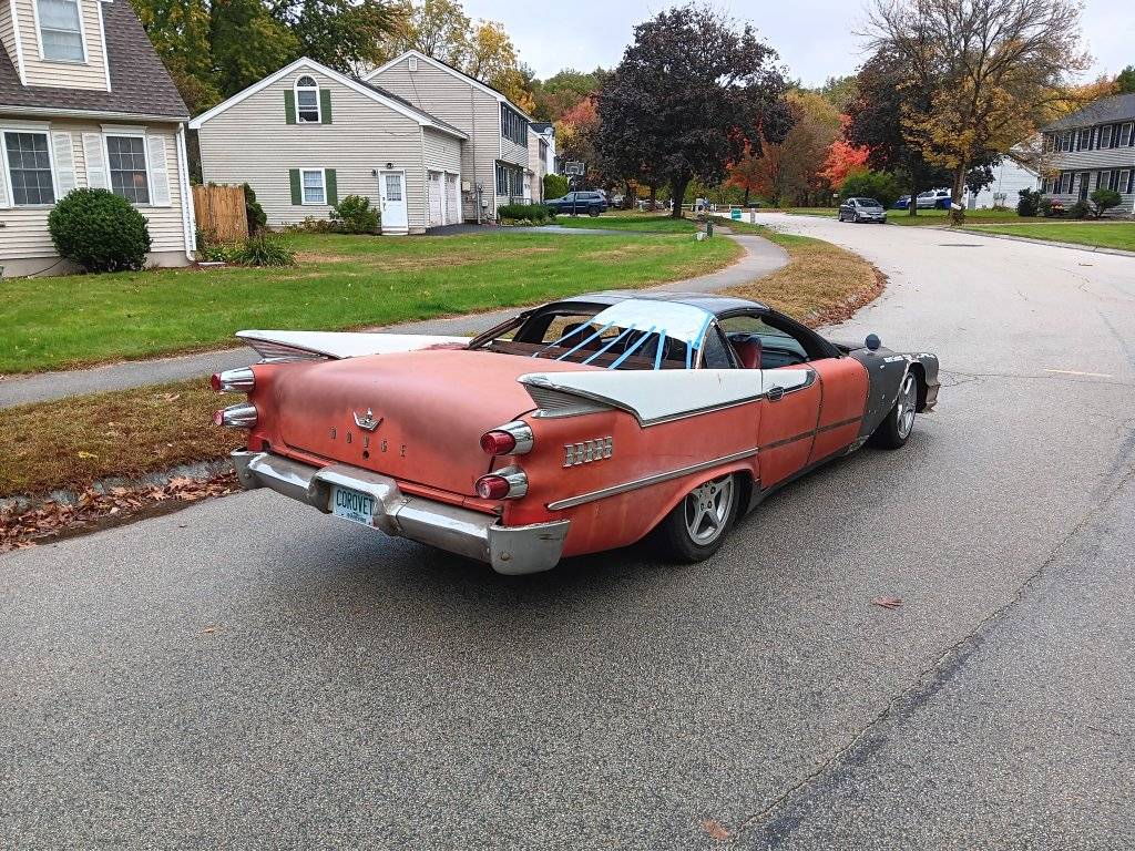

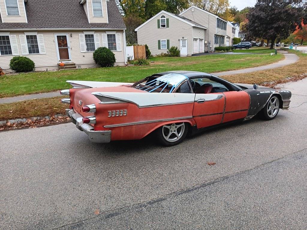

I didn't say WOW, but I didn't say uhgg either... Wife said wow... Not sure what doesn't blow me away... But I think this mockup might stay... Tinfoil is the roof, blue tape is the rear glass...
I don't know. It just looks to me that it needs a couple inches more glass and less roof from the rear view maybe? Side view, pic 5, looks good, though.
Perhaps more of an arc on the top of the window?
I was kind of thinking the same thing. More glass.. I'll try moving the top edge of the glass opening up today. I'm afraid I'll quickly run into the 59 roofline going back up where the 1998 roofline is headed down.
I agree that the side view lines are pretty good, the curve is fairly constant from Corvette to Coronet. I think the thing that irritates me the most is the overall dimension. It feels like the proportion of the entire roof to the car isn't right and the roof should be longer. I don't think it looks like "a pimple" but I do think the car could certainly support a longer roofline. I don't see a way to accomplish that on the current path cuz moving the 59 roof panel further back won't do good things for the overall roofline. It will have a dip in the middle if I want any backglass at all.
After re-reading my ramblings, I think the root problem might be that I'm not using the 1959 Coronet windshield. That would give a longer roof and an entirely different roofline feel. However, that's not happening on this one as I'm mostly happy with the design as is and I'm not looking for another 11 year project.
The other thing I will try is removing the targa top. The car will typically not have the targa top on so I might as well see if I like that view also...
The good news is that all this mocking up makes me think I can cut the roof panel fairly simply to get it to fit.
