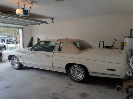

I think I mentioned an early 60s Imperial stainless targa band to hide the seam. I hadn't thought about it disguising the bump. That's brilliant.. Can someone ID the car above?

Wouldn't even necessarily have to be stainless, even a body color band might do.
